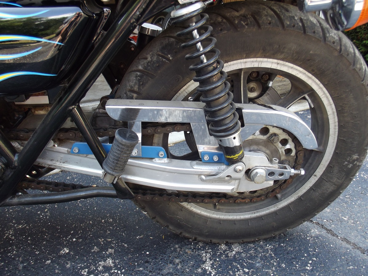

So is the shock I have the stock KZ1000 LTD one ? They seem pretty stiff and the adjusters are reluctant to turn although with just the hole in the collar there isn't much to get hold of.

Those look like food shocks. You might try some channel locks with leather to adjust then. Spanner wrenches are a PITA.

14 Dec 2015 15:23 - 14 Dec 2015 15:24swest wrote: Those look like food shocks. You might try some channel locks with leather to adjust then. Spanner wrenches are a PITA.
"Food" shocks?

I meant good shocks. This new HP lap top wants to learn how to fly.

14 Dec 2015 15:30Those look like Mullholland brand shocks. They were made by somebody bigger and marketed for motorcycles. (Boge maybe?) I have a pair also for my KZ1000...they are supposed to be decent. I have not yet ridden the bike.redhawk4 wrote: So is the shock I have the stock KZ1000 LTD one ? They seem pretty stiff and the adjusters are reluctant to turn although with just the hole in the collar there isn't much to get hold of.

I know they are not the originals since being a KZ1000A2 they would have been chrome, but I've been unable to find any identification marks that are obvious, at least without removing them. They look like the ones I've seen on LTD's but I'm 230lbs and even on the lowest spring setting they seem pretty hard. They are also a little shorter more like 12.75", I'd like to go a little longer to raise the rear a little, perhaps if I make a bigger effort to turn the adjusters this would help, but then they'd be harder still, but that may be OK. I just figured they must be old and therefore past their prime.

15 Dec 2015 05:48 - 15 Dec 2015 05:49seanbarney41 wrote:Those look like Mullholland brand shocks. They were made by somebody bigger and marketed for motorcycles. (Boge maybe?) I have a pair also for my KZ1000...they are supposed to be decent. I have not yet ridden the bike.redhawk4 wrote: So is the shock I have the stock KZ1000 LTD one ? They seem pretty stiff and the adjusters are reluctant to turn although with just the hole in the collar there isn't much to get hold of.
Attachment shock.jpg not found
These are the Mulholland's on my 900 LTD
