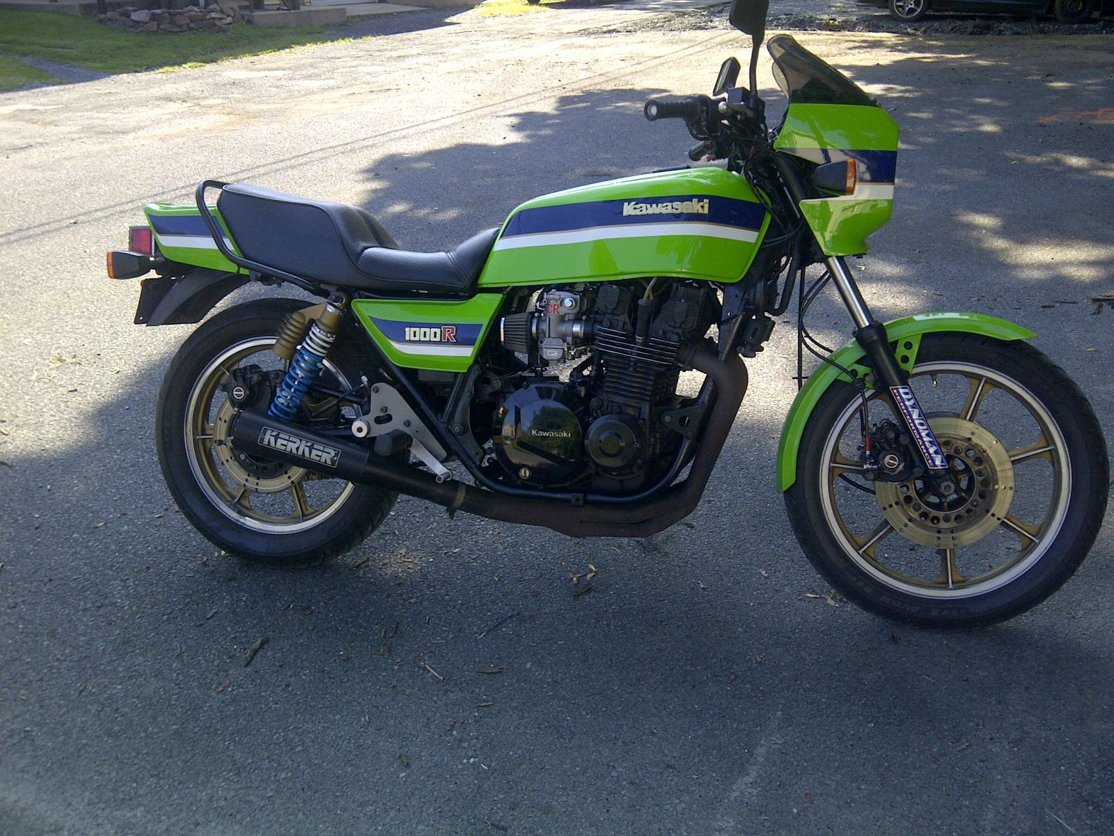

14 Dec 2015 09:41 - 14 Dec 2015 09:45JaFlo wrote: I just got the cheap Chinese eBay piggyback reservoir shocks. I had them rebuilt and modified by CL MotoTech. $250 total including the price of the shocks. I have not got to ride on them yet, but they seem legit. I wouldn't recommend these shocks without the rebuild service.
Attachment image-37.jpg not found
Some of the Chink piggy backs look cool but (I've read elsewhere) are originally intended for snowmobiles so need setting up properly. also there has been some reported failures in the castings. There was a guy on ebay uk selling quite a few but seems to have discontinued now...
I have a set of ohlins piggybacks, but at nearly £700 a pair I probably won't be buying again. The YSS remotes look nice, Koni or UK Hagon I'll be looking at next.
ps That pipe looks ace, the thin diameter tail and shortness looks LOUD!

14 Dec 2015 12:38 - 14 Dec 2015 12:45Tyrell Corp wrote:JaFlo wrote: I just got the cheap Chinese eBay piggyback reservoir shocks. I had them rebuilt and modified by CL MotoTech. $250 total including the price of the shocks. I have not got to ride on them yet, but they seem legit. I wouldn't recommend these shocks without the rebuild service.
The China shocks need to be setup correctly as I mentioned. Mine have 120lbin springs and 7wt Maxima shock oil. They also have the correct amount of nitrogen gas charge. That's what you get with the rebuild service. From China, the come with the wrong amount of some sort of mystery oil and are not correctly charged. The castings are actually quite nice, especially for how cheap they are. Most of the ones that break are the clevis mount ones, due mostly to improper mounting.
