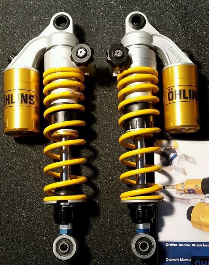

No eBay APP ID and/or Cert ID defined in Kunena configurationThose Gazi's look nice. I was all set to buy a set but pulled the trigger on these Ohlin's instead...
They are adjustable for length, and both compression and rebound damping, so presumably they should be tuneable for my 750E2. The ad says they will swap the springs for my needs too. Not sure about the eyelets is all so I asked them for assistance in that regard. Hopefully they will work with me.
