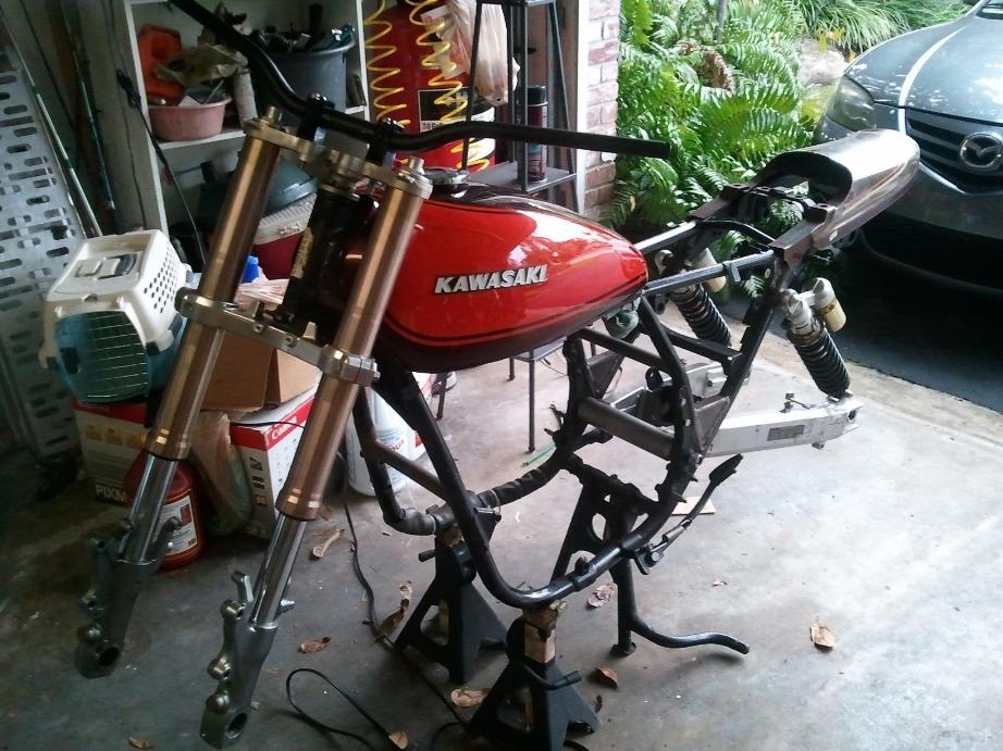

Hi,
Trying to measure offset for custom front sprocket for 2003 zx6r swingarm/wheel on a kz900. My kz 900 actual sprocket has a washer(2mm) sitting between it and the shaft collar. I checked the shop manual and the washer doesn't show up on the diagram, sprocket sits directly on shaft collar. There is only a retaining washer between sprocket and holding nut. Can somebody please confirm If there is an actual washer between sprocket and shaft collar ?? as it is messing my measures. I am getting an approx. 13mm offset without sprocket inside washer.
Thanks.

the 13 mm offset sounds right that is the same size that ramtough had to offset his front sprocket with the same swingarm and wheel as you have.
i actually believe they were both in the shop at the same time

I'm running the same swingarm but twin shock and came up with 3/8" with a slightly narrower wheel
And yeah ram had 1/2" offset i believe

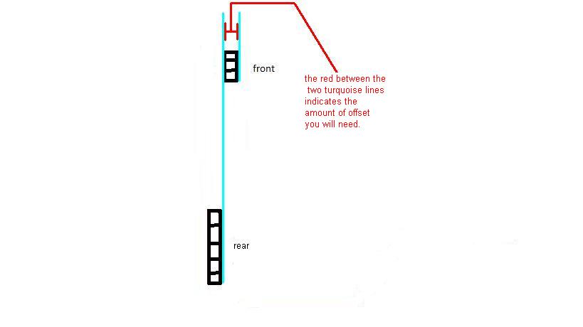

- Posts: 7442
Re: custom front sprocket offset
07 Apr 2015 12:47 - 07 Apr 2015 12:55
Last edit: 07 Apr 2015 12:55 by 531blackbanshee.
