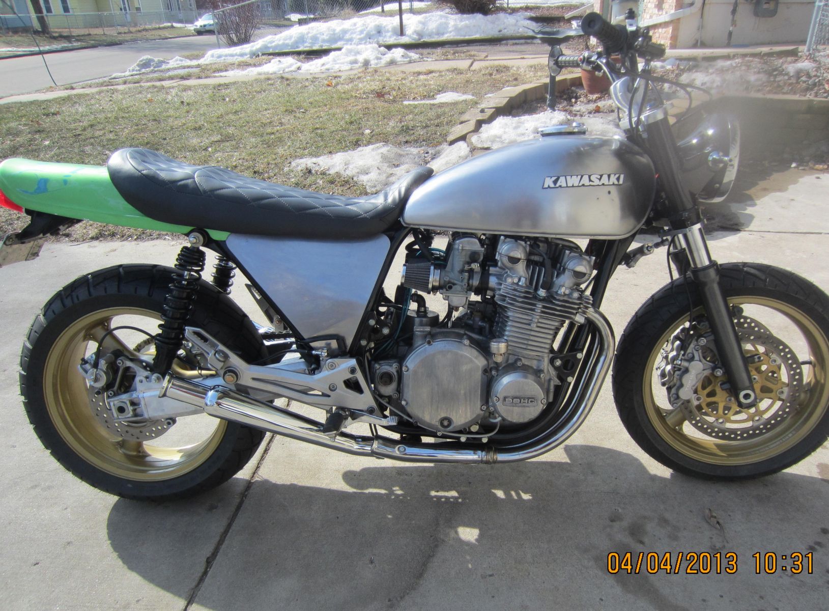

Re: custom front sprocket offset
07 Apr 2015 19:01Attachment WP_20140330_002.jpg not found
13mm with 520 gets the job done I really don't know how many miles few thousand on this one easy!
03 zx6 swingarm there was no spacer on mine when I pulled the 14 off but it had been regeared before
I got it

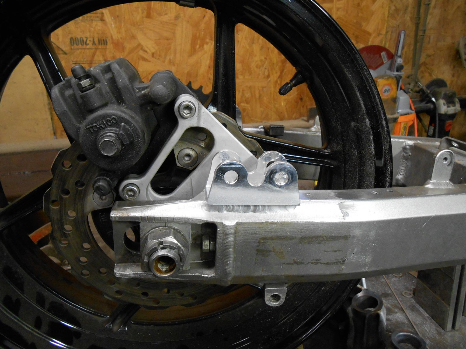

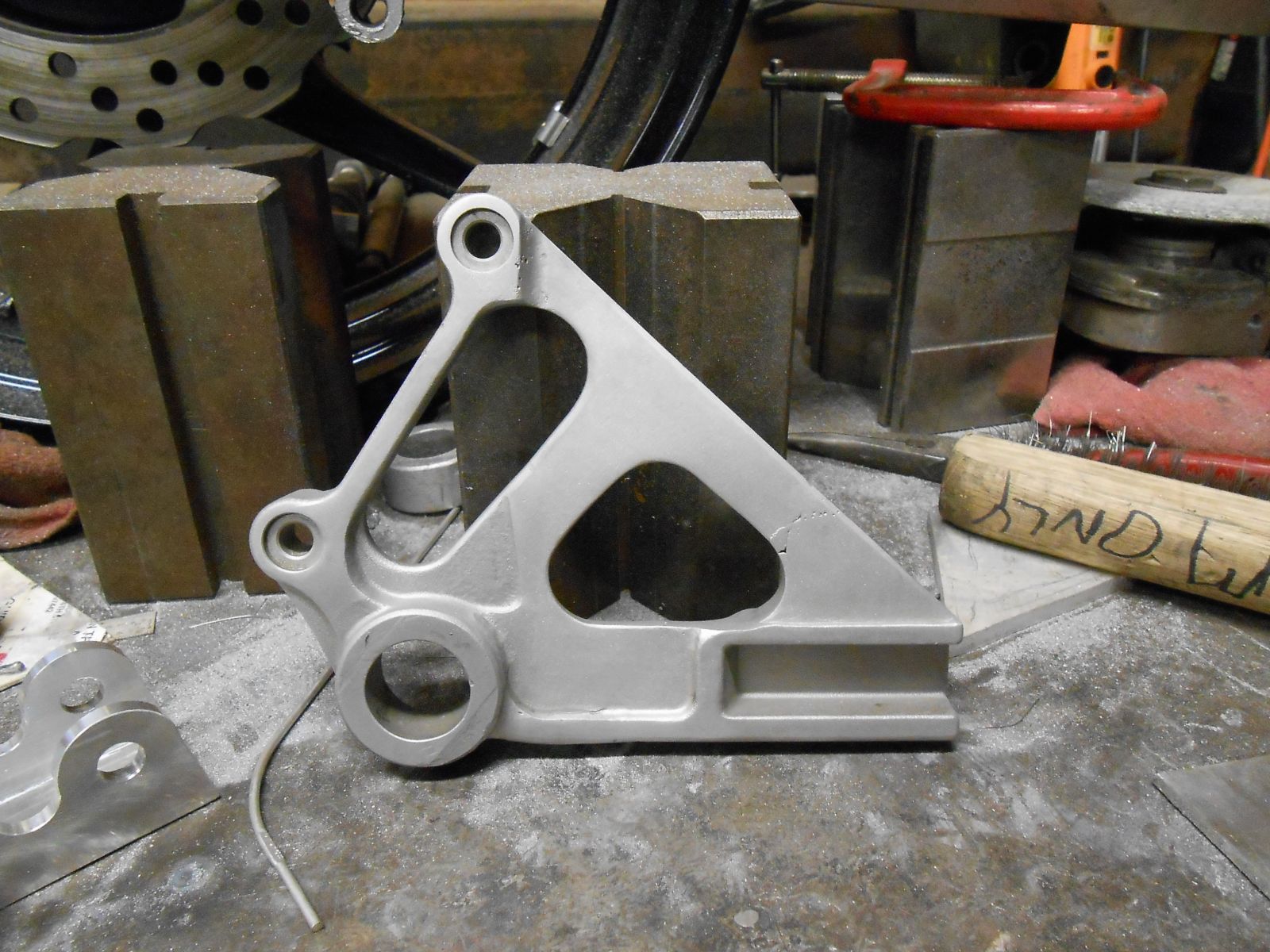

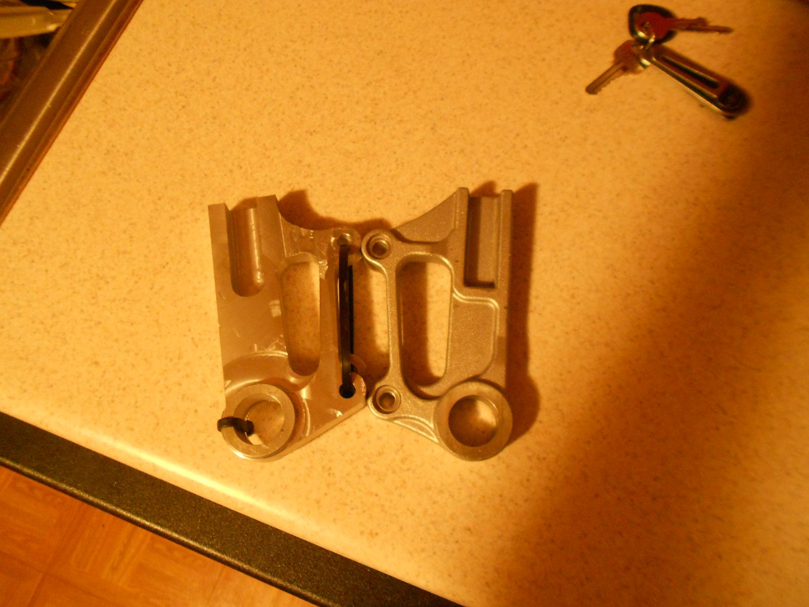

08 Apr 2015 06:54 - 08 Apr 2015 07:11benhurmx wrote: Nice caliper mount, Leon, too bad it wasn't available when i you did my swingarm. Do you still build custom front sprocket ??
to the best of my understanding i believe i can answer under rule #2 of the advertising policy.
(2. An item may be offered for sale as a consumer-to-consumer transaction in any forum where there exists reasonable expectation of being welcomed by another member who has previously posted in the thread ("cold calls" and "door-to-door" solicitations are prohibited).)
yes i can fab you an offset sprocket.
after crashing my head against the wall building the billet caliper bracket i built for you and then it turning out to be wrong really got me scratching my head.
so i came up with a way to cut the original bracket and weld a piece in to rotate it back to clear the shock.blend the welds out and they look pretty decent.
heres wyocowboys mounted on his bike.
how is the hokahey bracket working out tony?
Last edit: 08 Apr 2015 07:11 by 531blackbanshee.
08 Apr 2015 10:13 - 08 Apr 2015 10:15
It fits fine on the swingarm, but the extra caliper is positioned too far back on the rotor.Yours looks good. I still need to measure the front sprocket offset with another wheel/brake setup than the zx6 and decide which one to use.
