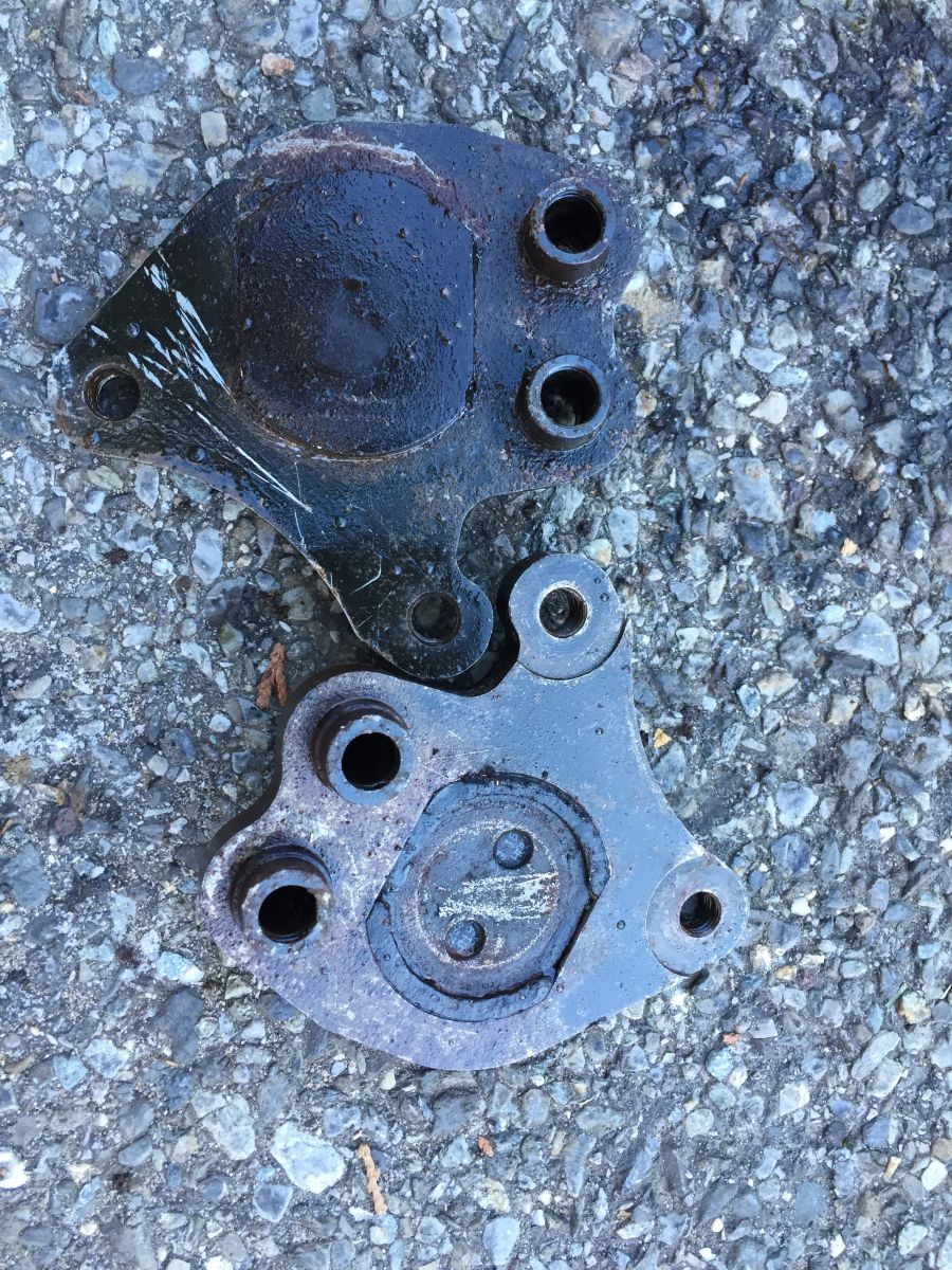

As much as I'm enjoying the conversation I need to bring it back to my brakes for a minute :laugh:
I soaked the brake pad holders in PB Blaster for about 3 days, hit it with a screw driver handle followed by a rubber mallet. Then soaked it in steaming hot water hoping the heat would expand it. Tried hitting it again and got nothing. It's now soaking in wd40 in hopes something else will work. Any suggestions? Attached picture is how it currently looks.

They can be a real pita sometimes,if you have access to a vise try clamping them in there while you thump on it.

Maybe you need to dissolve the rust locking the parts together. You could soak them in CLR, soap, and water. Soap and water to remove the PB Blaster and WD40. CLR to remove the rust.

I'd hook it back up and use the brake pressure to spit it out.

The ultimate penetrating oil is a 50/50 mix of acetone and ATF. theses are the results reported by machinst's workshop magazine.
Penetrating oil . Average load .. Price per fluid ounce
None ................. 516 pounds .
WD-40 .............. 238 pounds .. $0.25
PB Blaster ......... 214 pounds .. $0.35
Liquid Wrench ... 127 pounds .. $0.21
Kano Kroil ........ 106 pounds .. $0.75
ATF-Acetone mix.. 53 pounds .. $0.10
perhaps give that a try. Or if you need to get real extreme use muriatic acid. its what plating shops use to strip corrosion.

Psst, big hammer, just one good smack, then clean everything rust wise from the hole. All you're gonna muck up is the old brake pad. (You are planning on replacing right)

I second this. Been using this mix for a while. It seems (to me) to work a bit slower... ie: multiple applications, over time... but I've had success many times.

If it's on the caliper side hydrolic pressure should push it out. Hook it up bleed it then pump it until it does.

Eesh..I don't have a garage and it's about 10 degrees outside haha. I won't have decent weather to work in until late February. I'll try the vice first.
