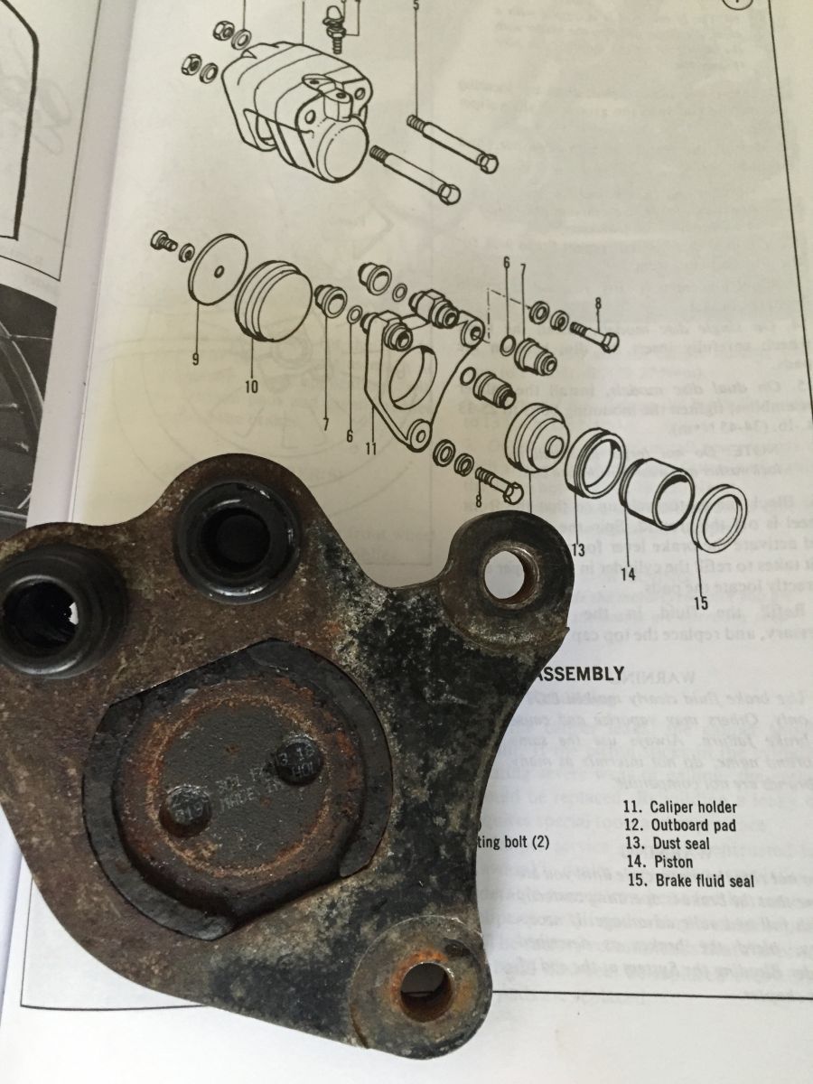

Winter projects continue! I disassembled my front brake calipers to paint them and they look great. Now that I have it apart I was inspecting the parts and it seems that #11 and #12 in the manual diagram, the caliper holder and outboard pad, are fused together from rust. Any advice to separate these two? Soak in PB in Kano Kroil? I realize I'll probably need new pads because it might be damaged when I get it out. I'd like to sand the holder smooth of rust. Also, is the holder paintable with caliper paint?

Give it a good thump with a screwdriver handle after soaking it in some wd40 or something.

Will do. I actually thought it was one part until I looked in the manual.

It's supposed to be able to float back and forth so the pads wear evenly. I forgot that when I put my drilled disks on. Once they freed up the pulsing damn near went away. Still have to have them milled.

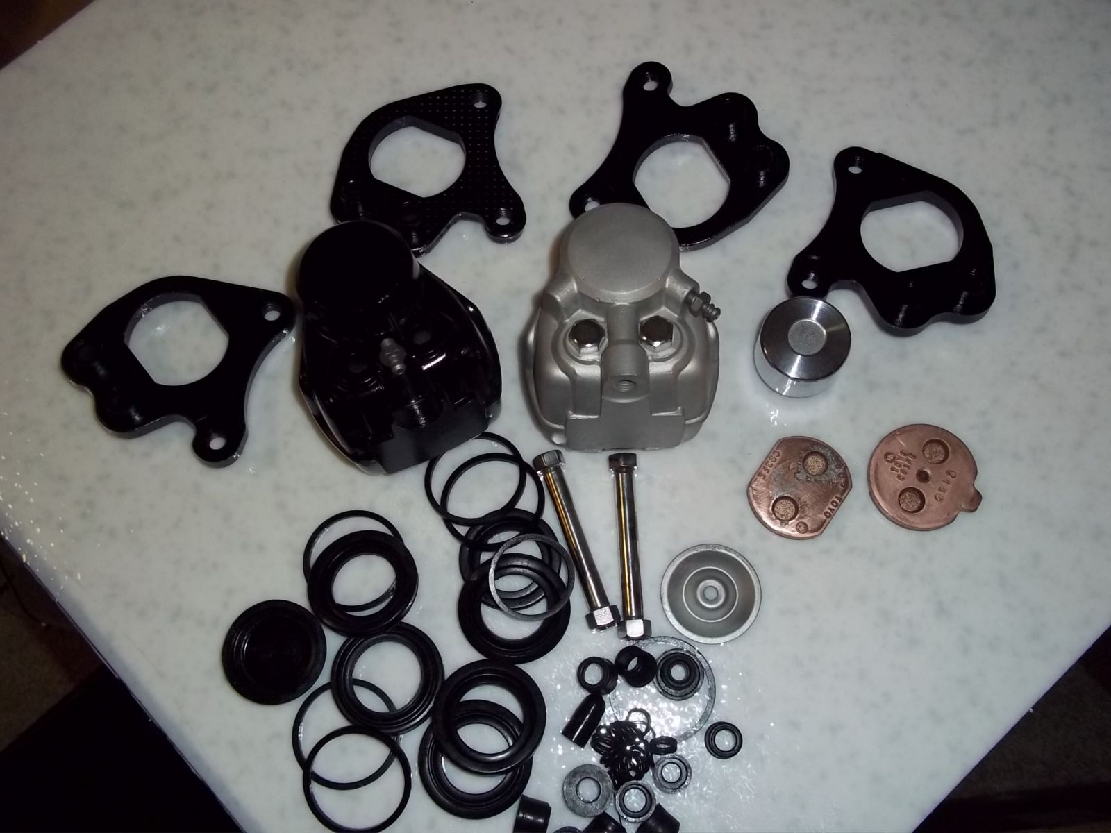

#12 dis-apperar? These brakes work when they are together! I just cleaned up a couple of these.

Check out that shiny paint job! Hopefully mine will look like that when I'm done. Did you paint them yourself?
