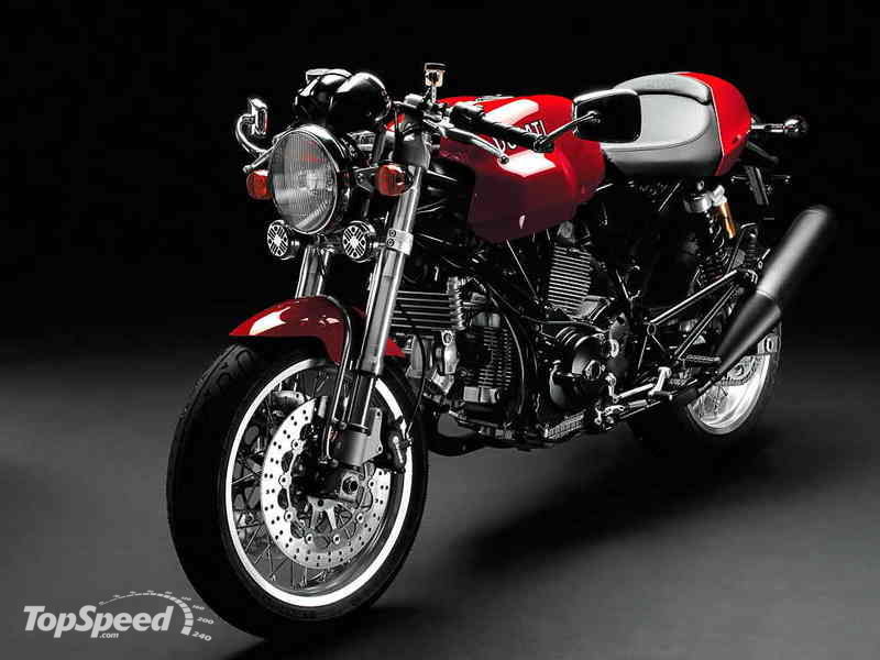

maybe a front fender from a ducati sport classic?
might be a fairly straightforward mod.
or some similiar type of tubular brackets.

That red Ducati front mudguard design would be perfect, will toy with some ideas along that design.
Those spoked wheels are also beautiful, don't think I can justify the money to my wife tho!
I just bought the Mikuni RS34s and a full dyna 2000 ignition which I know she will punish me for later!
