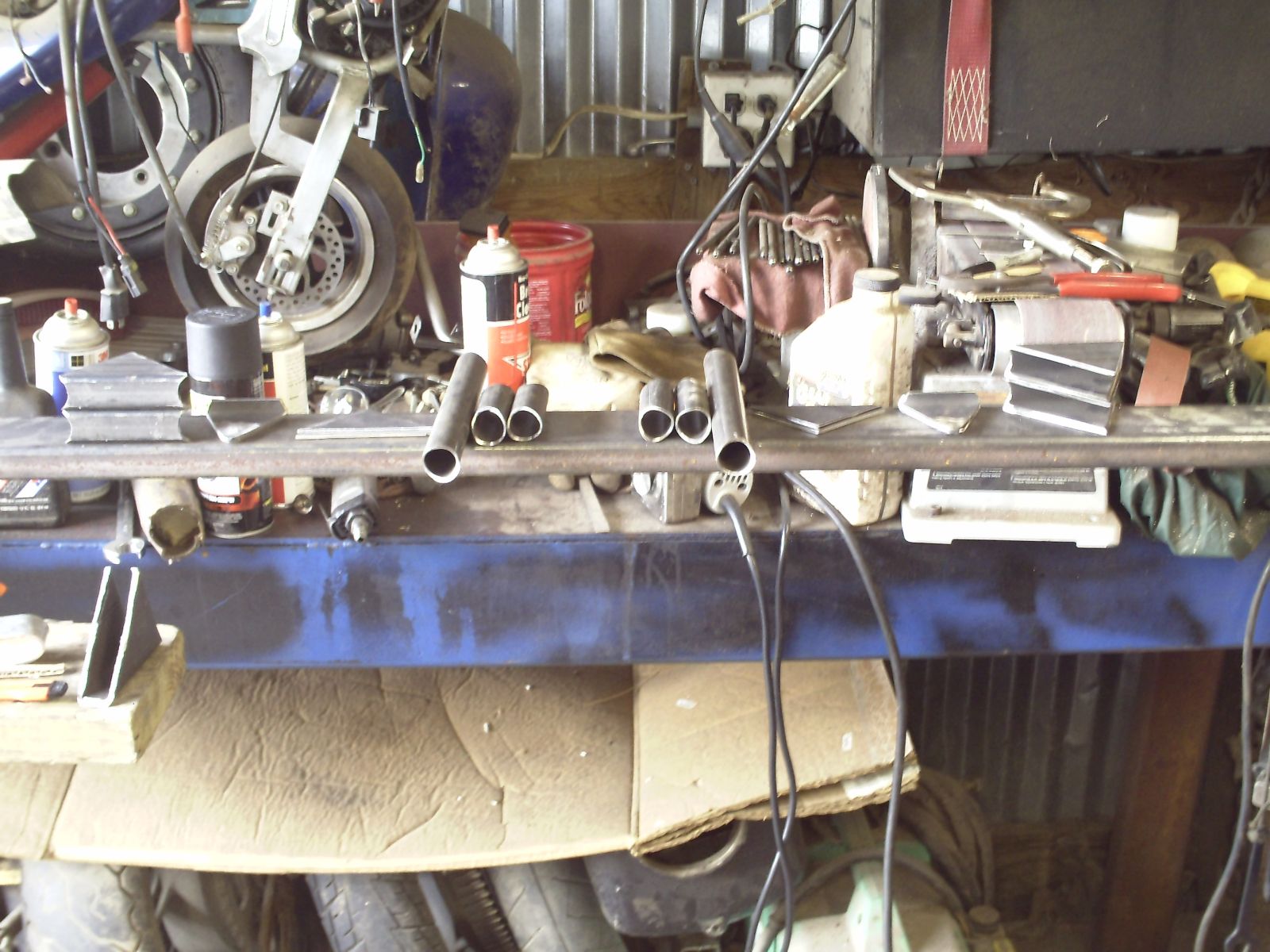

Check with WIREMAN he was talking about cutting some steel blank kits I thought?

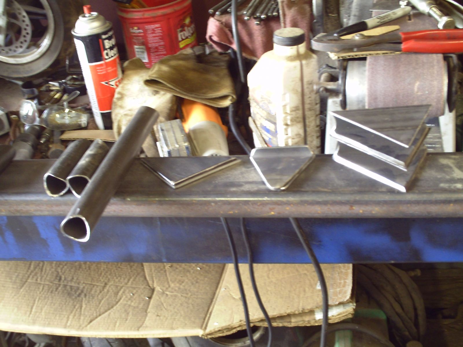

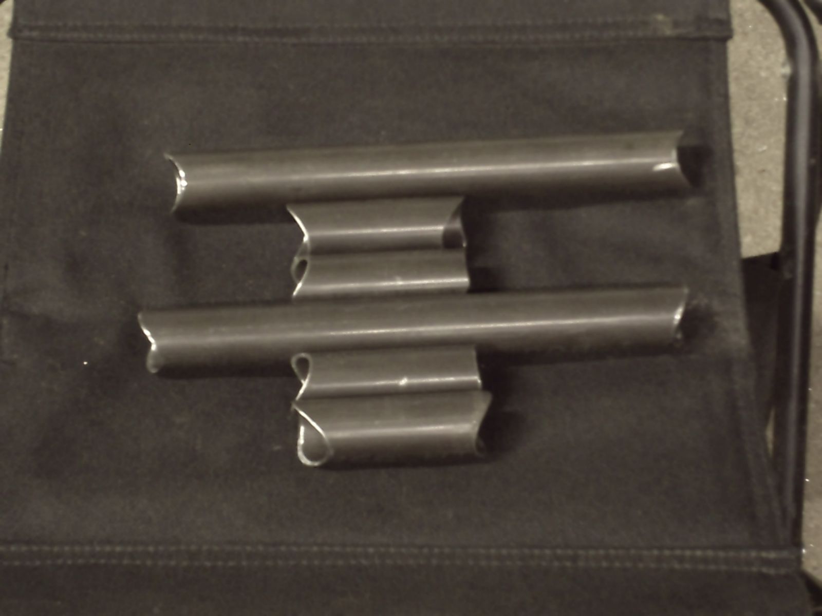

Ive got the templates all made,I just haven't had any time lately to focus on cutting the pieces out! :sick:
I want to get the frame on my bench finished up so I can work the bugs out of the parts before trying to mass produce them,never enough hrs in my day lately! :woohoo:

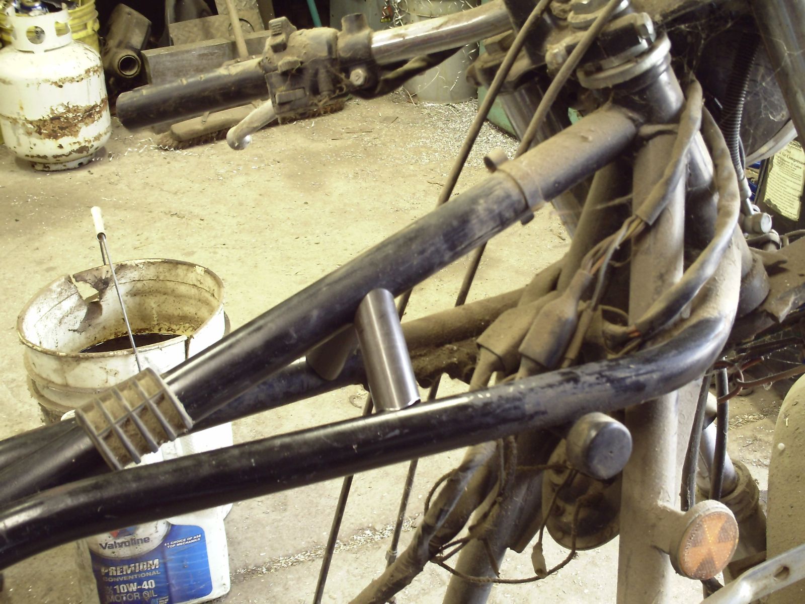

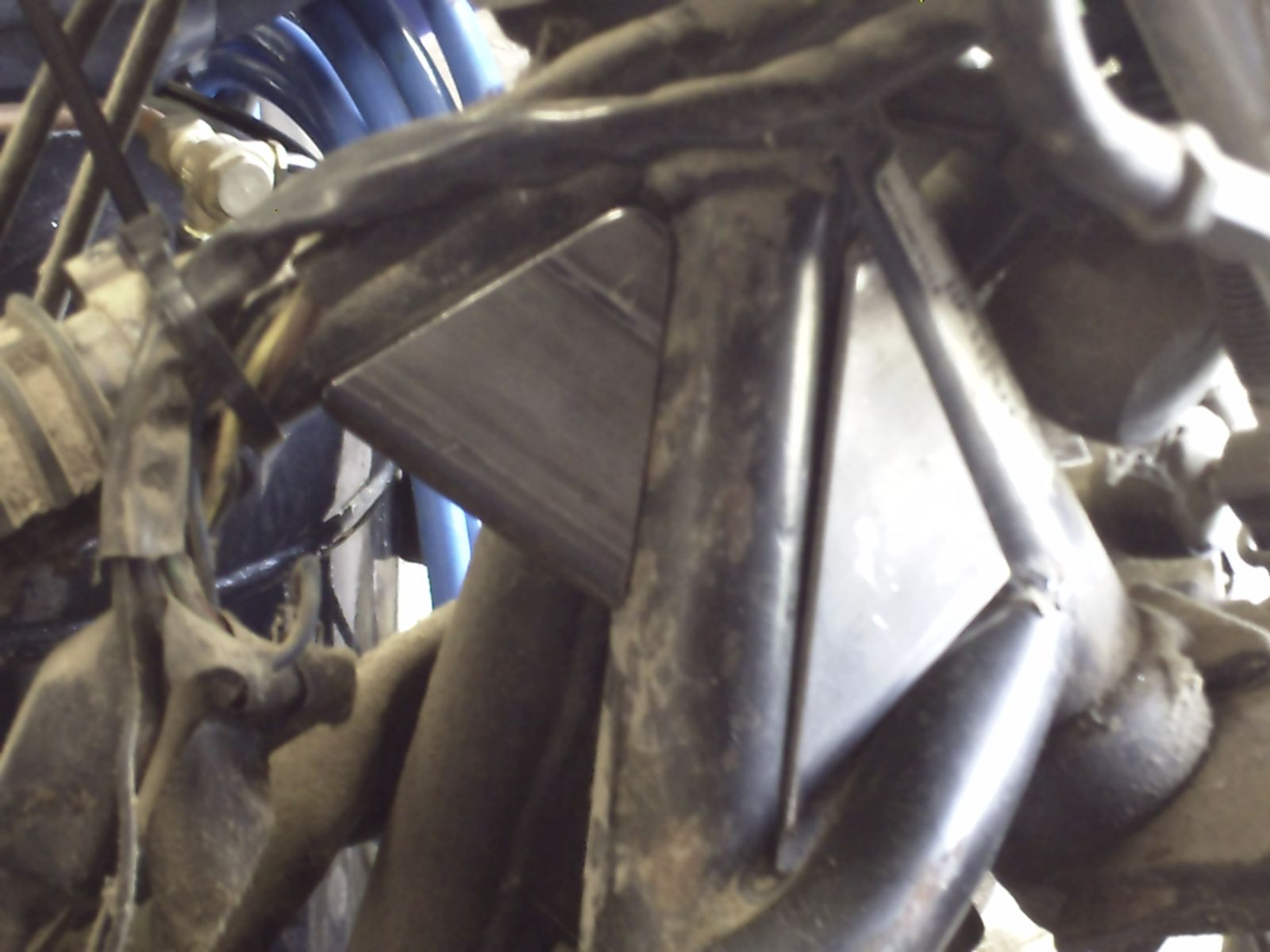

Some of that bracing looks like overkill. The two frame rails that bend around the front down tubes are welded to the down tubes, creating a triangle, so that plate is not needed IMO. I think most of the flex comes from behind the engine, not the steering tube.

the awesome thing about building your own bike is you can use or not use whatever you like.
if you don't think a brace is necessary don't use.
if you like the way a stock swingarm looks,use it.
if you get tired of unwanted lane changes when you hit a bump mid corner,get a stiffer swingarm and maybe try some frame braces.
it is ultimately your decision.
i made mine when i cut out the frame braces you see.

18 Dec 2012 14:19Kidkawie wrote: Some of that bracing looks like overkill. The two frame rails that bend around the front down tubes are welded to the down tubes, creating a triangle, so that plate is not needed IMO. I think most of the flex comes from behind the engine, not the steering tube.
if your bike handles anything like mine the overkill is much appreciated :lol:
plus if i know im building a bike to 160 to 200 hp i want the frame and everything else to be capable of twice that. overkill is bliss

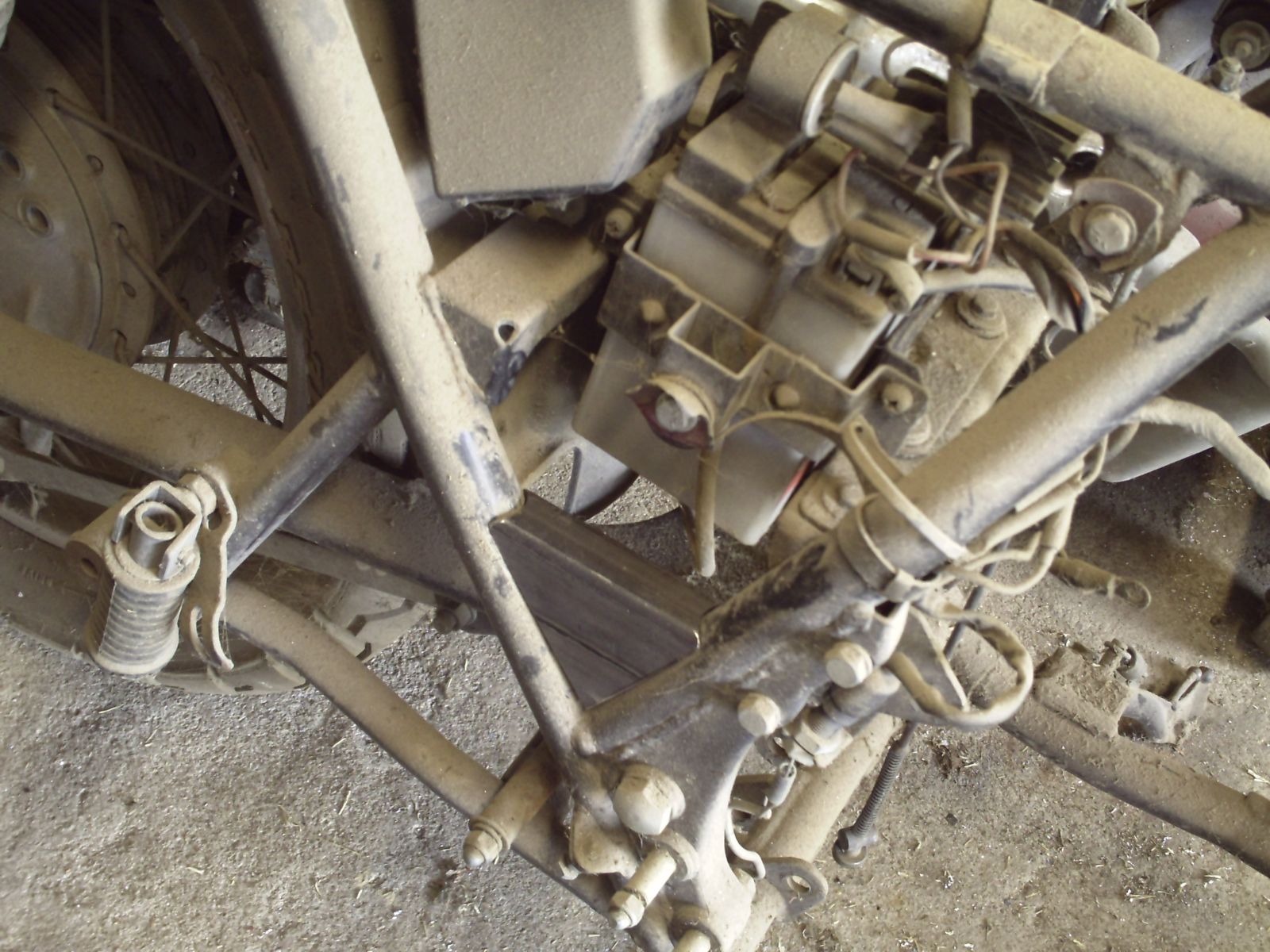

Racing is one thing, I'm talking everyday street riding/cruising. I could easily throw a crapload of gussets on my frame and call it a day, I'm looking for someone to find exactly what the problem is with the older frames. Like I said, riding it seems like behind the engine is the weakest spot, possibly where those triangular gussets are above the swingarm bolt.
I guess the only way to really find out is to put a bare frame/engine in a jig and tray to fold it in half.

18 Dec 2012 14:47Kidkawie wrote: Racing is one thing, I'm talking everyday street riding/cruising. I could easily throw a crapload of gussets on my frame and call it a day, I'm looking for someone to find exactly what the problem is with the older frames. Like I said, riding it seems like behind the engine is the weakest spot, possibly where those triangular gussets are above the swingarm bolt.
i think alot of it was inconsistent headtubes and welds then the flimsy swing arm and undersized motor bolts mostly
