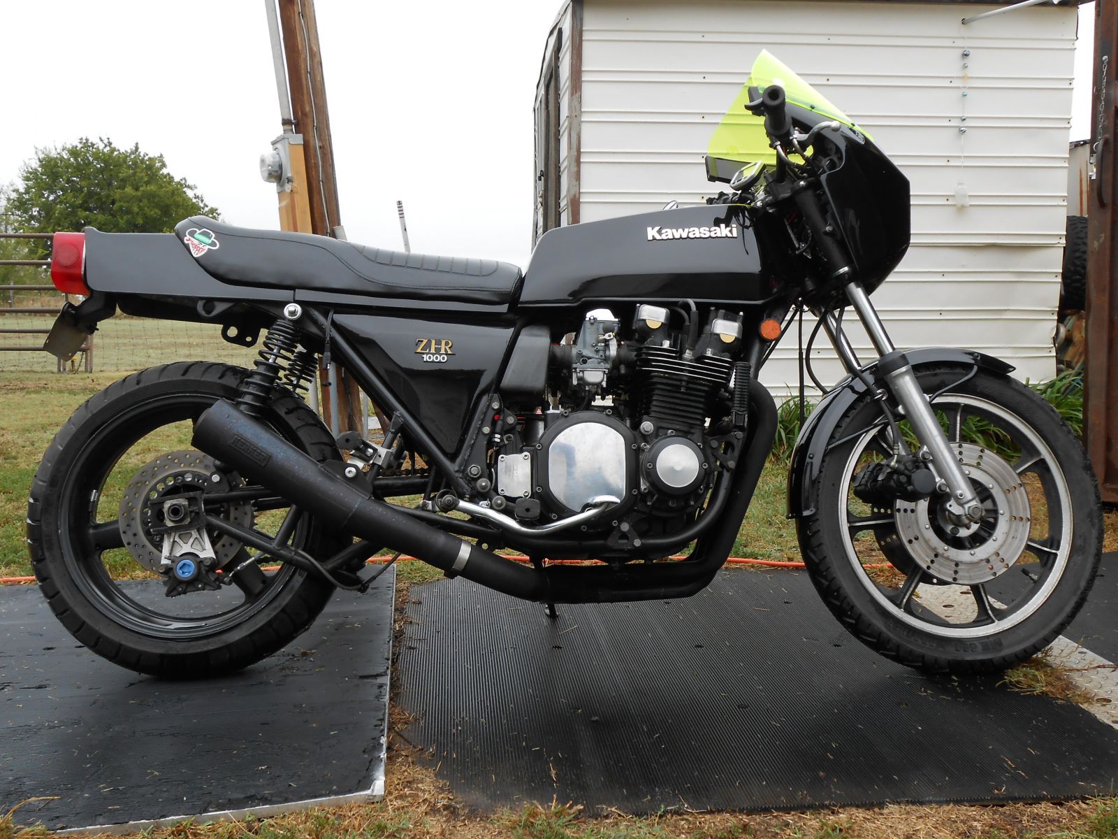

- Posts: 7442
Re: Modifying a KZ650 rear end
18 Oct 2012 09:56 - 18 Oct 2012 09:58
wireman has some wise words.
once you do any kinda mods you need to shake it down and get a feel for how it is going to handle.
before you can really trust what it is going to act like when you go to stuffing it into corners.
i have done the 190/200mm rear tire(i've ran both on the same wheel)conversion and still run my stock skinny front tire and scrape both sides a couple times a summer.
but,
you can bet your a$$ that the first couple times i was riding it i didn't just go into corners and throw it at the pavement and screw the throttle on :lol: !
i do now tho :evil: :whistle: ,
Attachment aftergaragewreckpaintjob5.JPG not found
but,
