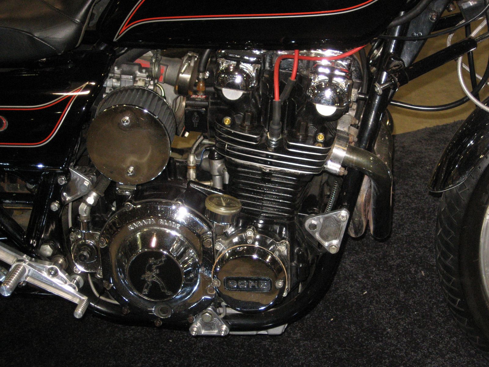

Les Holt made these for me.
He is a member here . A good friend and excellent machinist
Attachment gshow2014002.jpg not found
Lots of folks here on KZR have these
Hope this helps

On the cross breeding, not sure what they are meaning but, you got disc brakes, my stuff is a bolt on replacement, all you add is the master cylinder, ZX6 part easily purchased off eBay, shifter link, modify the ole shifter to take the link bolting on and the pressure switch for the brake light. Setup is a proven success cheap at less than $300 shipped to your door!

I put a set of Tarrozis on my LTD. the MC pushrod is different form the KZ1000A, otherwise they are bolt on. Unless you are going for a period correct piece i would definitely go with Les' rearsets; same price but much higher quality.
