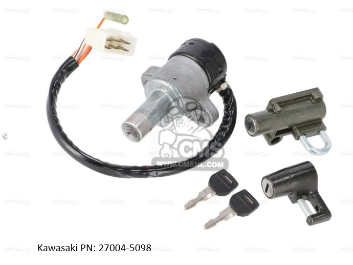

The key will not turn. The steering lock is disengaged (not locked) but the key won't turn. I have done all of the usual stuff, wiggled, lubed with both graphite (first) then brake cleaner and then wet lube. Won't tun at all. I ordered a new switch that all of the sites claim is the one...but it is not. This one is different. I found the Kawasaki OEM number but it isn't available anywhere anymore and even if it was, it's $350-500!
This is the one I need. Any ideas? Or would anyone happen to have one with key(s)?

Are you able to find the four digit key code (usually starting with “Z” on the GPzs if I recall correctly). It will be stamped on the ignition switch assy in a place that wouldn’t be visible when it is installed on the bike. My guess is that you don’t have the correct key is all. Once you have the code you can order a replacement key. There are a few vendors out there (including RSTNICK on this forum) who can make a replacement based on just that info.

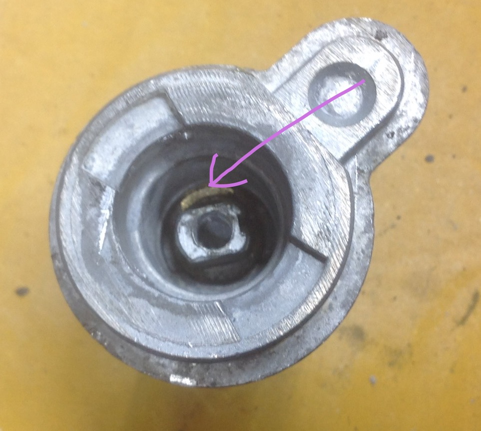

The below "how to" I posted a few years back might be helpful
82 J,K &M ign barrel removal - KZRider Forum - KZRider, KZ, Z1 & Z Motorcycle Enthusiast's Forum

Wookie, In your tutorial You mentioned looking up in there and pushing the wafer toward the middle to slide the actual barrel out I've got it completely torn down but do not see any wafer to pull that out.
This one releases the barrel from the housing (key needs to be in when you pull the barrel and the chrome cap also needs to be removed from the barrel (don't lose the flap and spring)

possible solutions. these are similar in appearance. the terminal pins may need to be replaced with correct size.
KZ1000-J2 Ignition lock source. has link to another site w photos. kzrider.com/forum/forum-index/4-electric...ignition-lock-source
KZ1000K LTD. VN750 ignition switch. www.kzrider.com/forum/4-electrical/61386...n-1981-82-kz1000-ltd
