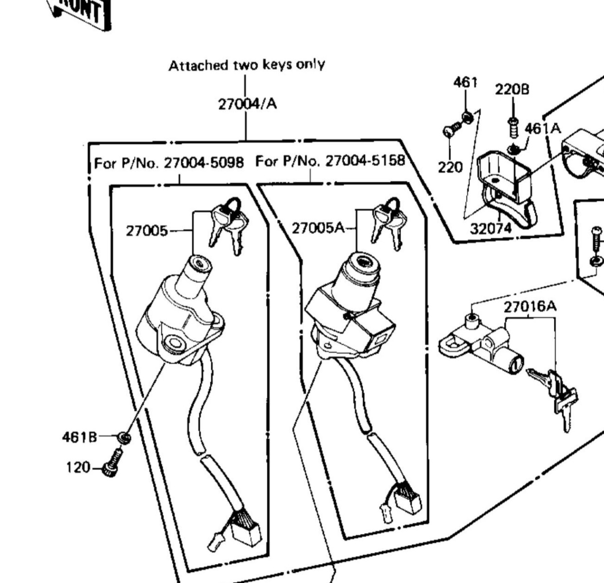

Not exactly sure tbh Martin. I bought the bike in boxes and it was all present except........ the ignition barrel. As far as I have been able to workout it needs the one on the left below.

The one on the left is #27005-5019, as mentioned above.

I think your right Martin. Looking at the underside of the top yolk there is a half circle recess to match the lock. Plus the two bolt holes.
The J2 lock required is a 6 wire block plus a separate single bullit spur.
Wire colour layout is
Orange/green - brown - orange
White/black - red - white
Seperate spur is red/yellow.
It's unlikely another model switch would be an exact fit/wire layout so will have to get busy with a multimeter once I find one which will physically fit with the correct amount of wires.

The Emgo catalog has wire/pin info on some of their ignition switches. see catalog starting on pg 305.
emgowebsite.04833d7.netsolhost.com/wp-co...eneral_IN-2967-1.pdf
Partial list of similar ignition switches w the slender lock cylinder. not all years listed. a couple of OEM or aftermarket may be available.
1981-82 KZ1000-J1/J2 = 27005-5019
1984 ZN700/1100 = 27005-5040
1986 EN450 = 27005-5044
1986 VN750 = 27005-5052 >> this is the ignition switch that was used on a KZ1000-K Ltd.
1986-87 ZL600/900/1000 = 27005-5045
1986-87 ZN1300 Voyager = 27005-5034
Edit Vulcan 750 w photo: www.partzilla.com/product/kawasaki/27005...b74e203821080f95ac3f
