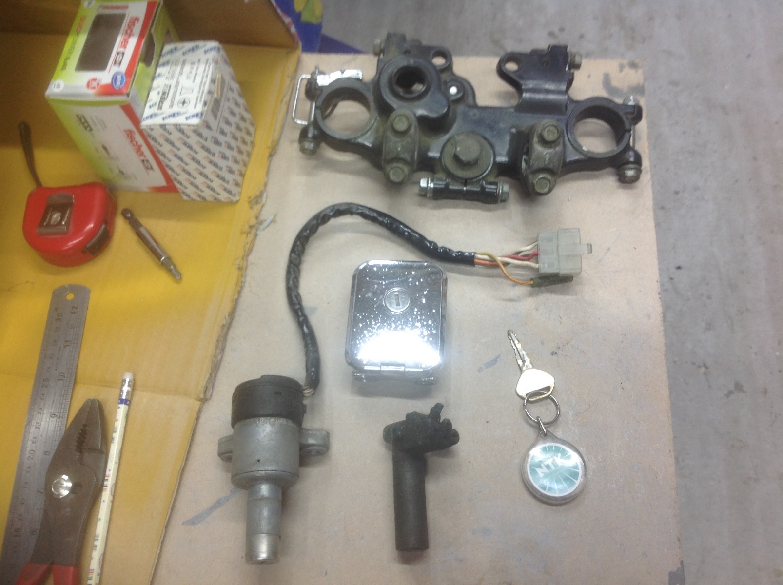

So I have ended up doing an unplanned little job tonight. I have been helping a new member with an ignition switch query on his 82 KZ1000ltd who was looking to swop it out. However the previous owner had completely butchered the top yolk. Since I'm not using most of my 82 in my build I offered him the top yolk and lock set, he made a fair offer, I accepted and he paid straight away in good faith.
This is where the fun started, I bought the bike partially disassembled and a non runner but still with 6 months MOT valid so have never actually used the ign. I thought should be ok but I will just check it works ok before I box it up. Guess what, switched on and off but would not turn to the "park" or "lock" position. Now I'm not in the game of stitching anybody up so I had a choice, fix it or eat humble pie and give a refund.

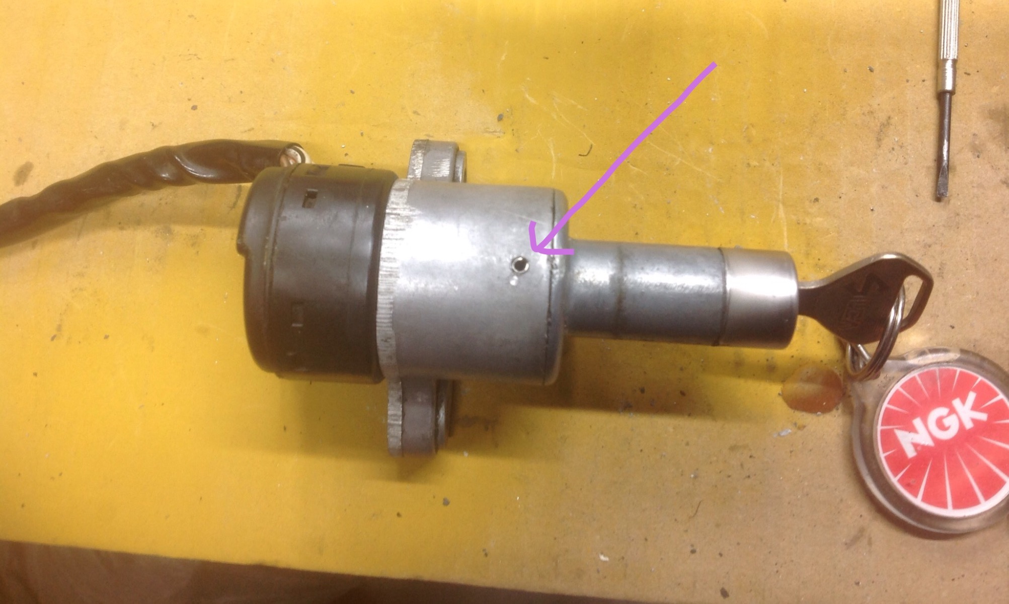

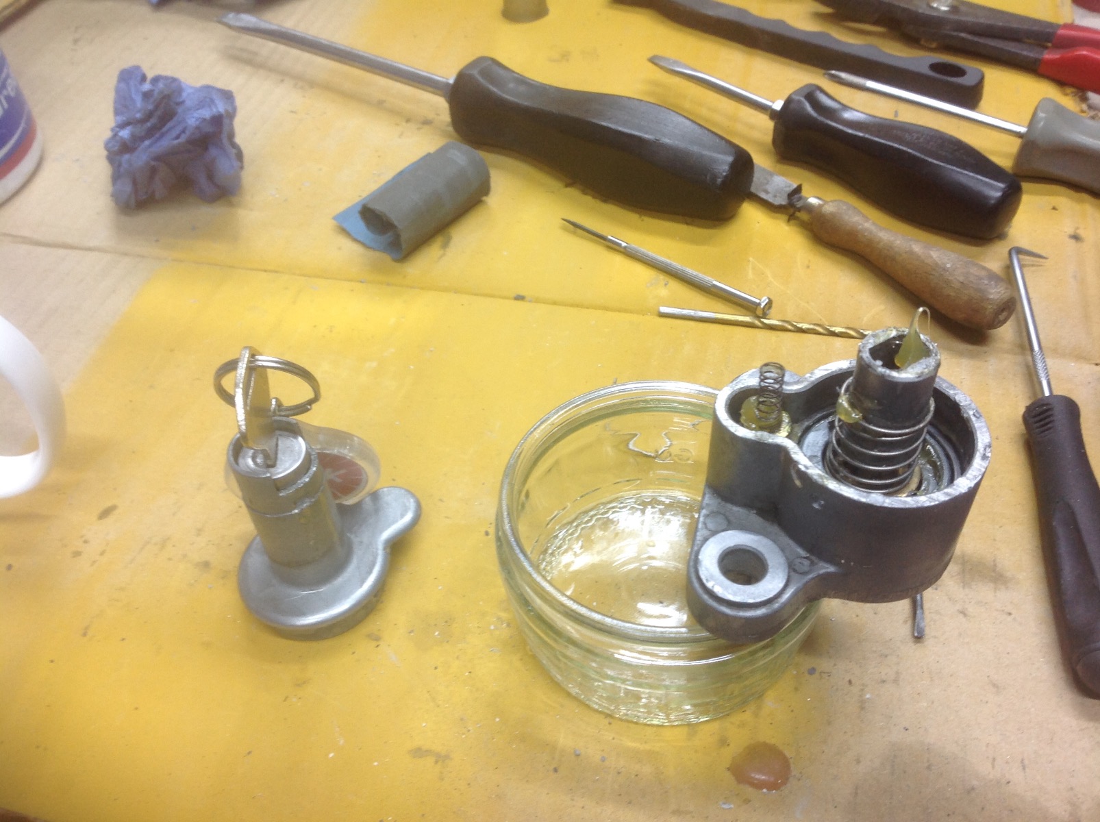

  1. 1st drill out the three "roll pins" which allows the unit to split into two halves

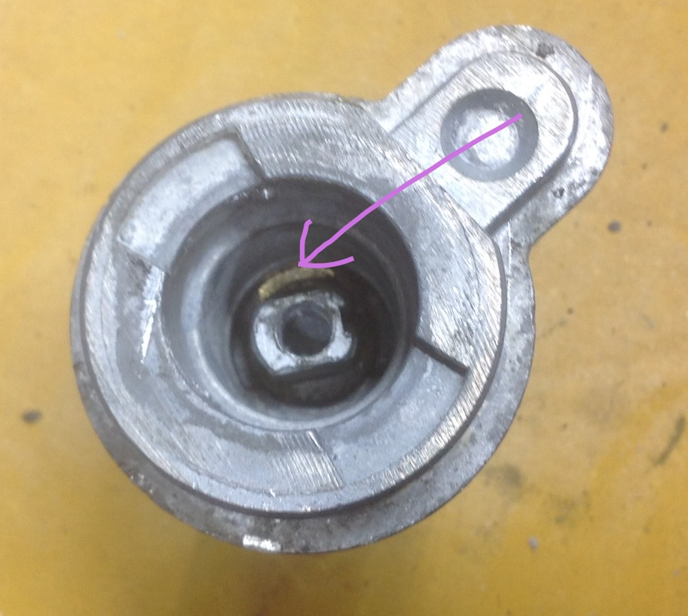

  2. with the key inserted look up inside the top housing for a wafer, push that in towards the middle and bingo the barrel will pull out ( once you have removed the chrome top cap) be careful at this stage as you pull the barrel out that the wafers don't spring out and go to that special place where anything smaller than an elephant instantly disappears for ever !

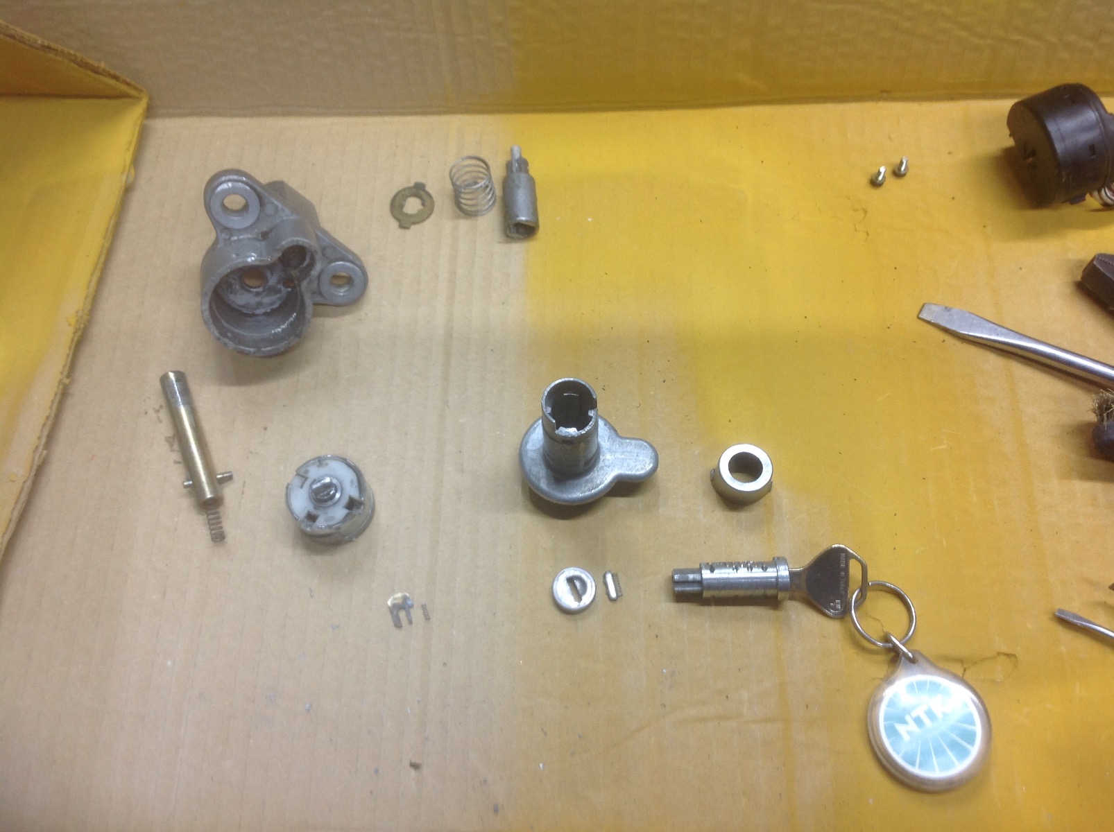

  3. then it was just a case of cleaning the crud and hard grease out of everything, de-buring the wafers with a rat tail file then greasing and reassembly with some new 3mm roll pins
