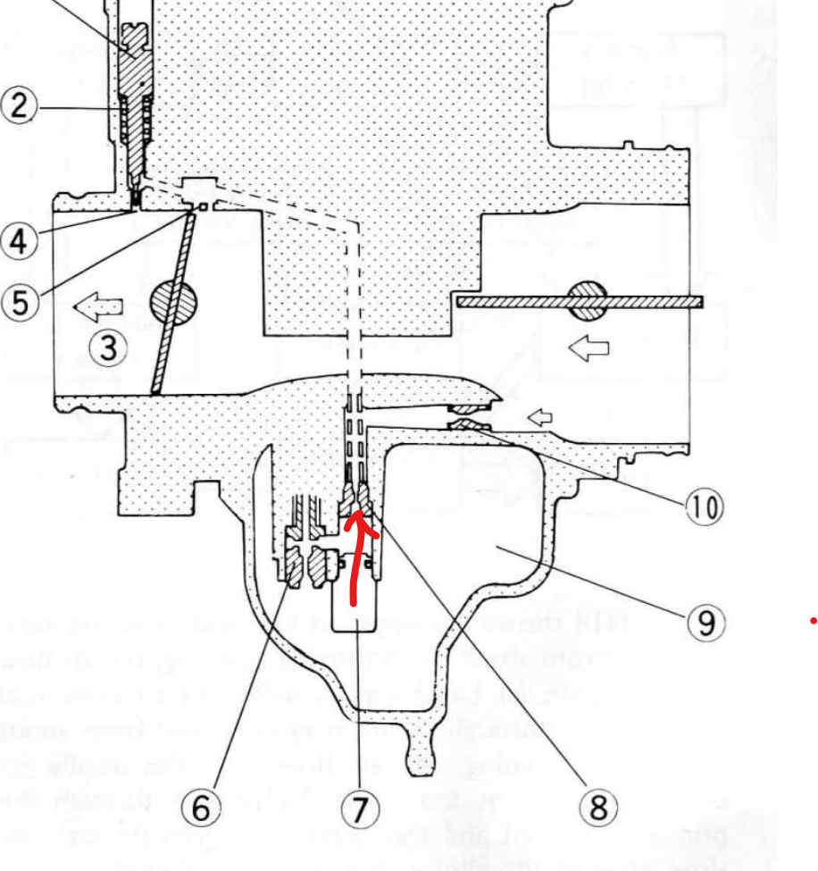

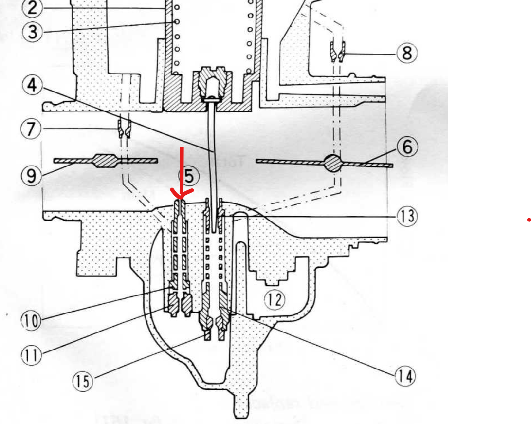

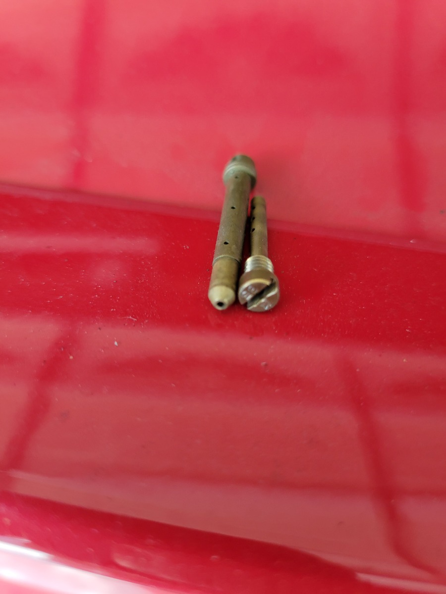

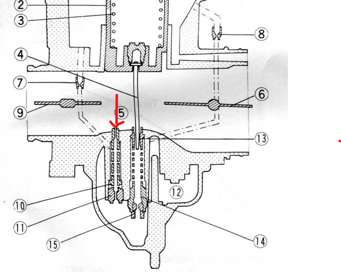

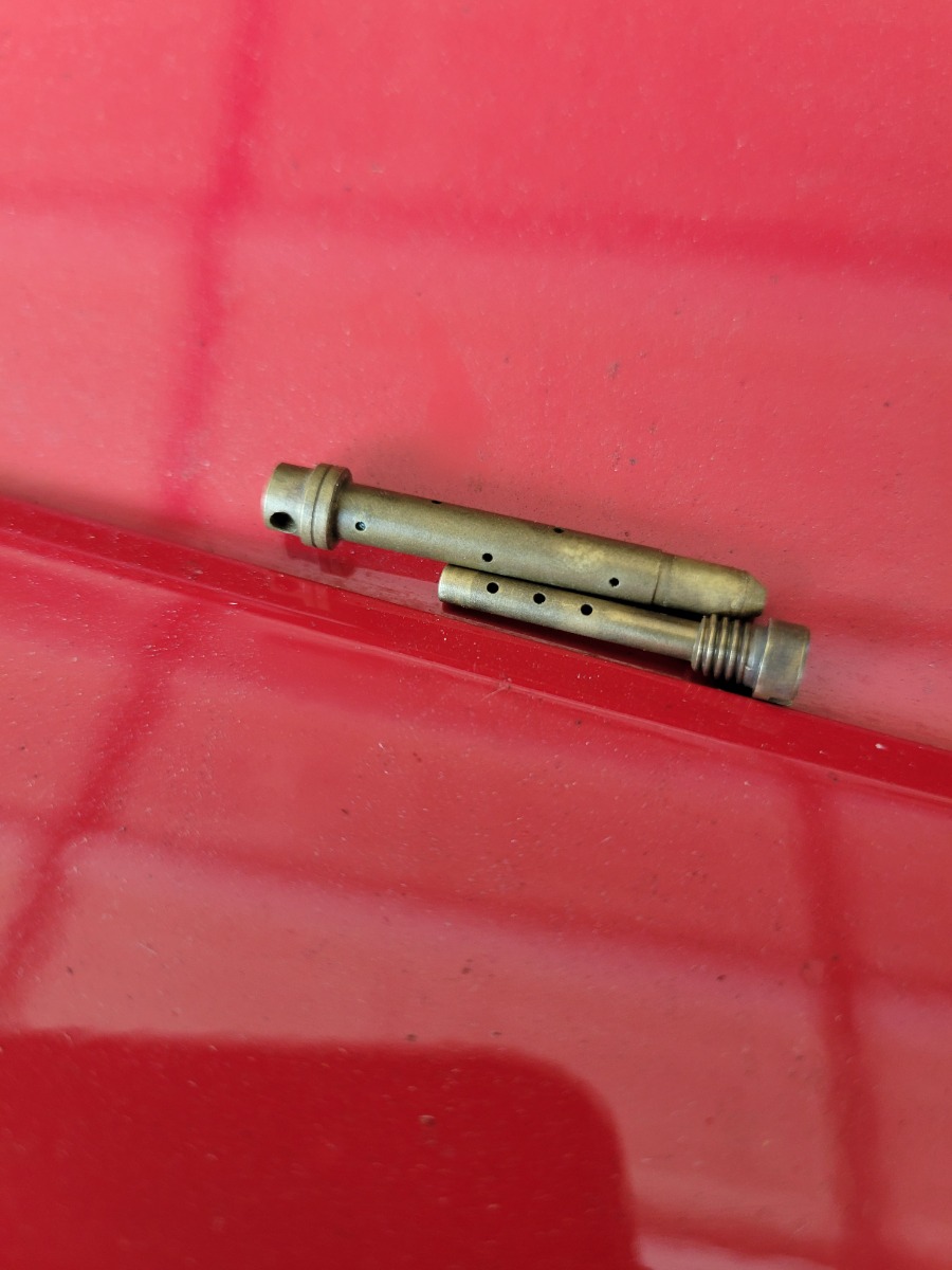

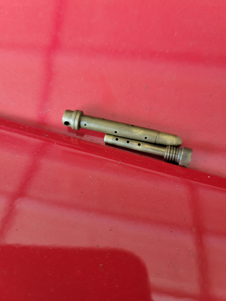

The pilot jet and bleed pipe have tiny orifices in them, and they easily clog.
I pull one strand from a stiff wire brush, and use that to push through any crud that may be blocking the hole. Hold them up to a light, and make sure you can see through them, end to end.

26 Jun 2025 06:59Hey Ness. I did that based on a previous reply from you. This cold cylinder happened after doing that cleaning then taking the bike out for a test ride. Could it have clogged again? I used a set carb cleaning wires that I had bought previously when I rebuilt the carbs.
