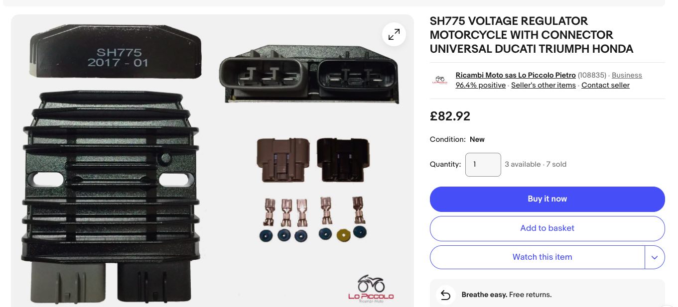

Whats the best way to ensure the SH775 RR is genuine and not a knowck off?
I saw this one marked sh775 but i figure it would be easy to add this on counterfeit items

19 Jun 2024 10:56Look at the sellers reviews positive and negative.

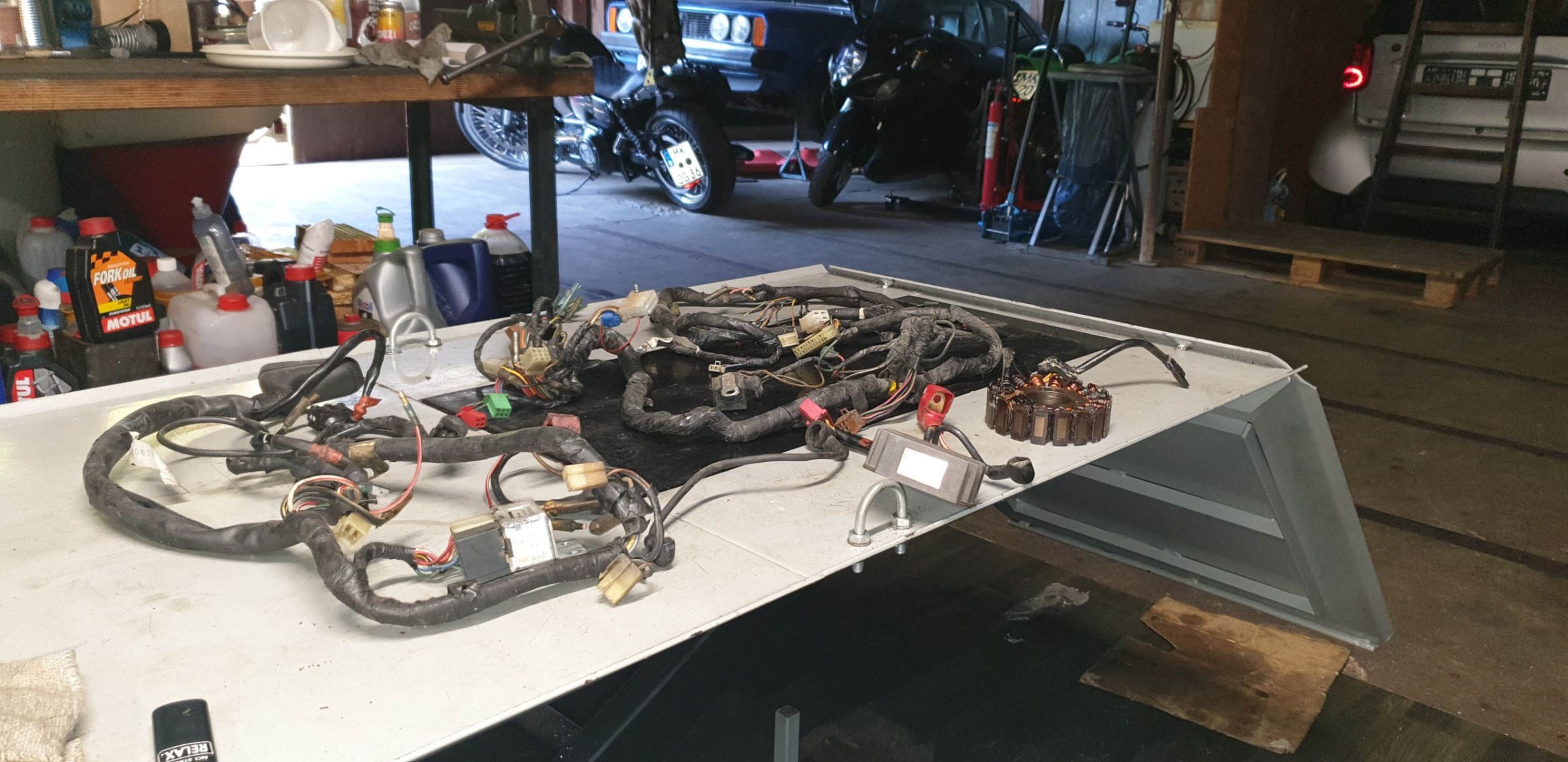

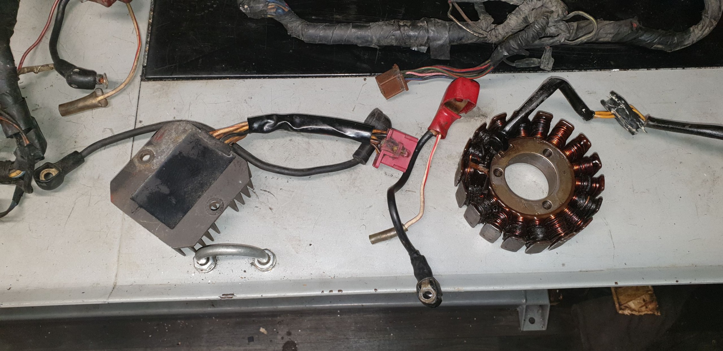

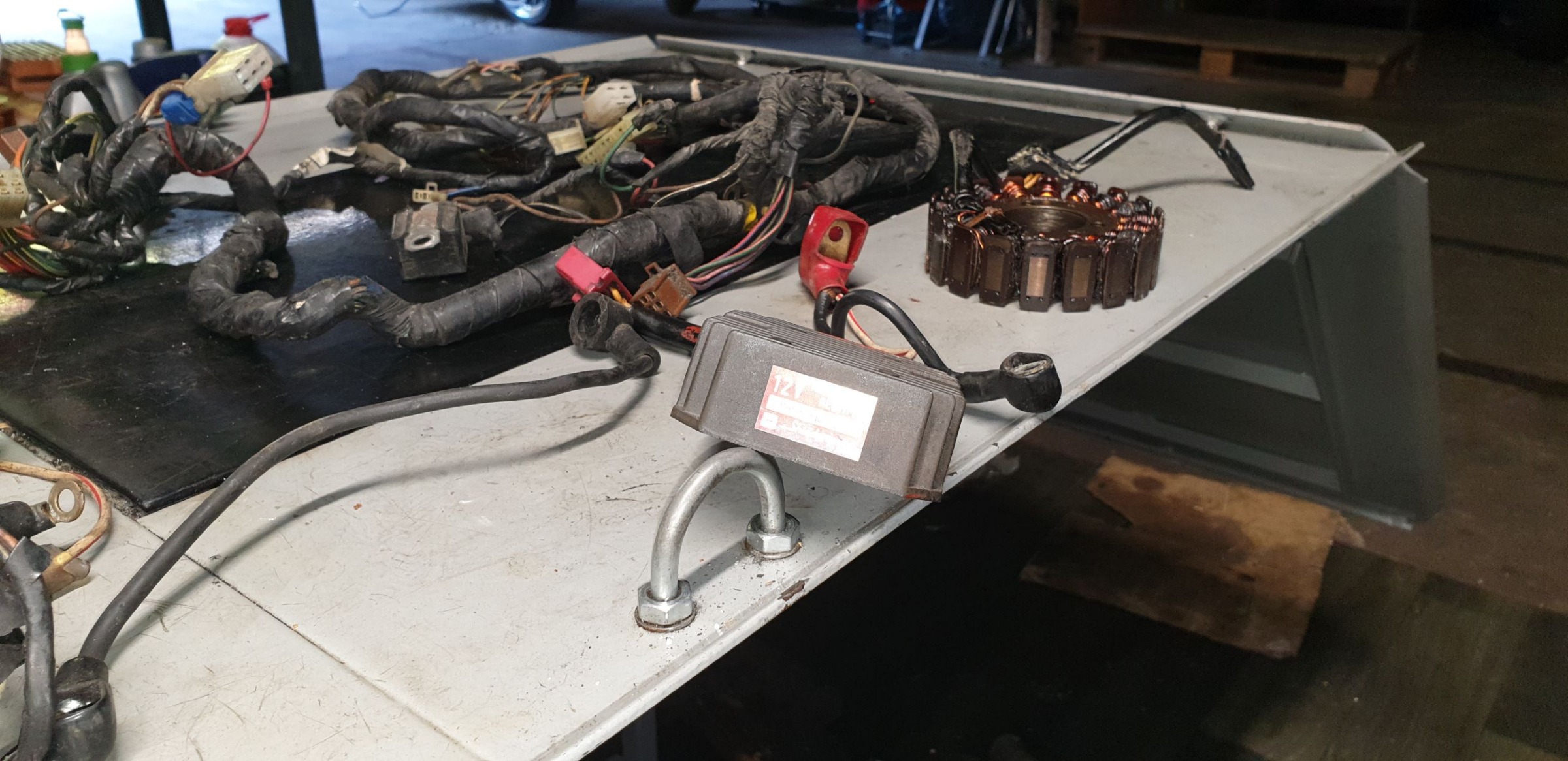

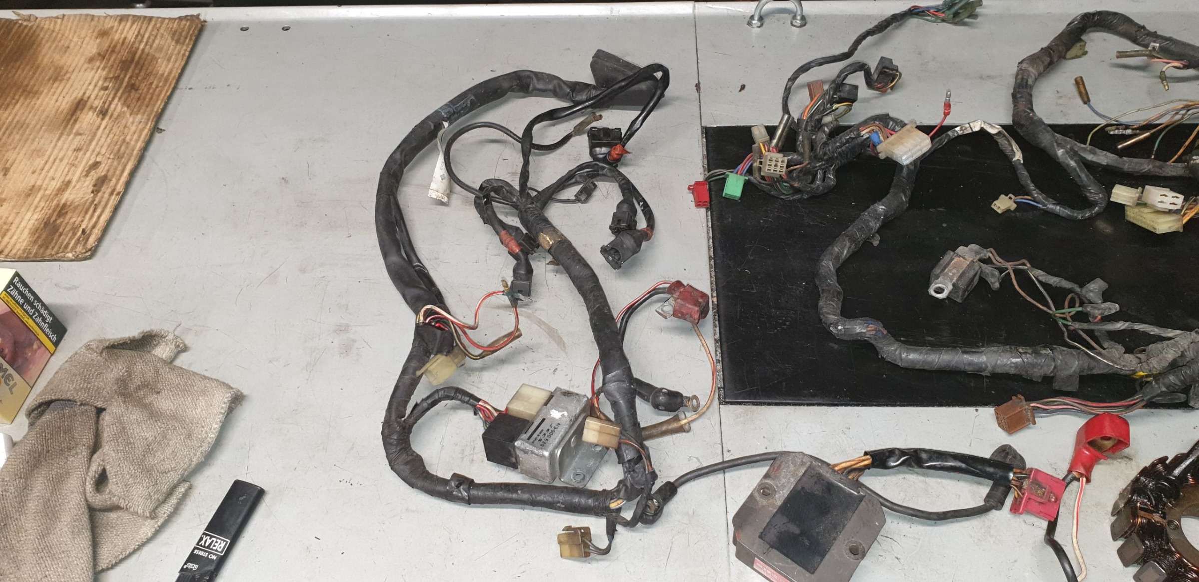

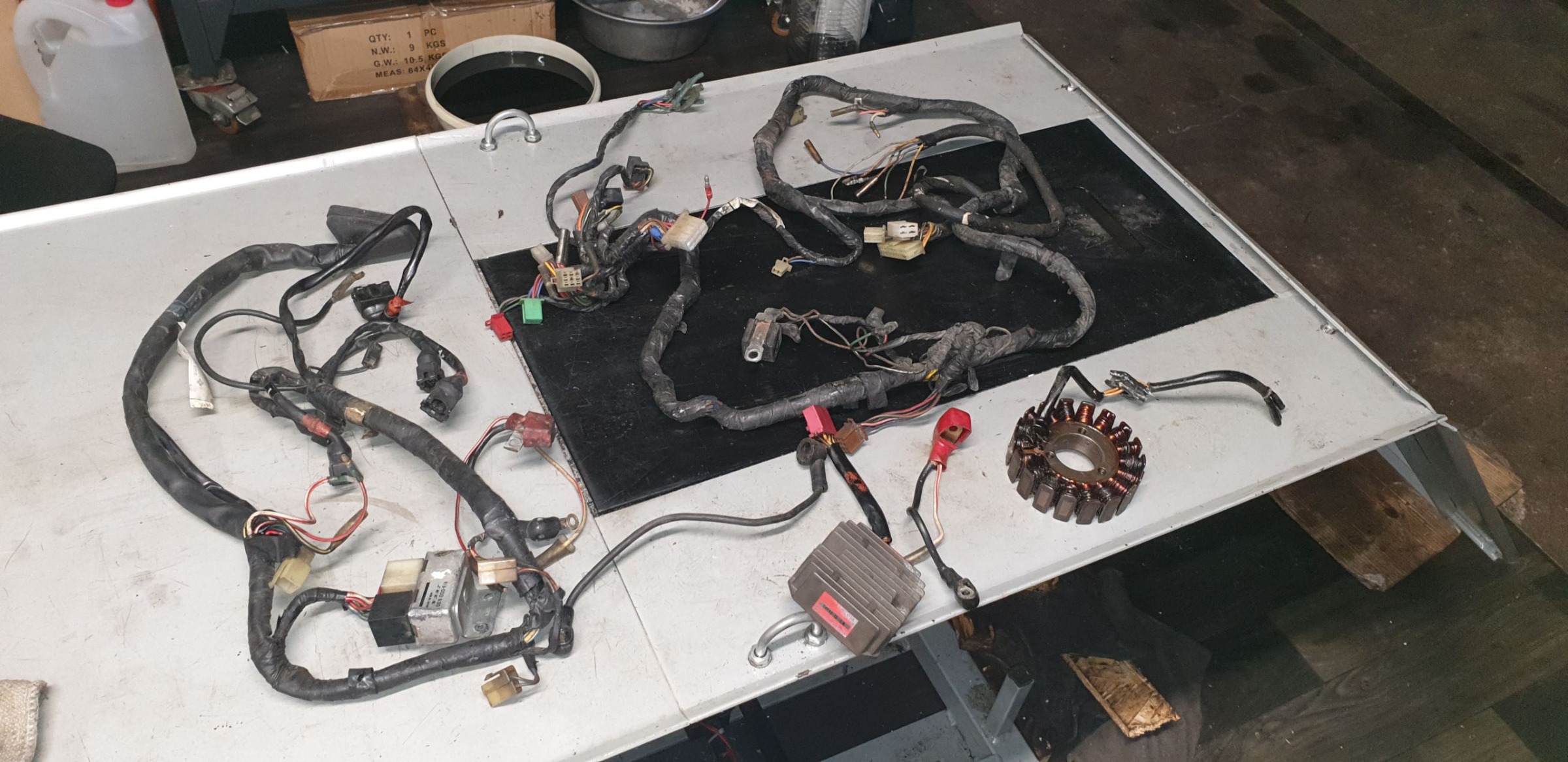

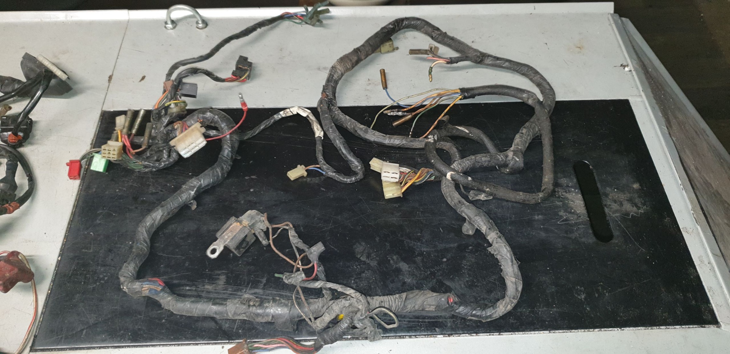

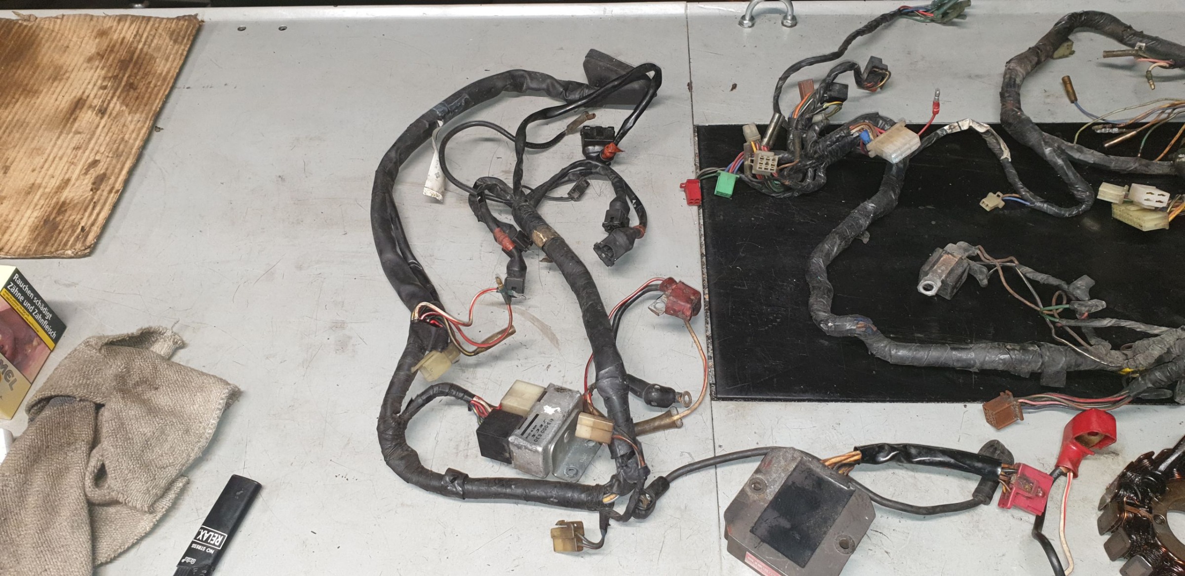

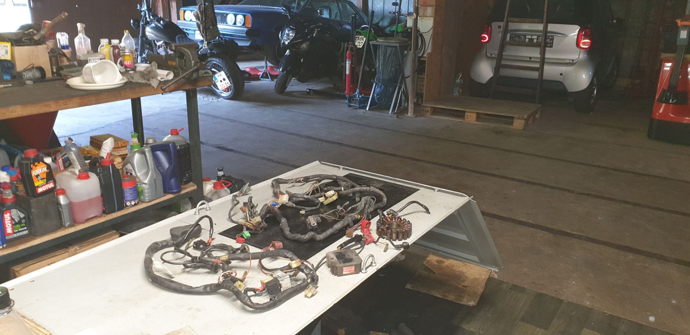

19 Jun 2024 12:54 - 19 Jun 2024 13:06So here is the best wiring loom i can offer. The R/R have one molten spate connector but should work and the stator looks like is shorted/burned insulation (both parts for free).Top man, that would be fantastic!
- I saw some earlier posts on another model about reg/rec, OEM is stupid money and i gues old technology, what are the recomendations for a modern replacement reg/rec?
- And the biggest problem, anyone know where I can source a replacement main loom or get one cost effectively made?
Any help appreciated
Adrian
London
Give me some days, i know i have several spare GPZ 1100 wiring looms and R/R´s in my shed.
Asking 50 € plus 16 € shipping to London.
Last edit: 19 Jun 2024 13:06 by Scirocco.

19 Jun 2024 13:25 - 20 Jun 2024 03:03Hi Scirocco, really appreciate you taking time to send pics, thanks so much! Seems to be a lot of differences between your loom and mine, I think it would require a bit of work to make it fit so Im going to first try to repair mine.So here is the best wiring loom i can offer. The R/R have one molten spate connector but should work and the stator looks like is shorted/burned insulation (both parts for free).Top man, that would be fantastic!
Adrian
London
My bike is a UK 1981 gpz1100b1 so not sure if yours came from a different market/model, I think I saw on cmsnl parts list there were 2 different looms - 260011354 and 260011366
Ill come back to you if it doesnt work out!
BTW, would you have an ignition lock for sale?
1981 GPZ1100b1, 1980 CB750Fa, 1981 RD350LC, 1980 DT175mx, 1982 GS550ez
Last edit: 20 Jun 2024 03:03 by ajh.
