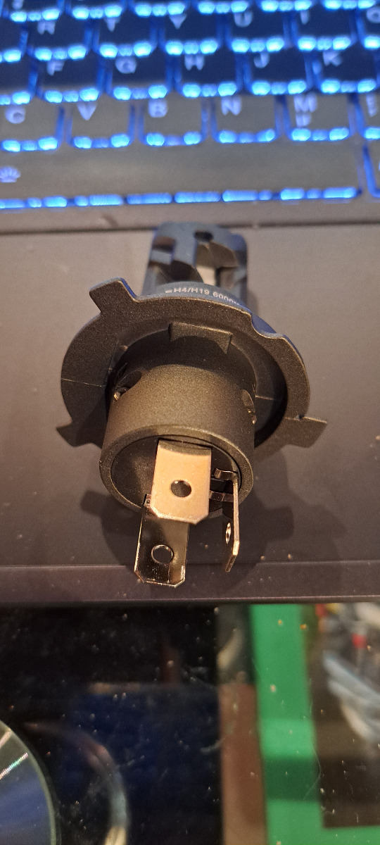

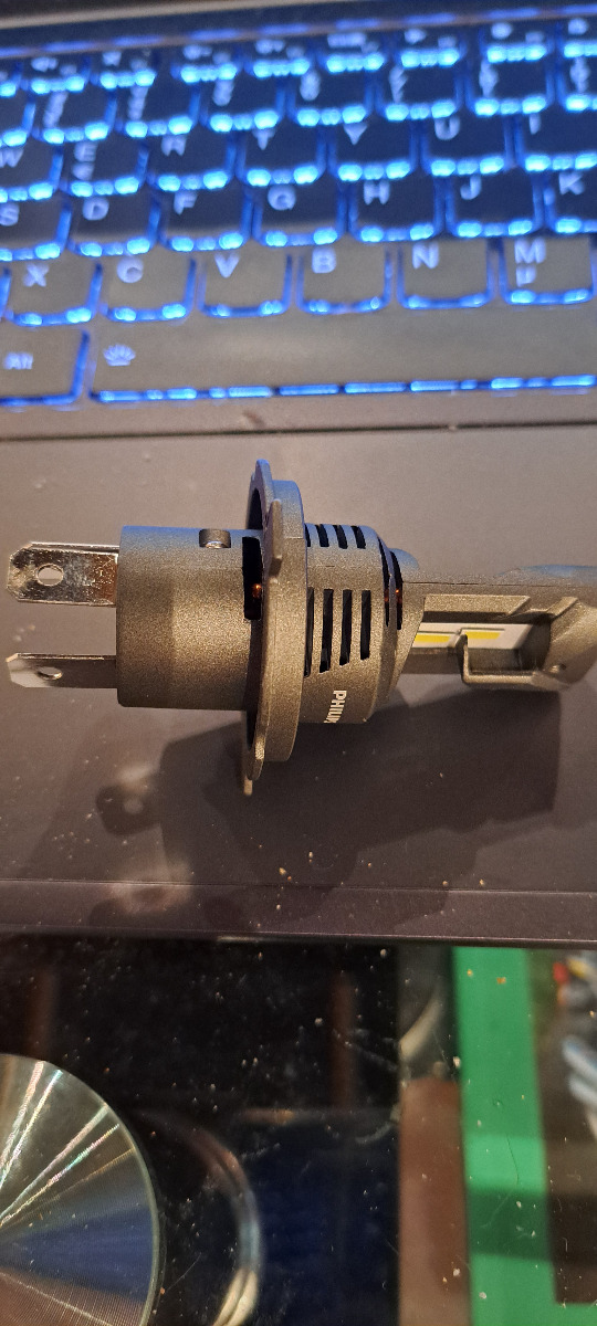

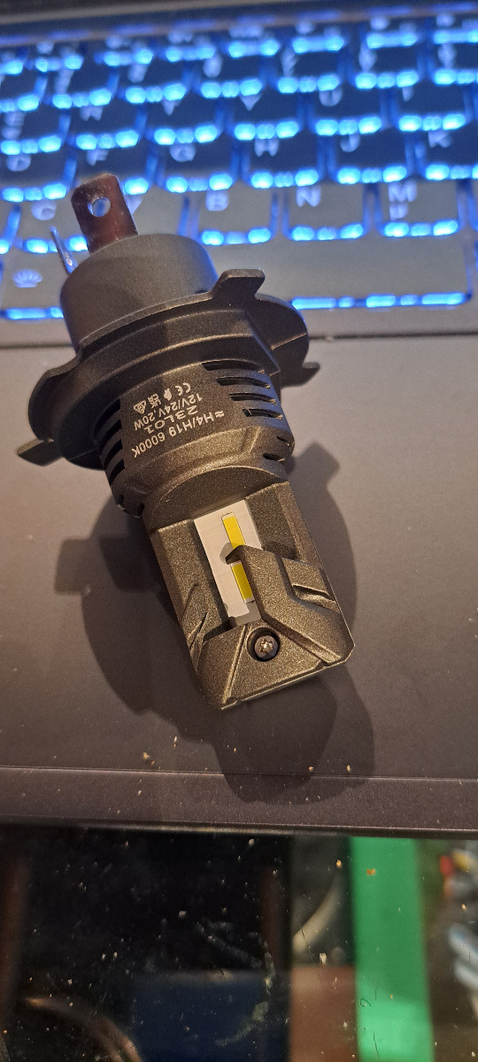

I have bought this led h4 bulb ,but not sure if its safe to install that and if it even fits or will work ?

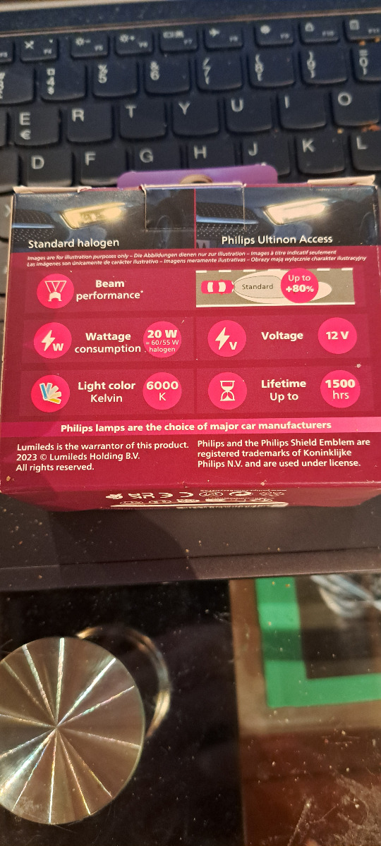

It only uses 20W so it will be perfectly fine. except for what was said about the high beam, but even then that may not be an issue.

The 2023 / 2024 Philips catalog is linked below:
www.philips.com/c-dam/b2c/en_GB/marketin...EN-EN_EMEA_23-24.pdf
Philips own catalog lists the Ultinon Access bulb in the 'LED off-road' section per page 3.
On pg.8 they list 'LED road-legal' bulbs. Note the beam shape & striping on the paved roadway. At the bottom left of pg.8 there's a blue road icon with a check mark, indicating road legal.
On pg.18 we see the Ultinon Access bulb in the automotive section. Note the beam shape & no striping on the dirt road (off road). Bottom left of the page is the roadway icon grayed out with an 'x', as may not be road legal. User is responsible for ensuring legality in their jurisdiction. Same things on pg. 24 specific to the Ultinon.
On pg.76 we see the Philips motorcycle bulbs, all of which appear to be halogen. Note the different beam patterns vs automotive beams noted above. Also, note the striped roadways (on-road).
Will the Ultinon bulb 'fit'? Probably. Will it 'work'? It probably will illuminate. Will glare from what may well be a resulting poorly-focused & incorrectly-shaped beam pattern blind oncoming drivers? Very possible. Will said beam pattern result in fewer lumens on target down the road where it's needed? Very likely.

Okay thank you for lots of info guys. I have been in the garage doing some work on the bike and installed the bulb to test it. The reason i bought it was that i have very little light coming out of the headlight it is yellow and dim.I guess it is a combination of old wiring and maybe old bulb to.
I was in a store yesterday to buy some other things and dicovered the led h4 bulb and thinked.. okay so now its possible to just install a led h4 bulb with no other mods so i bought the bulb.

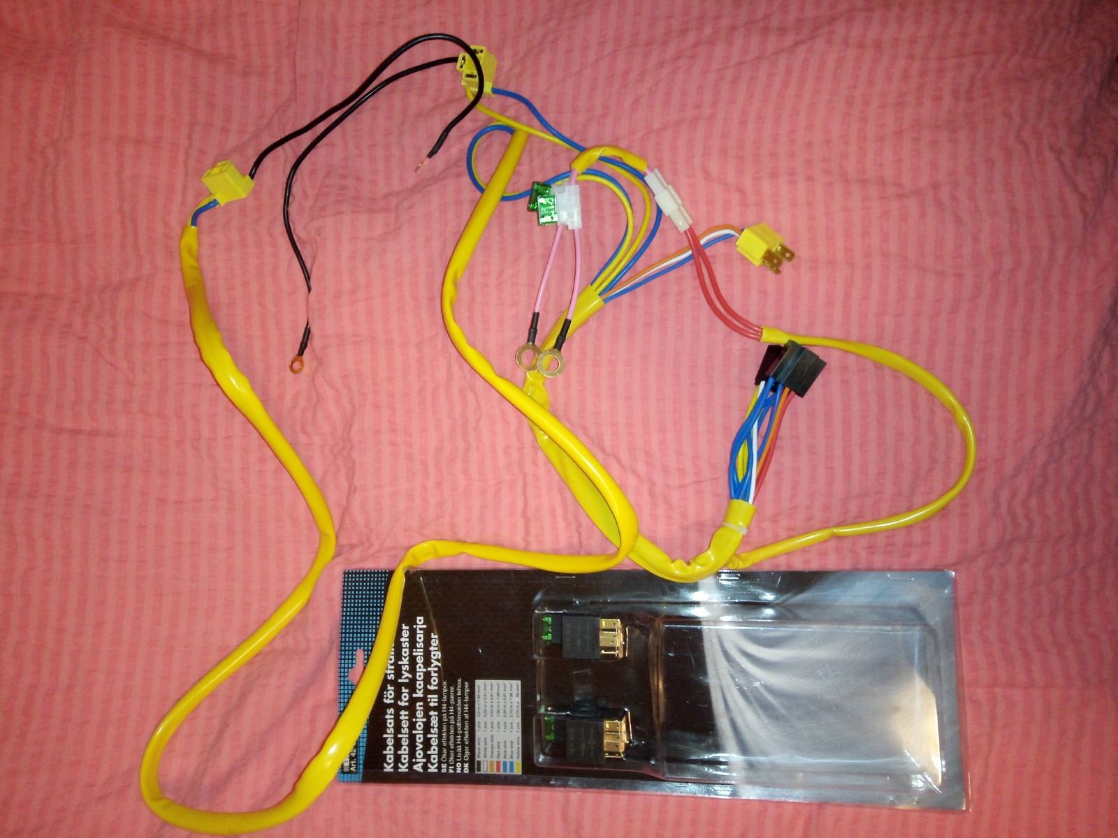

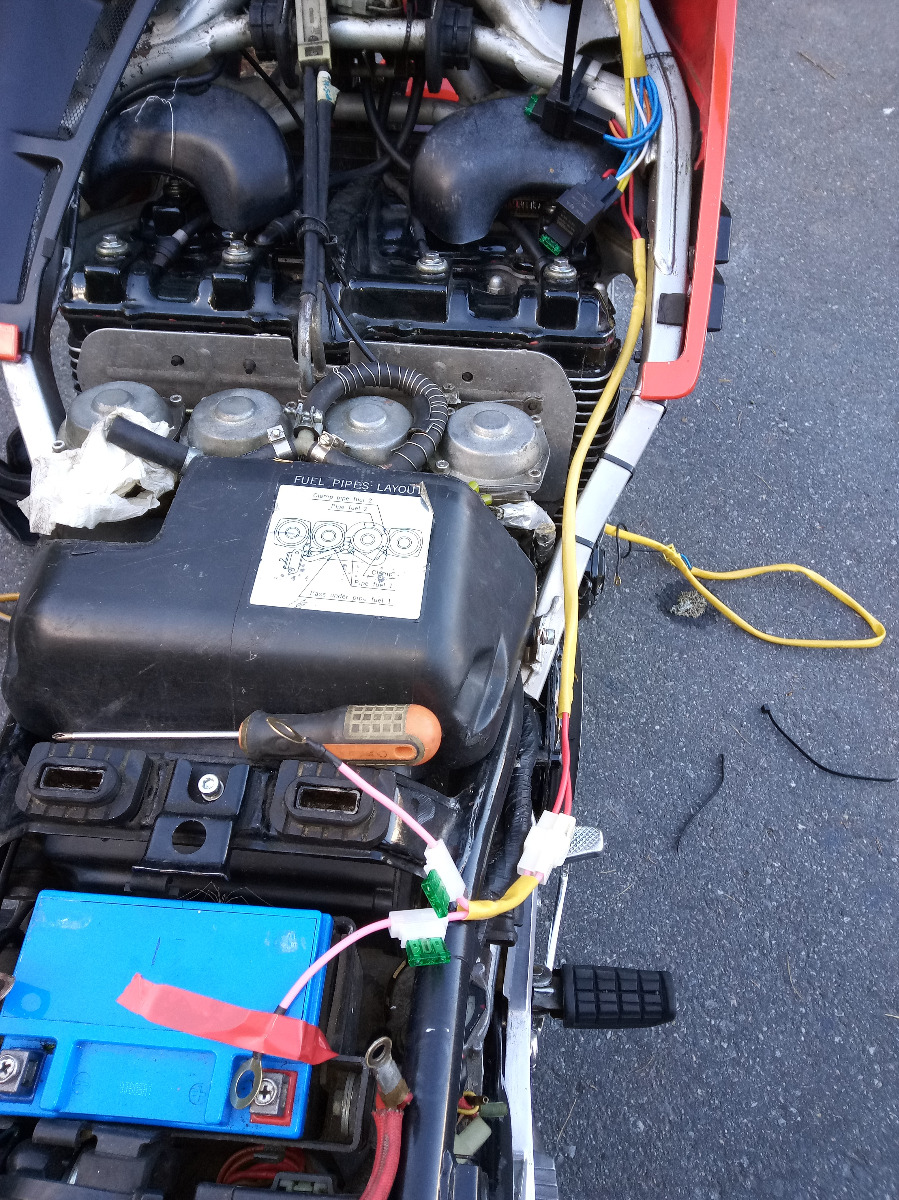

On my fj1200 that also had weak headlight i installed a headlight relay kit and installed a ceramic bulbholder and h4100w bulb. That made a big difference in light power. I rememer reading a lot of test what was the best H4 bulb back in 2020 and it was the one in picture below. I have been thinking of doing the same on the kwaka and that would also give a relaymod for the coils in the same time because the light enchanchement kit / relays ifs for cars and have 2 outputs one for each headlight.One problem on the kawa is that the bulb sits inside the bucket and a stronger bulb gets to hot
I dont like so many non oem wiring mods on the kz900 so i think just changing the bulb for a LED is maybe better.
I changed the bulb today in the garage and it was i very big difference in power and brightness on the wall infront of bike.
I will ride with a little and see if the oncoming cars blink their lights to tell me they are blinded. It has both low and highbeam and when looking at the wall in the garage it made a sharp line same height as the H4 halogen .Will do some driving and see if the cars will react to the light.

Rolf I would advise against the 100w bulb option, that would draw 9 amps + 4-6 amps for your coils + the rest of the electrical system. I couldn't see a spec in the manual but I guess the total output of the charging system is probably around 18 amps so you will be running a 40 year old generator
"flat out" all the time the headlight is on (even the low beam at 80w is drawing 7 amps) the stock headlamp at 60w draws around 5 amps !!

07 May 2024 15:05 - 07 May 2024 15:10Thanks for adwice wookieRolf I would advise against the 100w bulb option, that would draw 9 amps + 4-6 amps for your coils + the rest of the electrical system. I couldn't see a spec in the manual but I guess the total output of the charging system is probably around 18 amps so you will be running a 40 year old generator
Yes i wont be using a 100w bulb if i install the relay mod on the kawasaki.The 100w get extremely hot and may melt the wiring inside the
headlamp bucket .so on the kawa i will use a bulb like you suggested if i do that mod. On the FJ the setup using a 100/80w bulb has worked fine for 4 years.The reflector does not get damaged either ,but it is no wiring near the bulb and more ventilation in the fj headlight.
And i forgot to warn other temted to install a 100w bulb without doing a relay mod .What happens the is that the wiring can catch on fire if the fuse dont burn out at least the wires get very hot if they are not big enough
