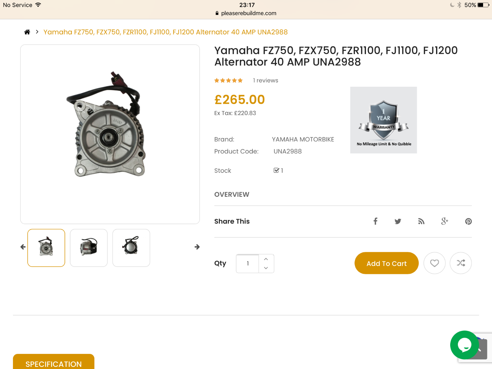

The below is listed for 86 - 96 FJ1100 and FJ1200. The alternator is rated at 40amps which is why you have had no problem running a 100w bulb

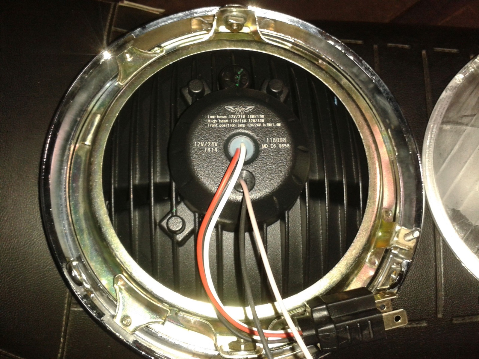

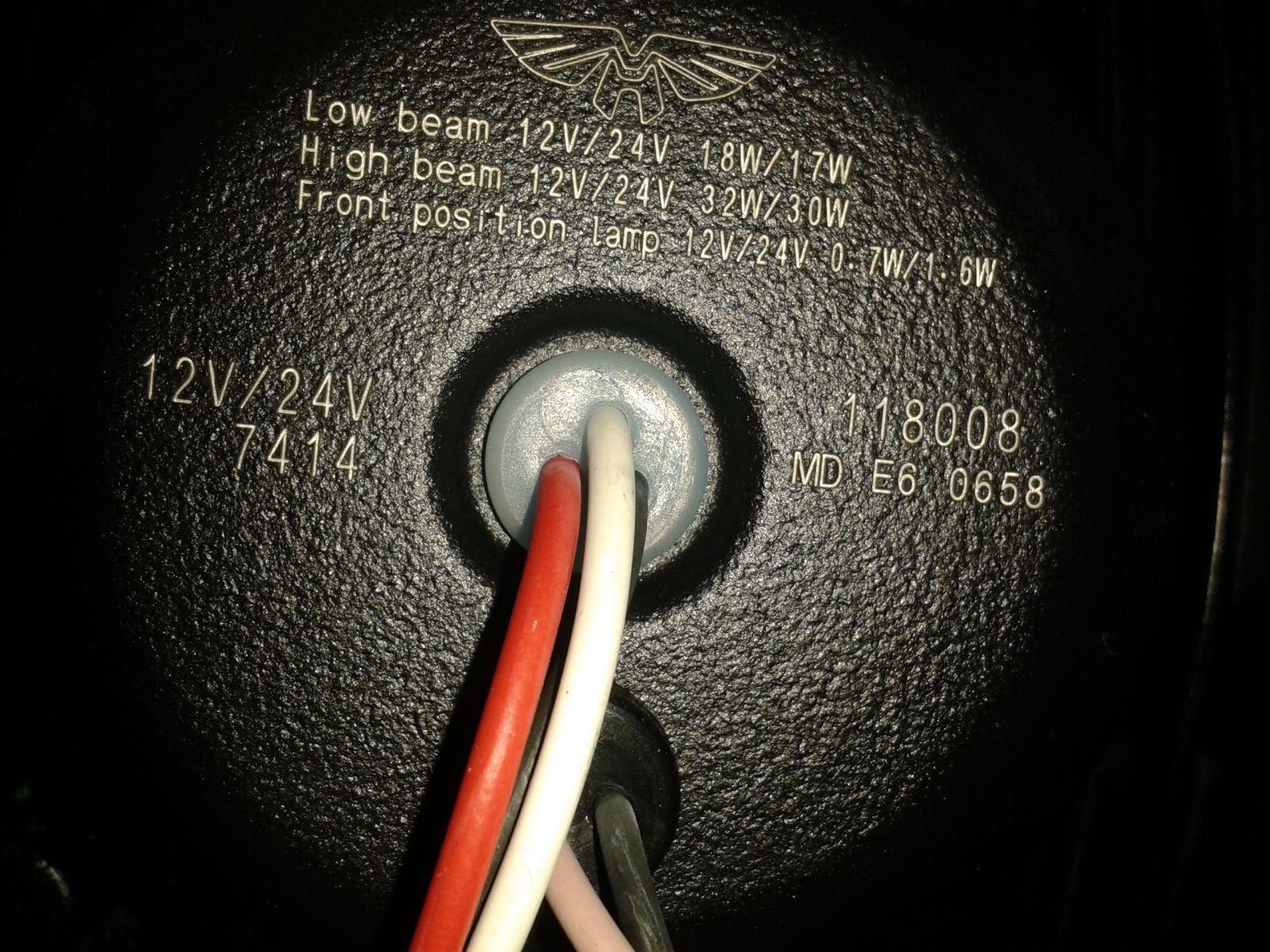

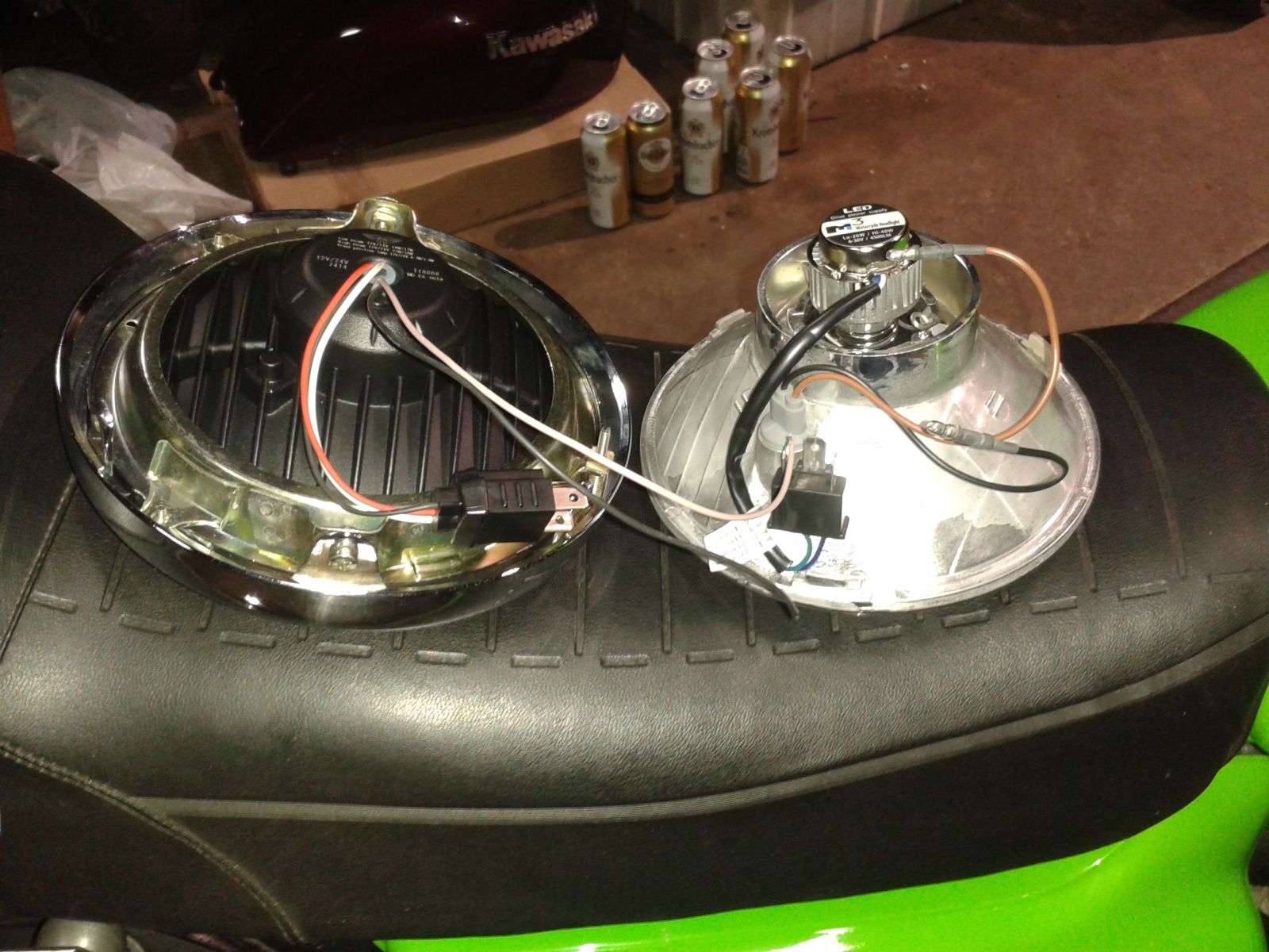

Don´t waste your money on an expencive LED bulb.
You can get a new street legal plug & play 7" LED head light insert for 99 Euros.(LOUIS special offer)!!!

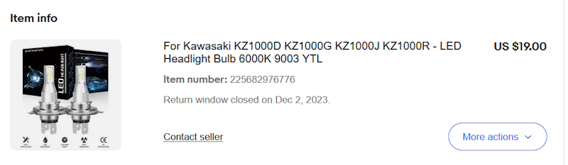

I bought these, after seeing very aggressive marketing on Ebay:
The marketing grabbed my attention, and I fell for it
All I can say is: "Absolutely PATHETIC" and "worthless rubbish"
There is NO difference in output light pattern, between low and high beams: just dim and very dim !!!
If you look closely at a proper halogen H4 bulb, the fillaments are in different positions, so that the focal point of the light output, will be significantly different, low / high beam.
So, when assessing an LED headlight bulb, at least, the LED "chips" for High / Low beam should be in different focal positions!
Anyhow, as is comon practice on Ebay, rating an item, and the seller, helps others to make informed buying decissions.
I rated the item as ONE out of 5 stars (there isn't an option for 0 out of five stars), and that I was NOT pleased with the transaction.
The seller immediately offered a FULL refund, and did not even require me to return the items, PROVIDED that I remove my ONE star rating.
I refused, hoping it would help others...
Ebay subsequently refunded me anyway, and that specific seller is no longer active, and, I see that these LED bulbs are no longer being sold on Ebay.

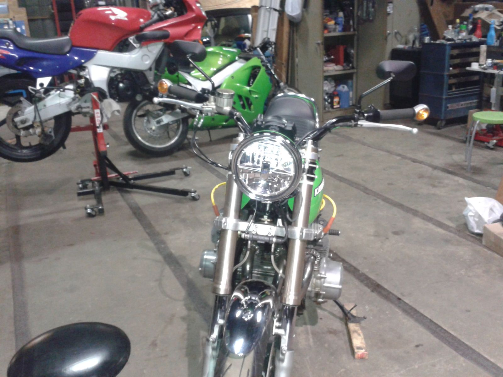

08 May 2024 03:37Would like to see before & after pics of the beam patterns on the wall.... I changed the bulb today in the garage and it was i very big difference in power and brightness on the wall infront of bike. ...

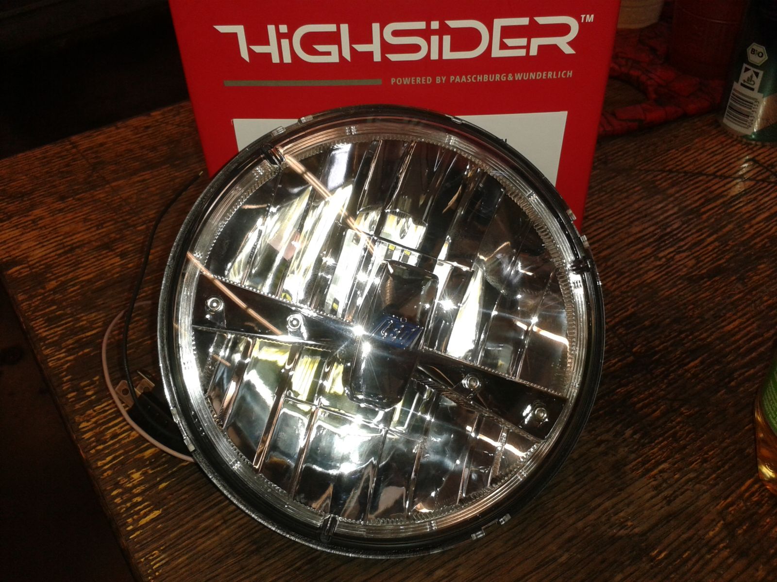

- Rolf1976_KZ900
- Posts: 498
- Thanks: 261
Re: Installing a LED H4 bulb will it fit/work??
08 May 2024 05:22I think that setup is going to make good light .Strange name on it highside not what i want when riding.

08 May 2024 05:39
slmjim is a Technician not only by trade (retired), but also by temperament. There will always be an ask
Appreciate the response, but still undecided.
Difficult to ascertain beam pattern with that target background & close distance. Standard beam aiming / pattern testing in the US is 25 ft. on a blank wall.
