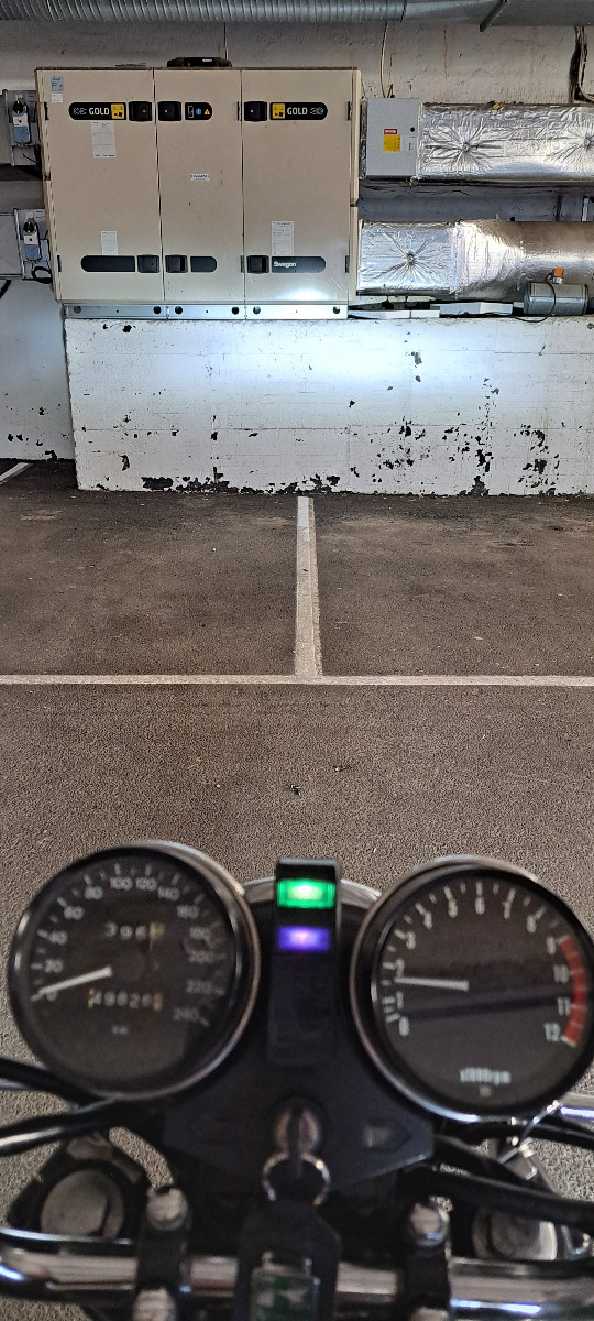

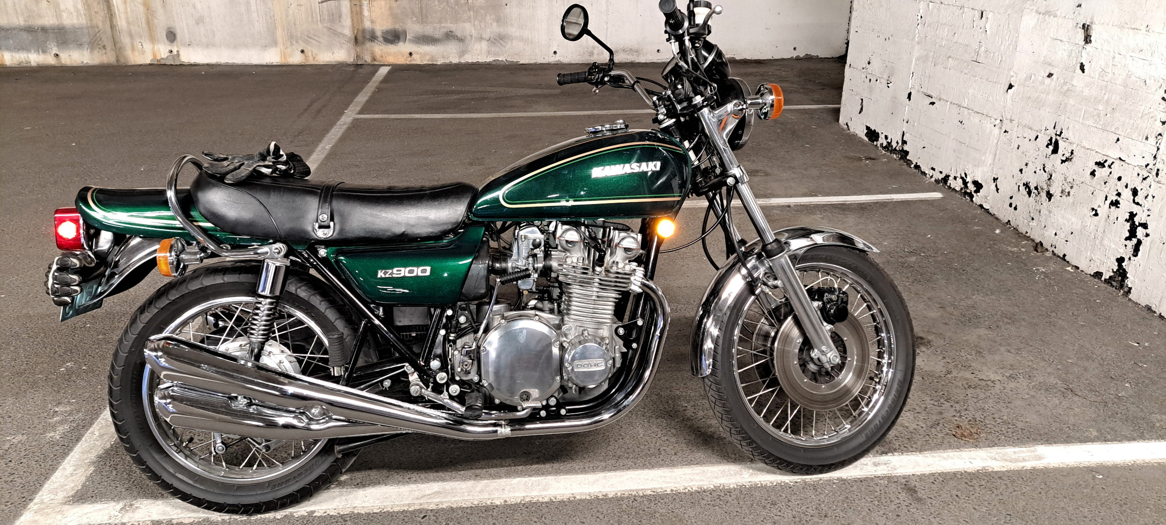

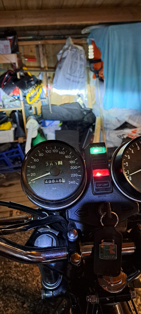

08 May 2024 05:49Not sure what happened when i tried to edit the post so i post again from my messy garageWould like to see before & after pics of the beam patterns on the wall.... I changed the bulb today in the garage and it was i very big difference in power and brightness on the wall infront of bike. ...

09 May 2024 05:14Still too close & distracting background. Can't see left side beam cutoff that would keep oncoming drivers protected from glare.. Try riding at night & evaluate beam distance & oncoming traffic behavior.Not sure what happened when i tried to edit the post so i post again from my messy garageWould like to see before & after pics of the beam patterns on the wall.... I changed the bulb today in the garage and it was i very big difference in power and brightness on the wall infront of bike. ...

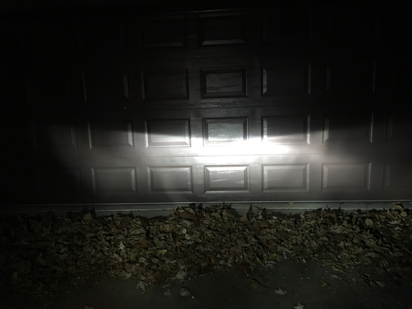

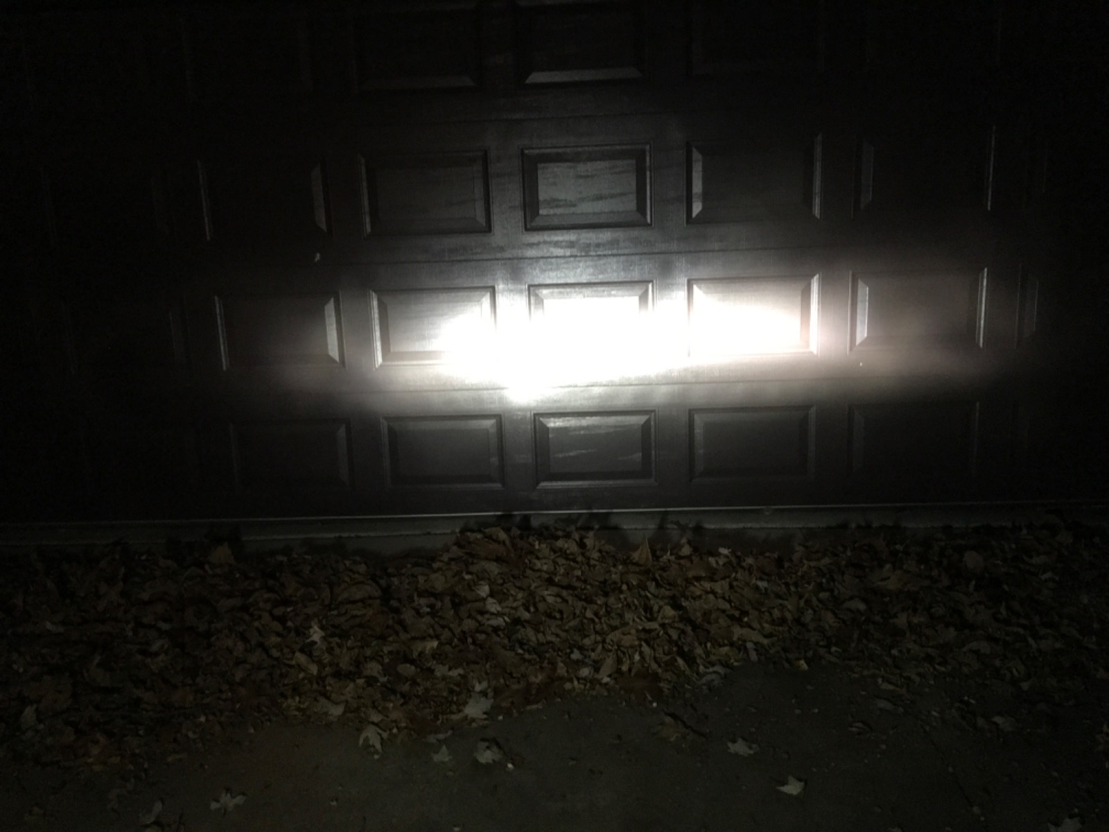

I swapped in all LED’s about 5 years ago including a new H4 headlight housing into my 1978 B2. I bought the housing/shell from Redline cycle (now closed) that had removed all branding from the packaging, so I can’t relay any information on the brand. It cast a clean cutoff line on low beam and a concentrated hot spot on high beam. These pictures were taken using the standardized 25’ distance on a flat wall. This is the type of picture Slmjim is talking about. Sure wish I had kept the packaging the shell came in.

10 May 2024 06:05Yes indeed! Thanks for the pics. Those are good MC headlight beam patterns.I swapped in all LED’s about 5 years ago including a new H4 headlight housing into my 1978 B2. I bought the housing/shell from Redline cycle (now closed) that had removed all branding from the packaging, so I can’t relay any information on the brand. It cast a clean cutoff line on low beam and a concentrated hot spot on high beam. These pictures were taken using the standardized 25’ distance on a flat wall. This is the type of picture Slmjim is talking about. Sure wish I had kept the packaging the shell came in.
Appears high beam is the top pic, low beam the bottom pic. As you say, high beam displays a good centered hot spot, and the rise on both sides illuminate both sides of the path forward very well. The low beam pic illustrates the sharp left cutoff that protects oncoming traffic from being blinded. It also illustrates the rise at the low beam's right side illuminates the right shoulder / curb area farther forward.
Curiosity questions:
Is the word 'motorcycle' cast into the lens?
When looking straight on at the front of lens, is there an asymmetric, sorta pie-shaped portion at about the 9 o'clock position?
CandlePower has produced replacement housings to upgrade from sealed beam units for years. If there's a stylized 'CP' logo in the center of the lens that's what it is.

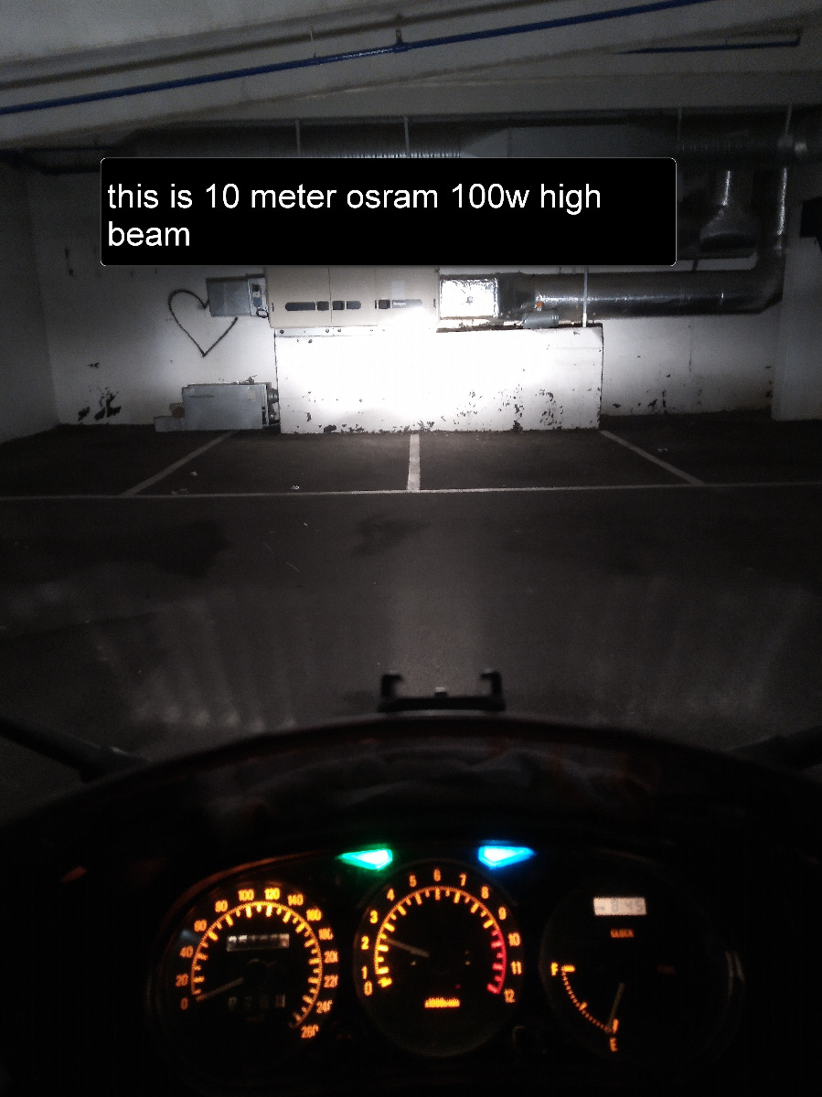

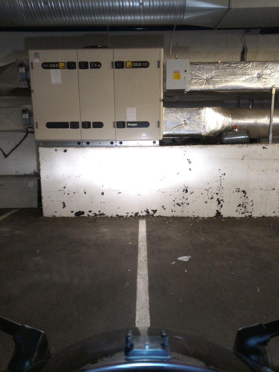

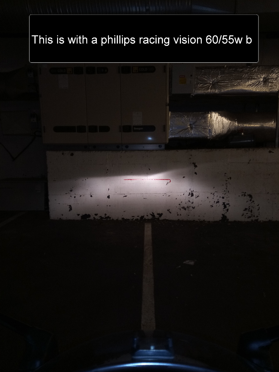

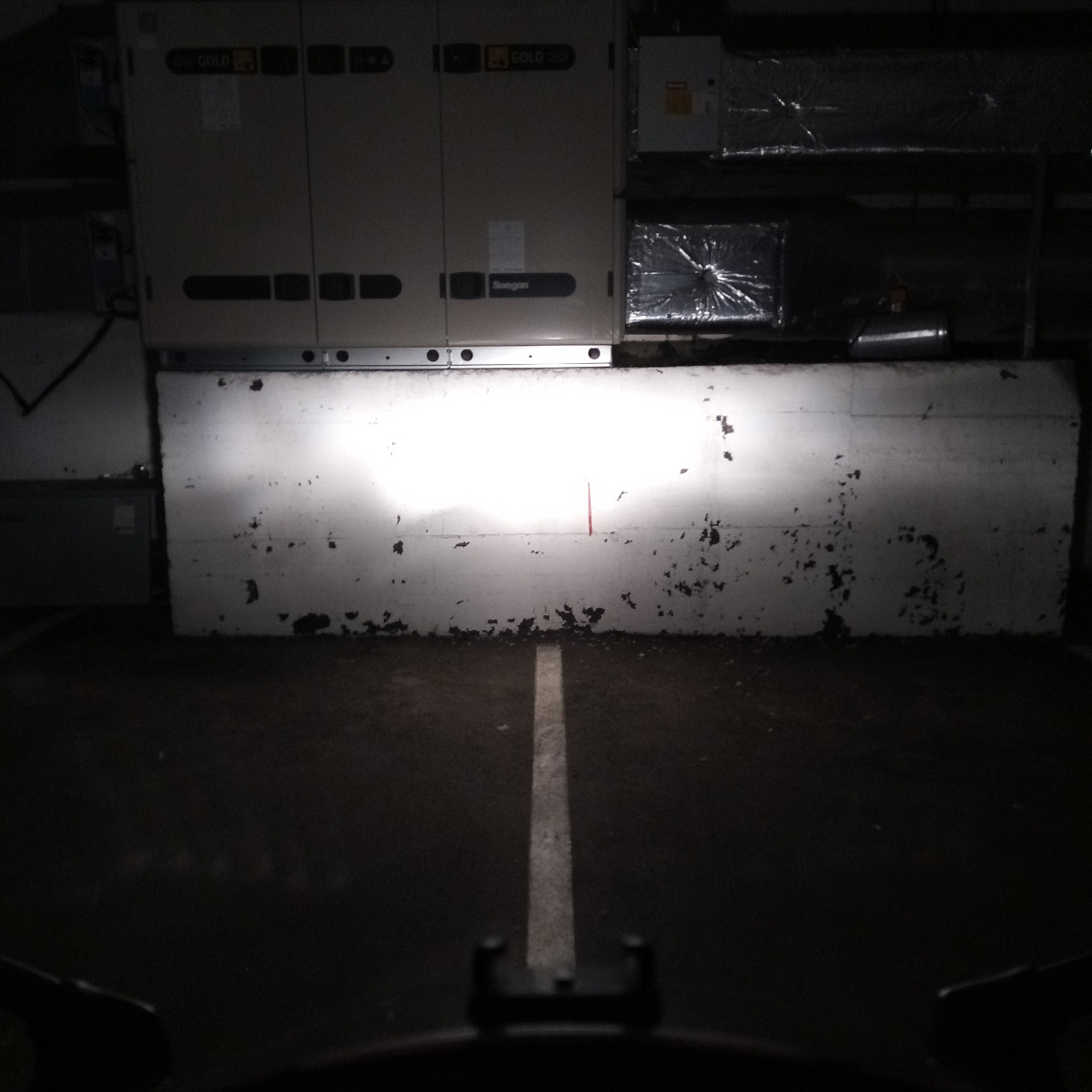

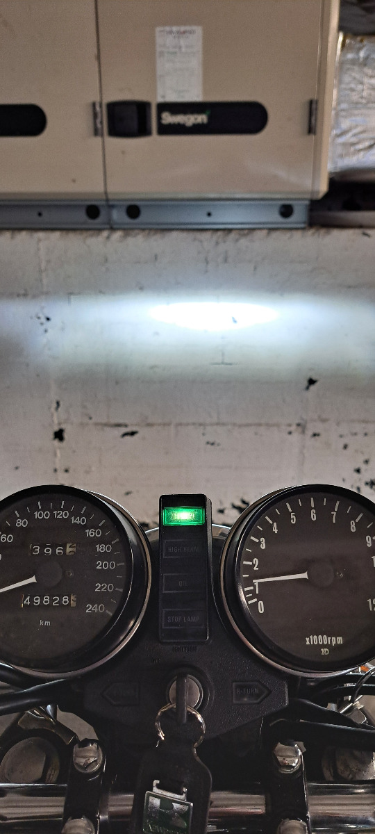

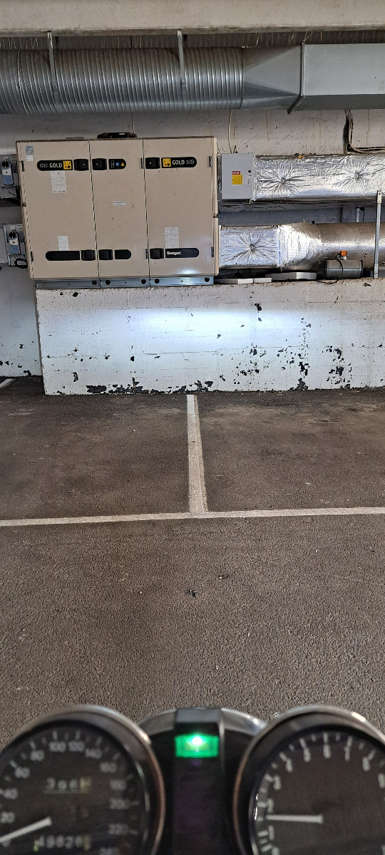

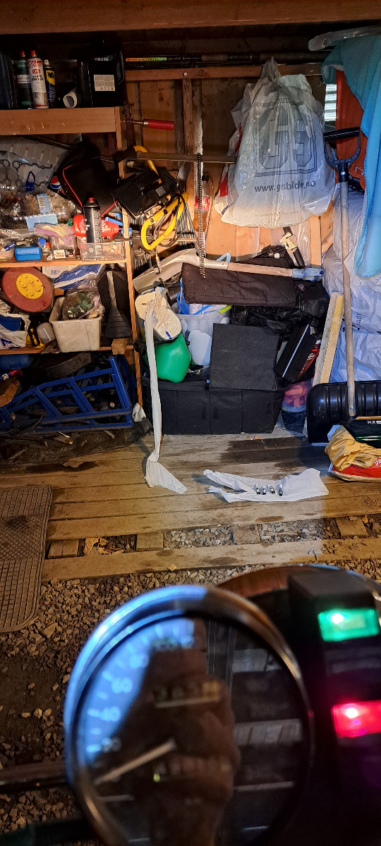

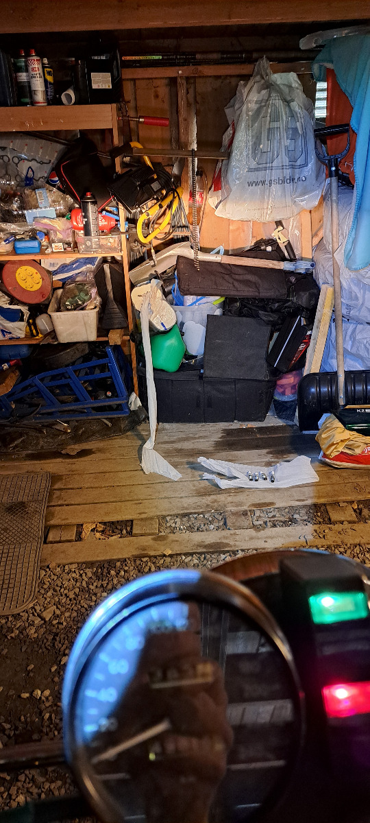

Just a couple of more pics from how the bulb lights up a wall. I have done some thest at this place back in 2020 with the fj1200 and the pencil marks was still on the wall
. Im not so impressed by the bulb and the lowbeam is not right .The topline of the lowbeam should go down on the left side of center so it is not blinding the oncoming cars. It does dip down on the left side with a regular bulb. Not impressed with the power of the light either when driving but have not been riding in very dark conditions yet. It is bright but not sure if its stronger than a good ordinary bulb. I will try to buy a better ordinary bulb and test.The test here is done in almost daylight.
. Im not so impressed by the bulb and the lowbeam is not right .The topline of the lowbeam should go down on the left side of center so it is not blinding the oncoming cars. It does dip down on the left side with a regular bulb. Not impressed with the power of the light either when driving but have not been riding in very dark conditions yet. It is bright but not sure if its stronger than a good ordinary bulb. I will try to buy a better ordinary bulb and test.The test here is done in almost daylight.Please Log in or Create an account to join the conversation.

10 May 2024 15:02
The following user(s) said Thank You: slmjim+Z1BEBE, Nessism, Rolf1976_KZ900

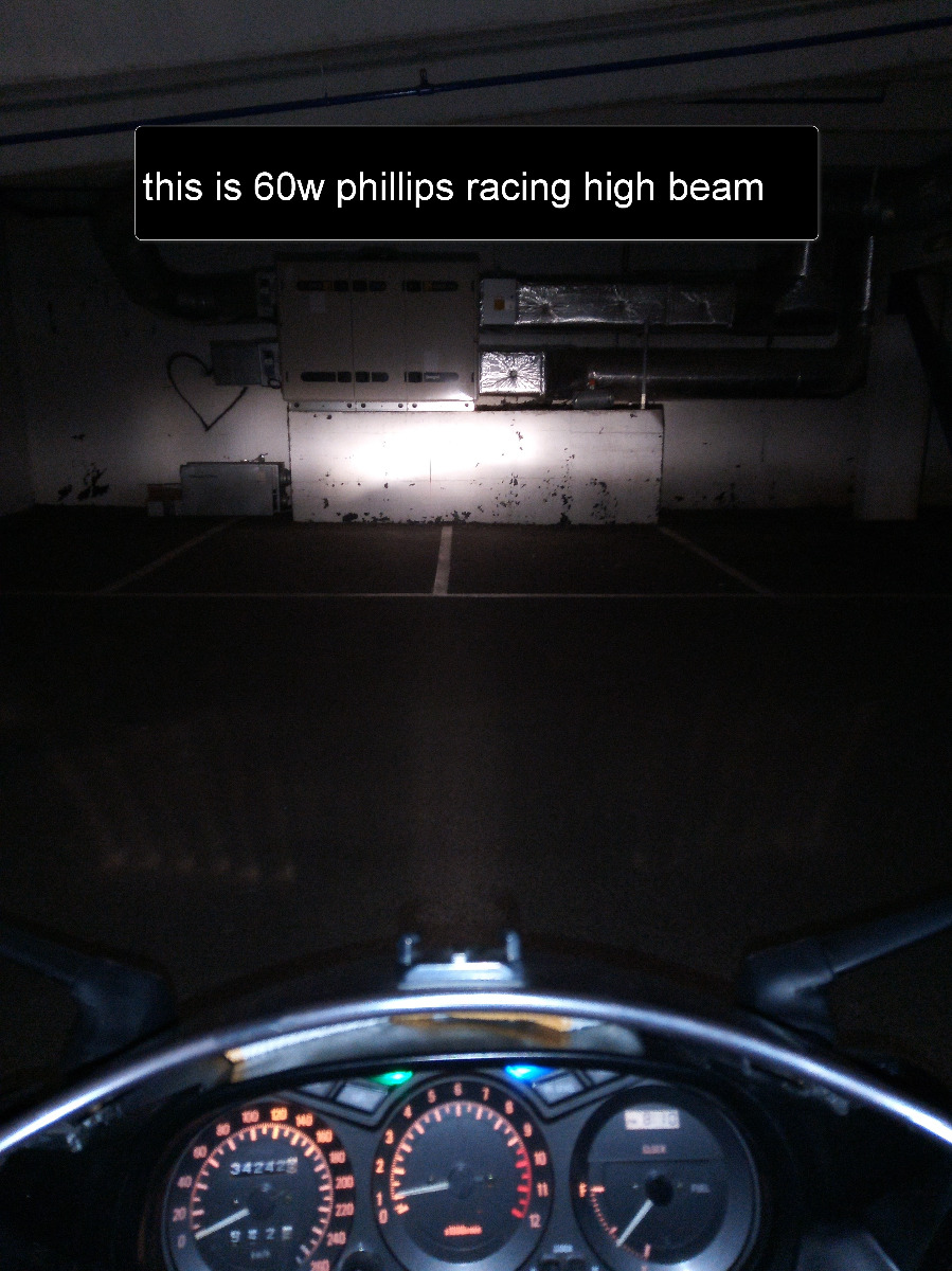

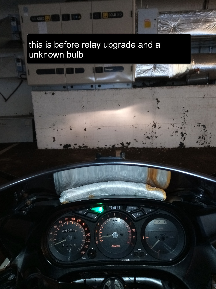

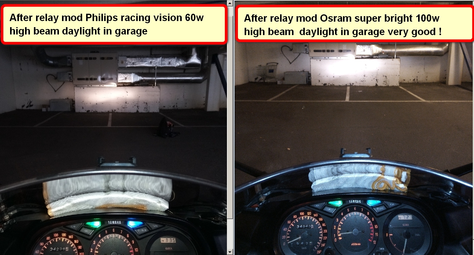

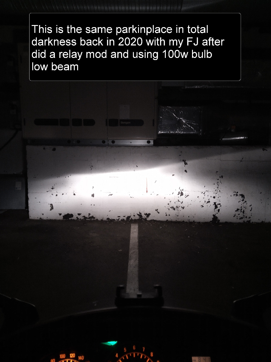

Back in 2020 i did a lot of testing on the fj1200 and marked the wall with tape and compared. here are some pics this is after relaymod exept one pic i think

Certainly gives a nice clear definition on the beam pattern, I think the Phillips (or something similar) is the best option for your KZ as the generator can't support a 100w bulb for very long
