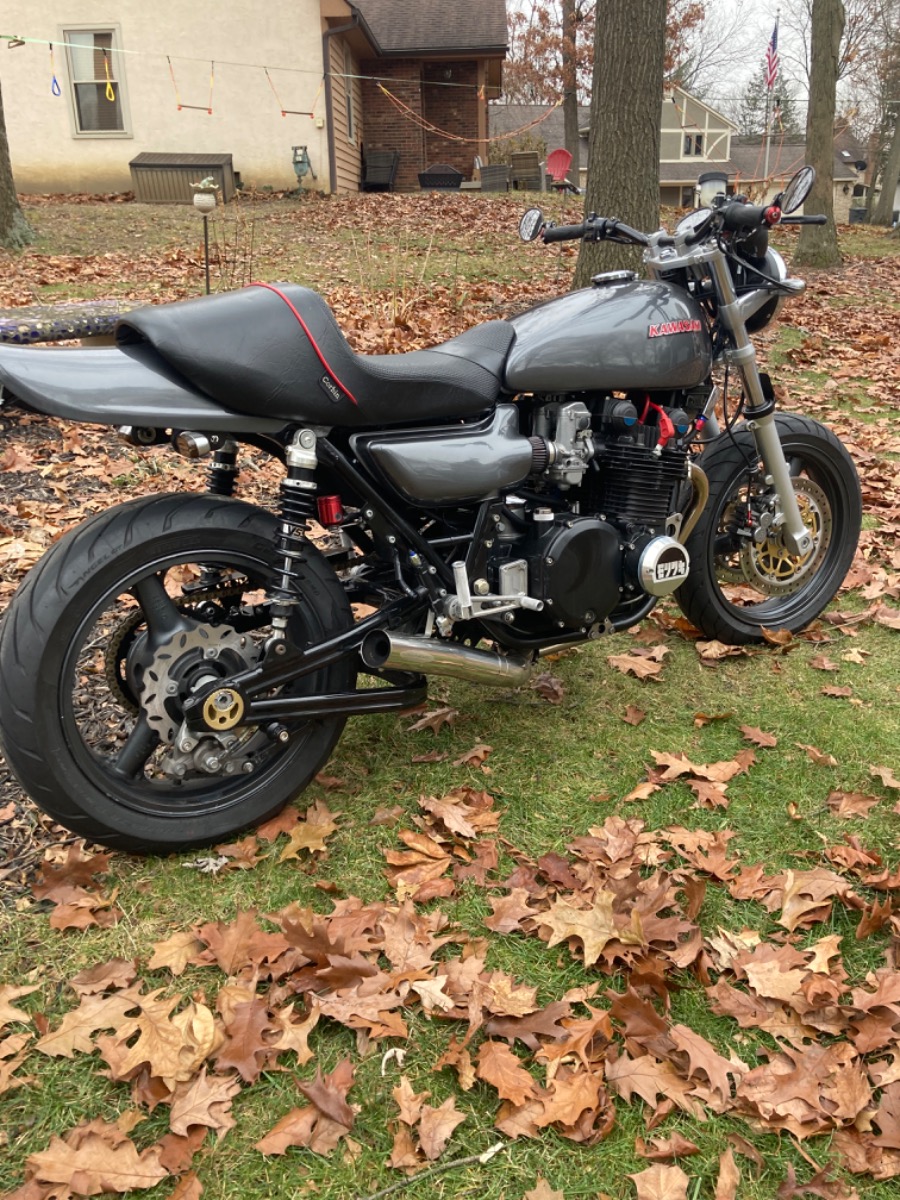

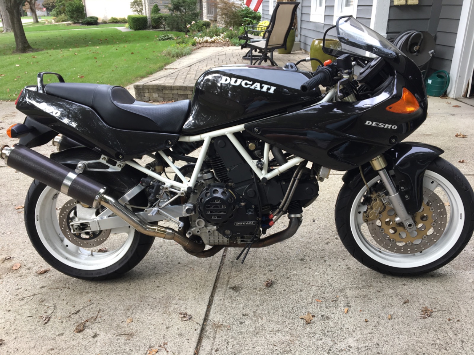

i am keeping the incandescent bulbs on the rear TS for now. I’m anxious to see the new gauge and headlight workout. Been fiddling with this bike one way or another for 50 years now! I’m no engineer or machinist like many of you (very jealous), but I love working on this bike. Between it and my ‘92 Ducati 900ss, I have two great bikes to ride!
