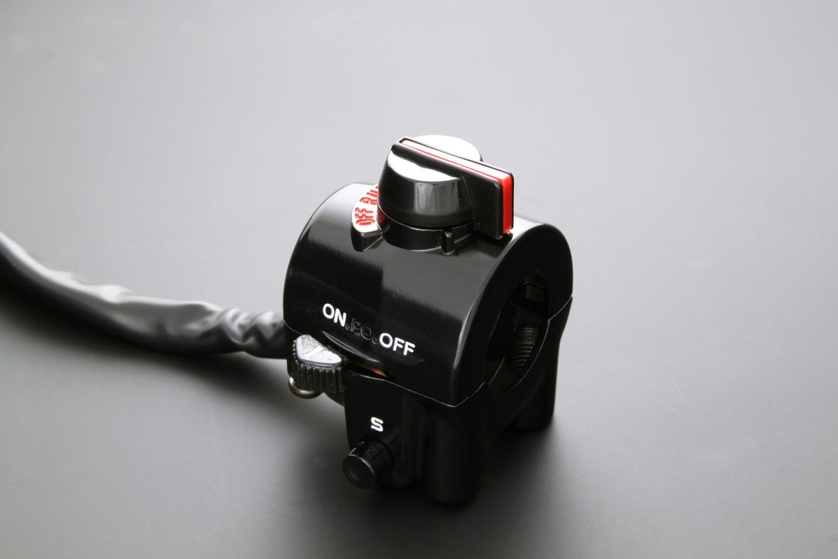

For the Day Running Lights (DRL) you need a RH handle bar switch with an euro style switch (white PO position light switch position).
On the US RH handle bar switch the PO position is blacked out and not connected to the wiring harness.

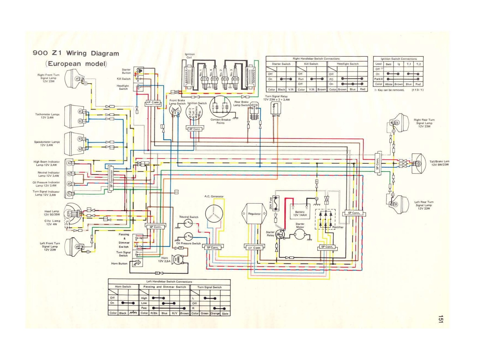

Thanks Scirocco. It so happens that I have the euro style RH switch you show here. Had to replace my original many years ago. Do I just need to tie into the PO wire? According to my schematic the headlight switch has three wires red, blue and brown. The PO position is the red and brown combination.

Thanks again scirocco! Your wiring diagram matches mine, that’s a relief right there! Are you thinking that the headlight DRL wire would tie into the switch red wire? I will do some trial and error work tomorrow.
