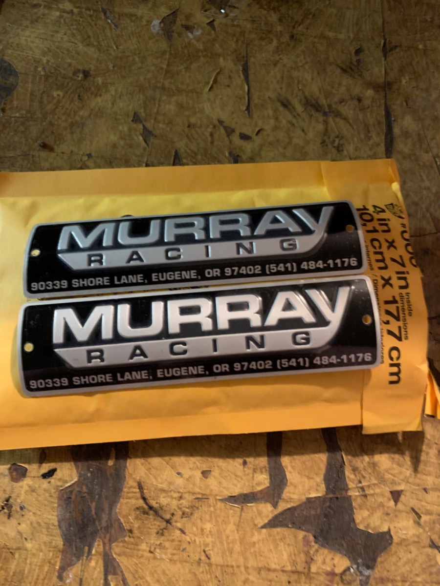

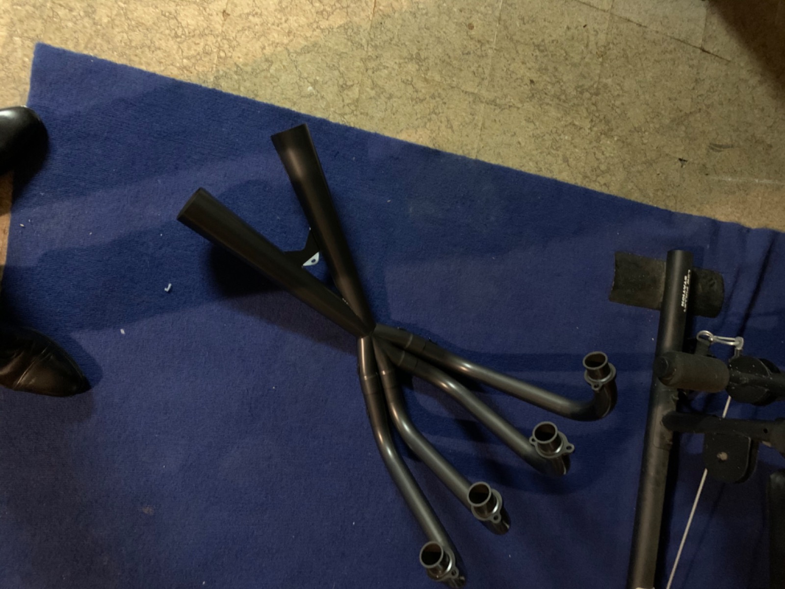

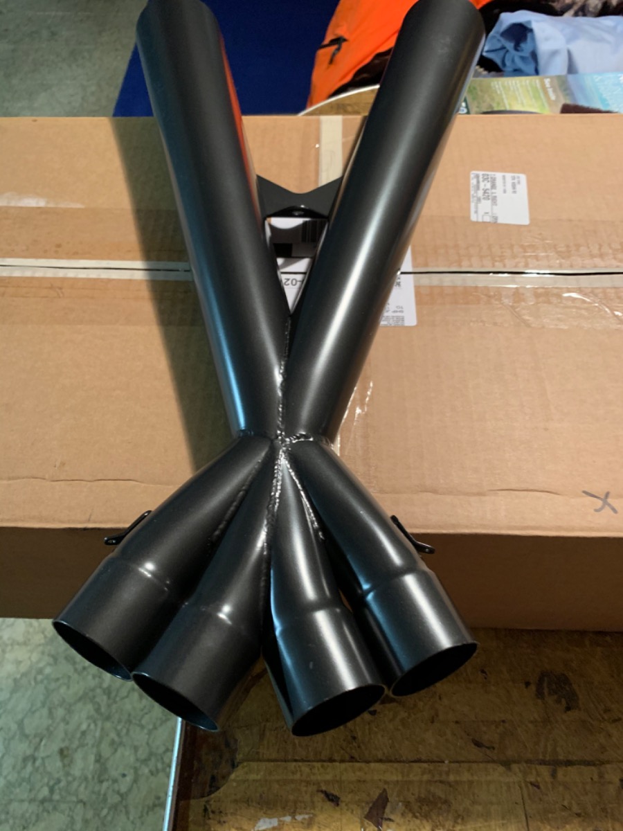

07 Jun 2022 14:56You are kidding me, the X pipe i want next if no Bassani are available. Now i need your pics pleaseand yes I did have Dennis Murray make me one X pipe... long story about that... (kind of surprised I did not get asked about it from the pictures I posted)..

Exhaust Porn… I need a cigarette.

Did Dennis Murry made the X-pipe exclusive for you only or will he made a small batch of pipes for sale?

I had heard the storys about the fact that he would only make a small batch or would not make them at all. I heard storys about he would have to set up all new jigs etc.Honestly I called and got no answer... then I simply emailed him explaining what I wanted. He took two months to answer. Then it took another month. He asked if I wanted his finish on it in black or silver. Next year I will probably send it out to Jet coat and have it finished in there black as his is closer to a very dark gray. I have his spider pipe finished in chrome on my other bike.I have wanted a Murray X pipe forever as a good friend has one on his bike. Unmistakable sound coming down the road. Cant wait to finish this bike.
