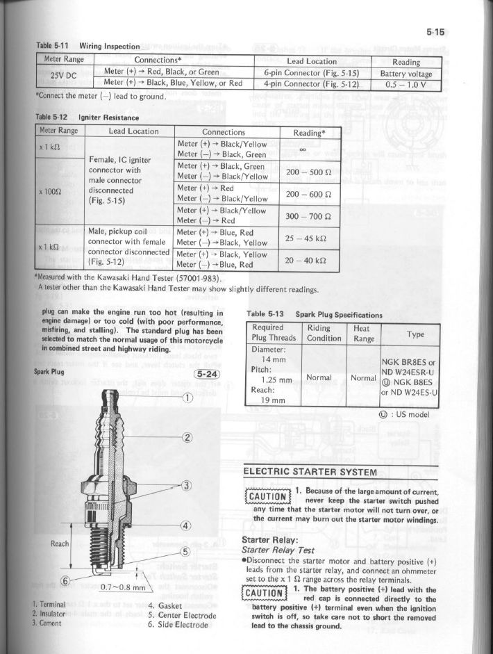

Check the fuses first, next check primary/secondary ignition coils.
The service manual offers a multimeter test for the coils and ic igniter.

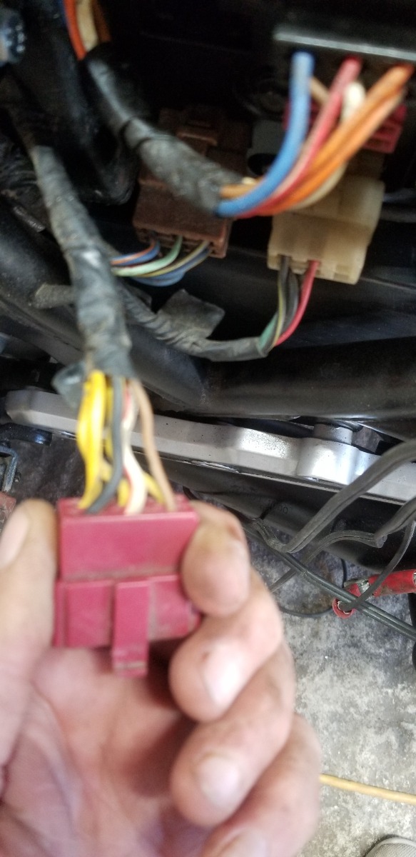

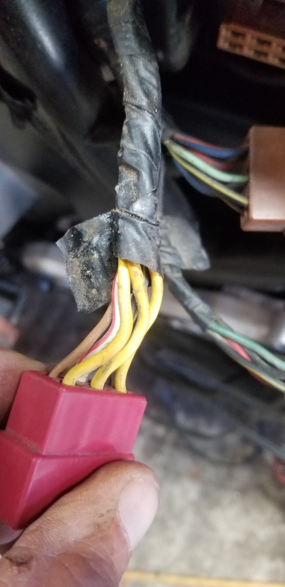

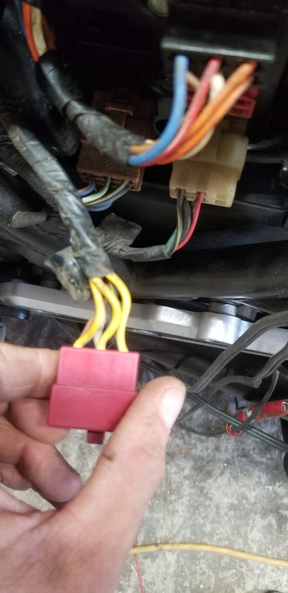

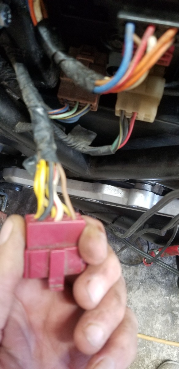

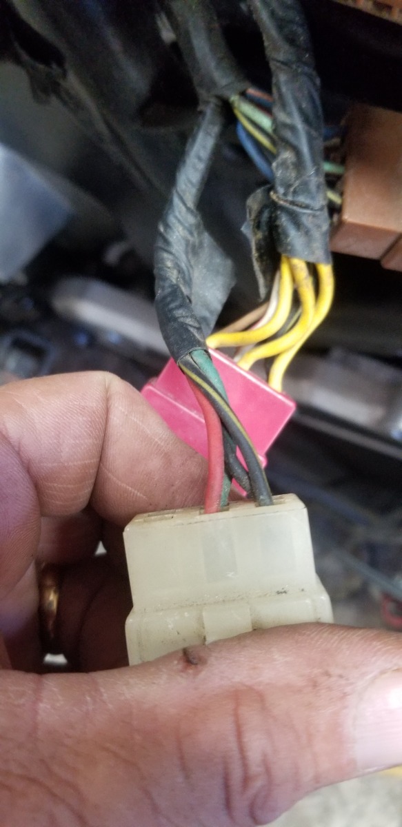

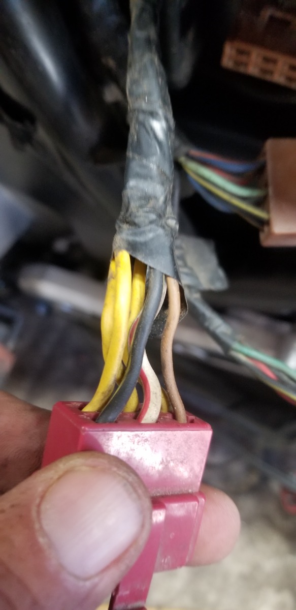

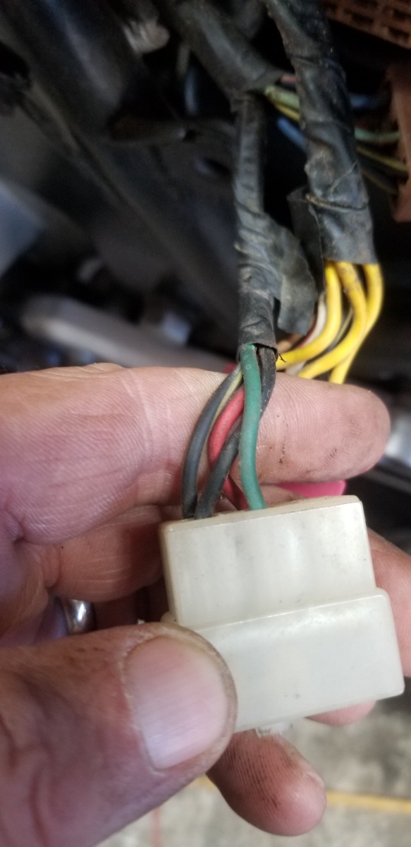

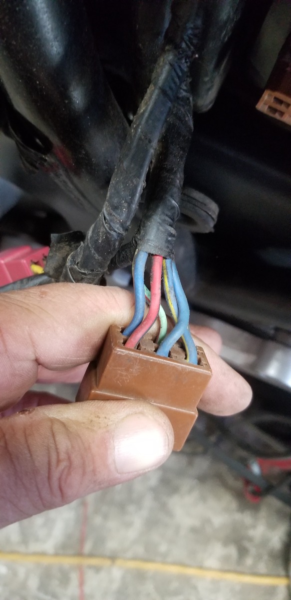

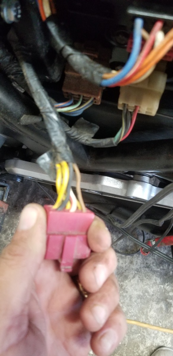

My wire colors don't match the manual mentioned in the igniter test lol. Attached are pictures of the wires.

RED CONNECTOR = Recifier/Regulator Unit
BROWN CONNECTOR = Reserve Lighting Device
WHITE CONNECTOR 6 PIN= IC Igniter to ignition coils (YELLOW/RED, BLACK, GREEN, BLACK/YELLOW)
UNKNOWN COLOR 4 PIN CONNECTOR = IC Igniter to pic up coils (RED, YELLOW, BLUE, BLACK)
Read the manual about the connectors, wire colours....
