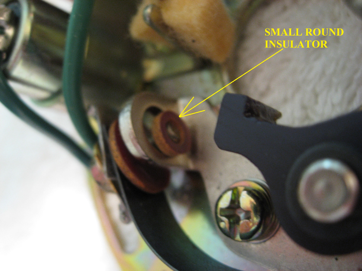

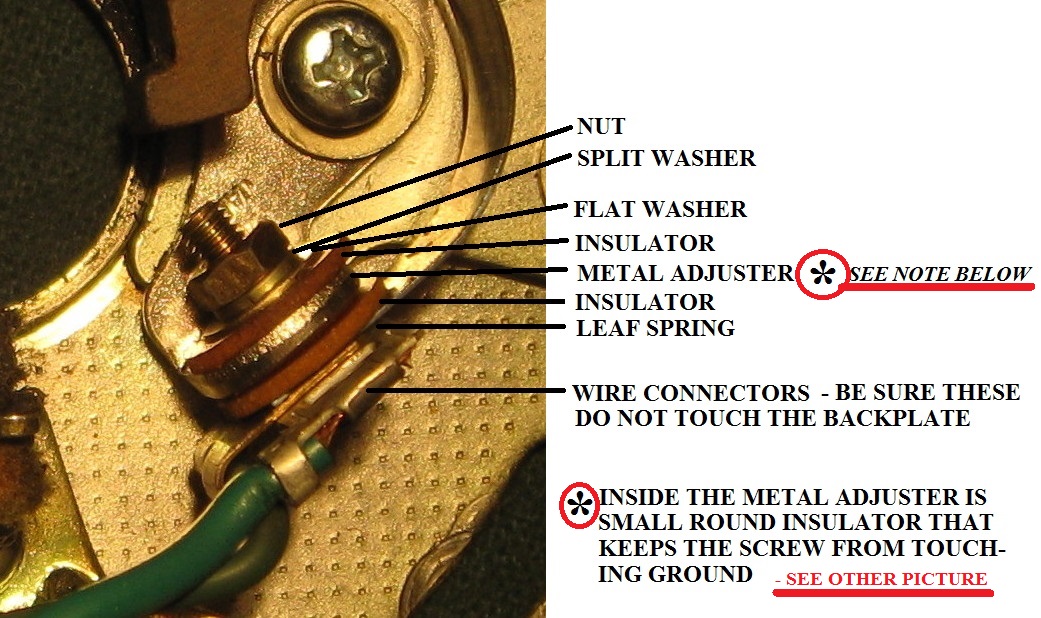

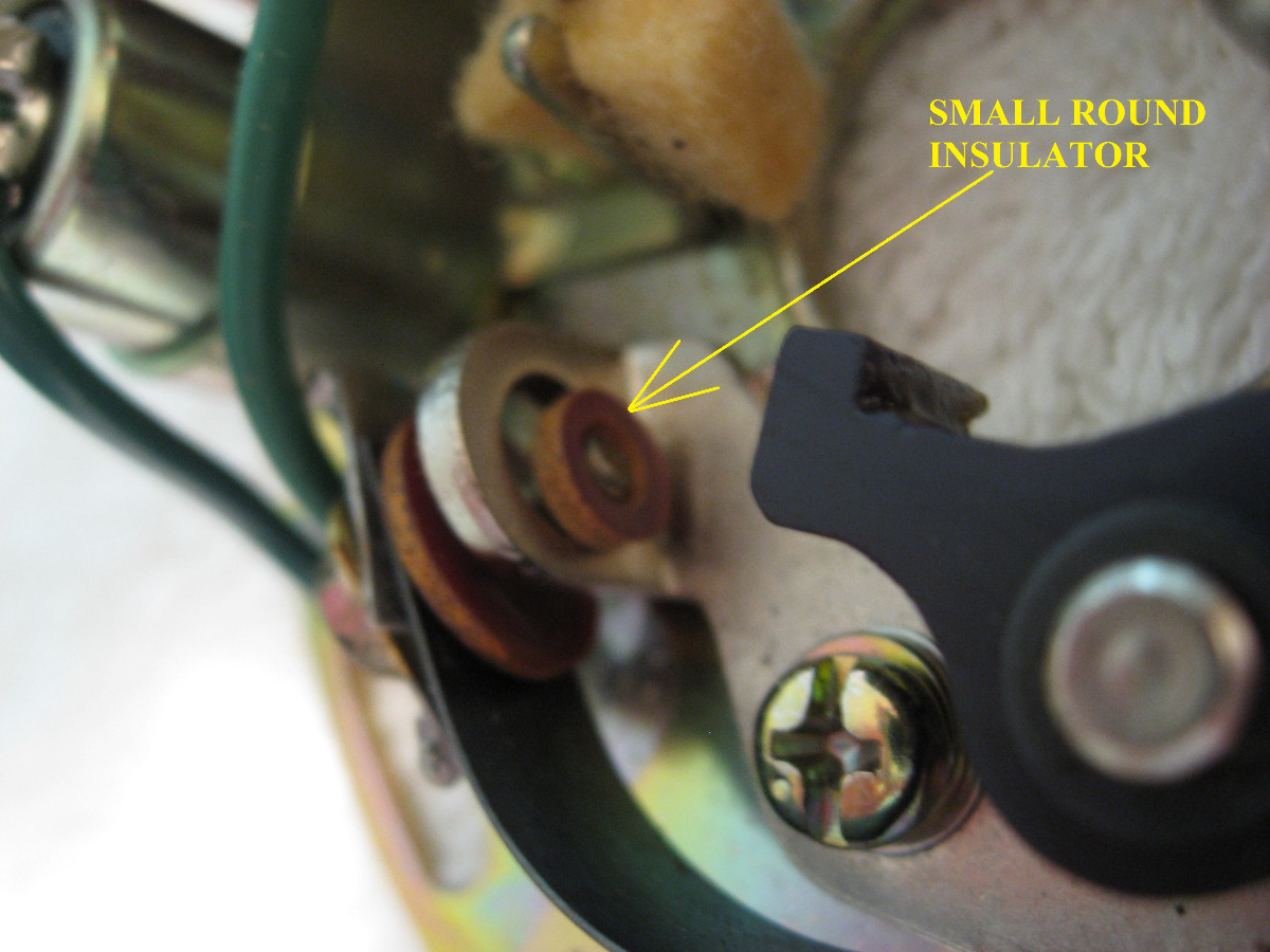

Thanks to all for the added info here on this subject. The pics really helped to clear up what was being said/explained. I have always been a "visual" leaner.

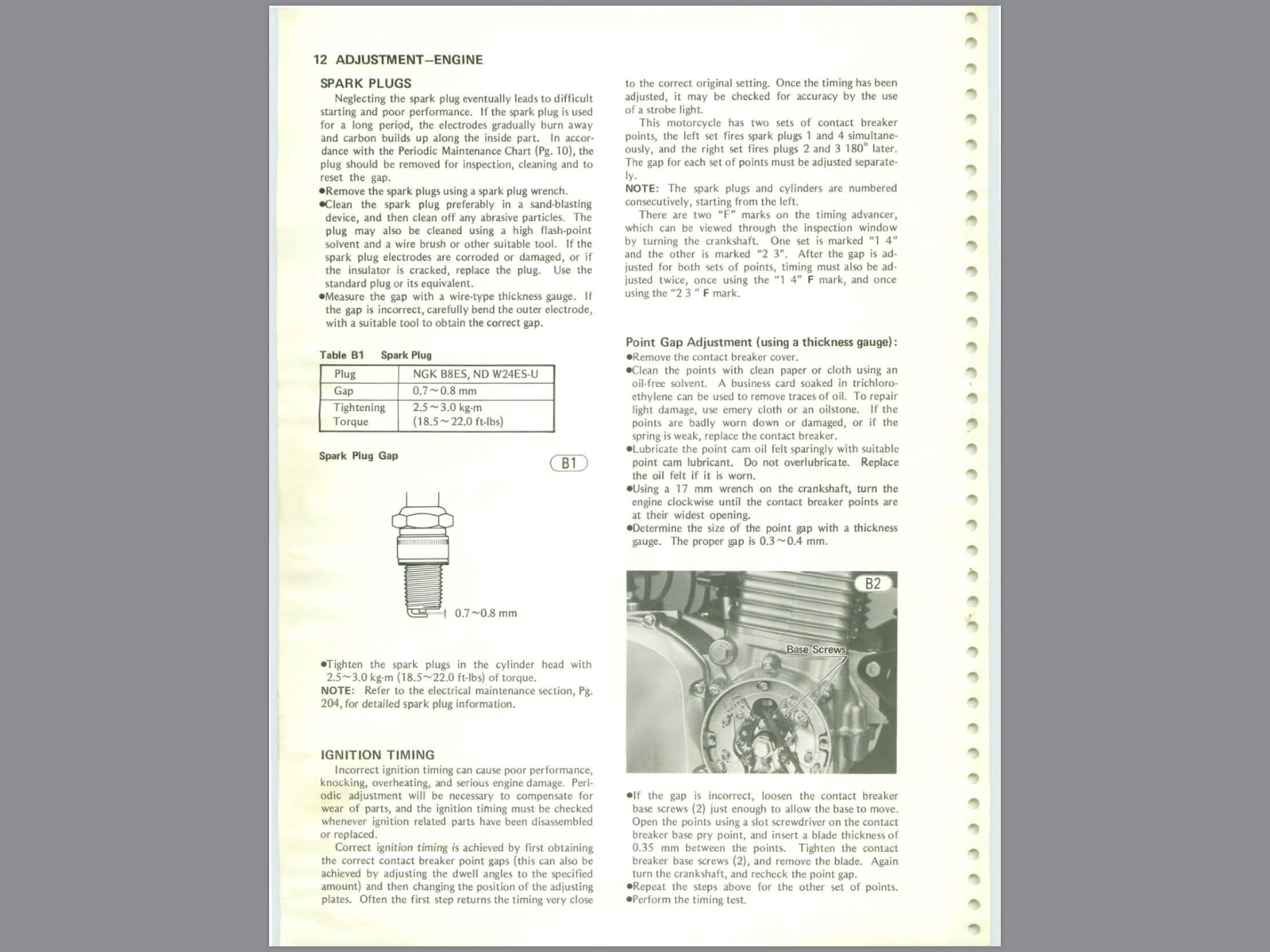

So I ended up doing what you said in regards to the points. The bike turned over and spun a bit louder but didn't start up. As it seems my issue is in the points, I am wondering if I even set them correctly in the first place now, when I replaced the old, pitted points and condenser maybe I put the new ones on wrong? I guess my question is that if the points are set incorrectly would that stop the bike from starting up? Anyway I turned the cam shaft to set the gaps to about 0.14 on either side but how exactly should I set the points when they are supposed to be touching? just turn the shaft until they are the closest then adjust the points plate to get them completely flush?

.14in or .014in?
.014in is equal to .36mm which is correct
.14in is too big
3 us dollar bills is .31mm
4 us dollar bills is .41mm
Anywhere between 3 and 4 bills thick is where you want to be.
.14in is too big
