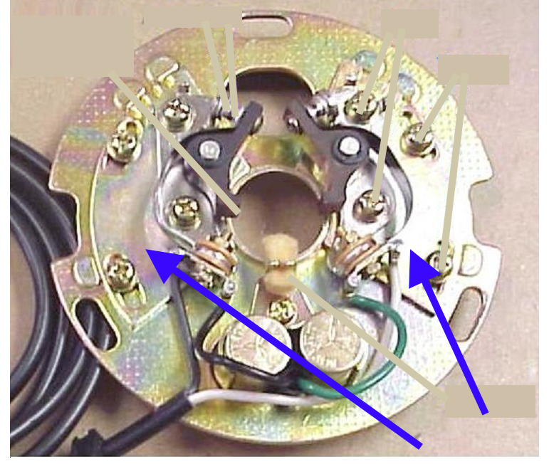

Re: Engine turns over, no spark still
27 Jun 2020 15:43 - 27 Jun 2020 15:46
The points wire is fine.
Move the positive meter probe to the points plate.
Negative probe on negative terminal
photo: Patton
photo: Patton
