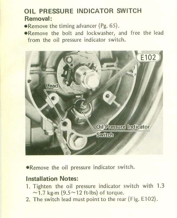

Hey guys, I posted a thread two weeks ago that was really helpful and since then I've done some more work on my 78 kz650b but it has failed to started the bike up yet. When I press the push start the bike turns over but just seems to spin and not fully start with no spark to the plugs. My ignition coils are getting full battery power to them and I have just replaced the points/condenser as well. The plug caps and wires are also new as well as the battery. I have been studying the wiring chart but have not been able to pinpoint where my issue may be yet. All the other electrical works on the bike great aside from the ignition system so I am assuming the issue would be in that range as opposed to a start motor issue? What are my best chances of getting this thing started up? I set the gap and timing at the points and after having tested most of the connections to in the ignition system wiring I'm kinda stumped. Only thing I noticed that was weird was that the wiring leaving the contact breaker points have three connections as opposed to the two in the wiring diagram but that might just be the previous owner jerryrigging something? Any further help would be greatly appreciated.

Some bikes have the oil sending unit inside the points housing. That should be the third wire. If you don’t have that then maybe a wire harness was swapped into service that had the third wire...

26 Jun 2020 17:44 - 26 Jun 2020 17:44Only thing I noticed that was weird was that the wiring leaving the contact breaker points have three connections as opposed to the two in the wiring diagram but that might just be the previous owner jerryrigging something?
The third wire should be connected to the oil pressure switch.
