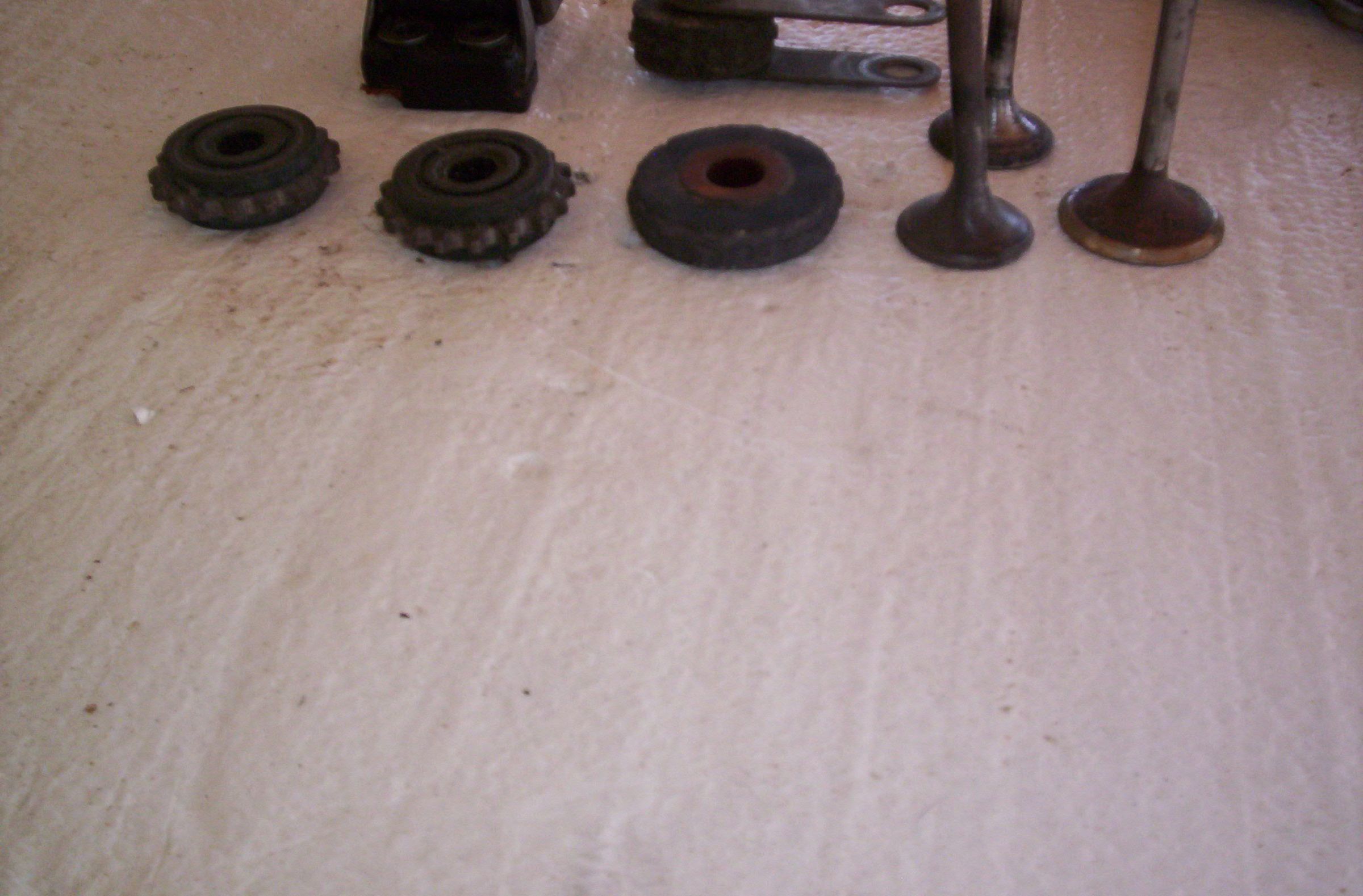

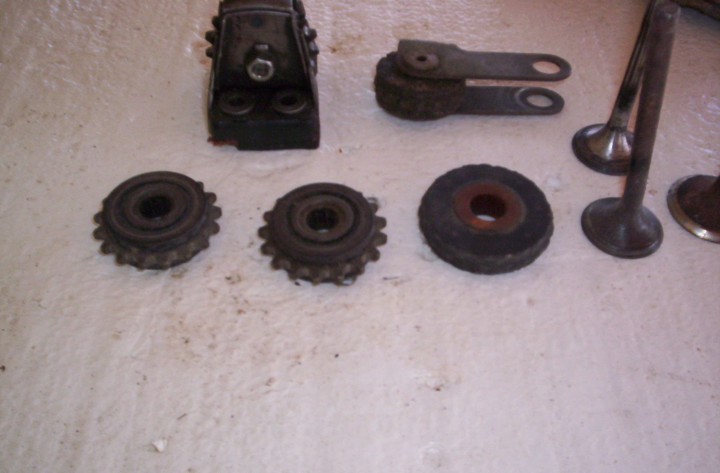

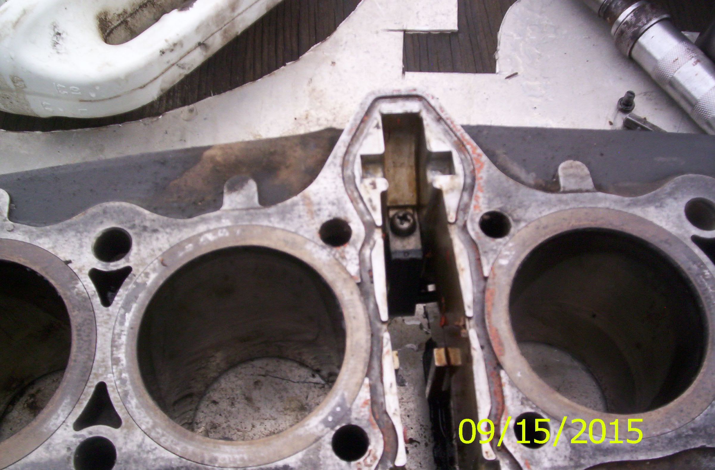

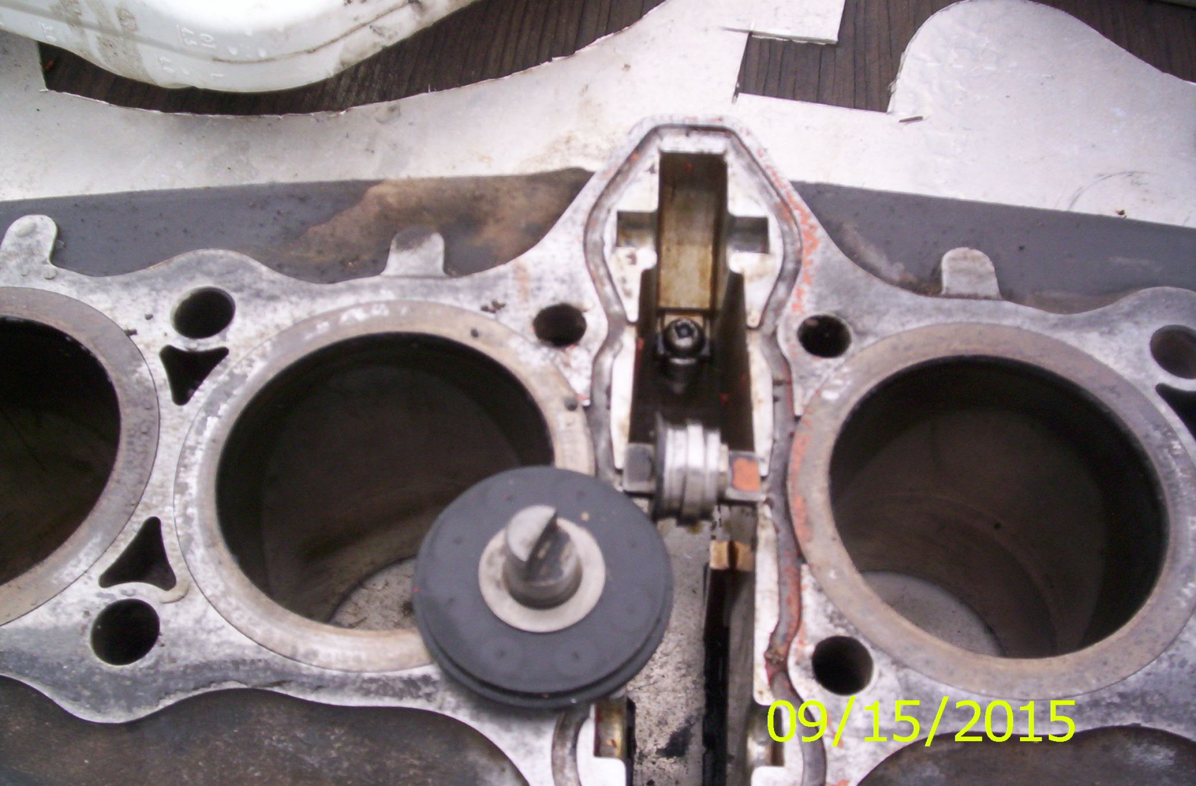

Here's a pic of the rollers when I took Bossie apart in 13. I knew the rollers were old and coming apart. The rubber ones are hard and wouldn't last. The front guide was gone, just the mount was left. The chain was riding on the head. Metal in the pan. You can see a bent valve. It was from a long time ago when I used old parts and didn't listen the the noises. I just put a 450 Honda push rod in the adjuster because it was longer. STUPID
I paid with bent valves and all that went with it when my cam chain broke.
