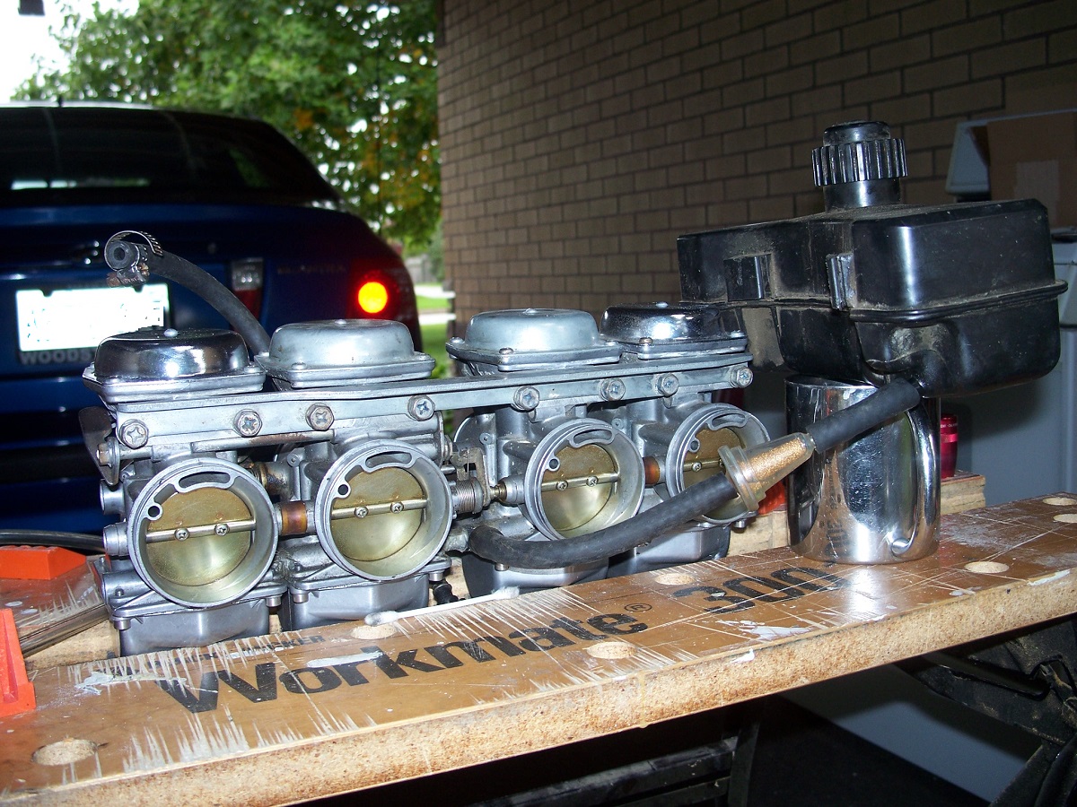

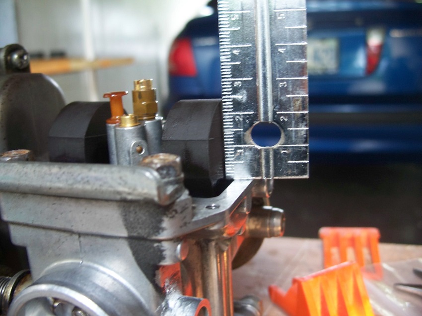

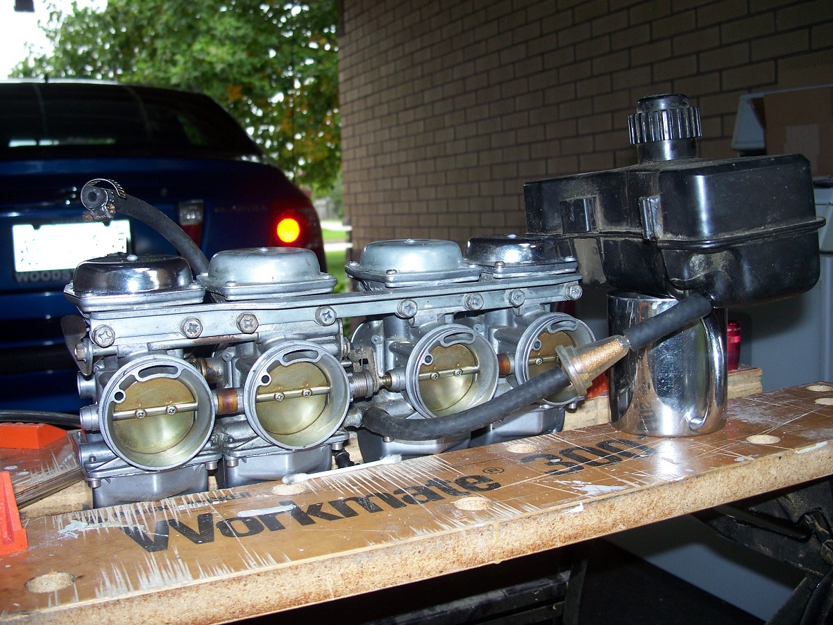

Here's my crude but effective setup outside. I use an old lawnmower gas tank. Use a ruler to actually measure the level (mm below the seam between carb and carb bowl)
If all in spec the you're done. If not then turn carbs upside down, remove bowls and measure the float height. Do the math from the fuel level reading and adjust float height the required mm by bending the tang pressing on the needle valve.
Example - if your fuel level is 2 mm to low then adjust the float height by 2 mm in the right direction. Much better than trial and error.
Button verything up and you will have the correct levels.
