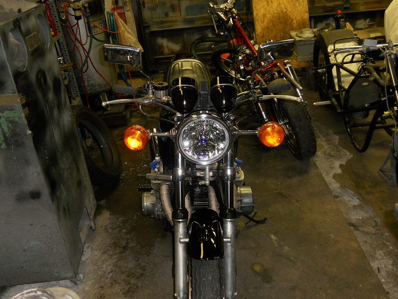

This 77 KZ 1000 has a halogen HEI light. I got it this way. The P.O. put a Yamaha volt reg on it.
Don't know the numbers. All I know it works, charges and is bright!
