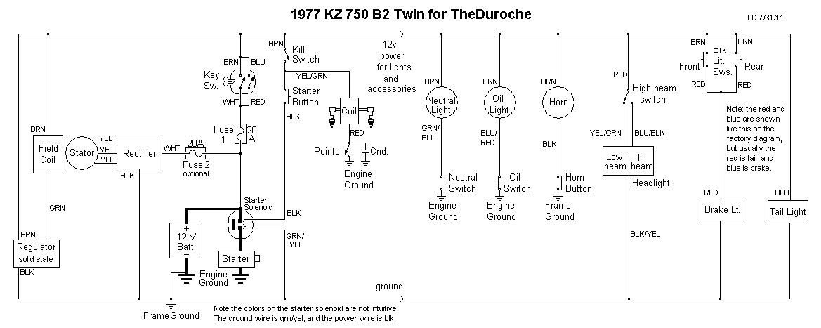

Bare bones 1977 KZ 750 B2 KZ750 B2 750B2 KZ750B2 twin for TheDuroche
EDIT 1/10/2019:
Mattylight Barebones Bare Bones
1977 Kawasaki Kz750B2 for TheDuroche
Kz750B Kz750 B2 Kz 750 B 750B2 750B

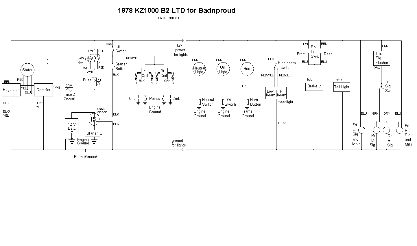

1978 KZ1000 B2 LTD for Badnproud
KZ1000B2
EDIT 1/10/2019:
1978 Kawasaki Kz1000B2 for Badnproud
Kz1000B Kz1000 B1 Kz 1000 B 1000B1 1000B
Last edit: 10 Jan 2019 16:02 by loudhvx.

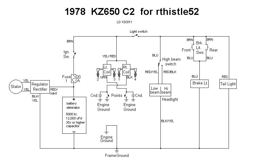

Batteryless 1978 KZ650C2, KZ650 C2, KZ 650 for rthistle52.
EDIT 1/10/2019:
1978 Kawasaki Kz650C2 for rthistle52
Kz650C Kz650 C2 Kz 650 C 650C2 650C
Last edit: 10 Jan 2019 16:07 by loudhvx.

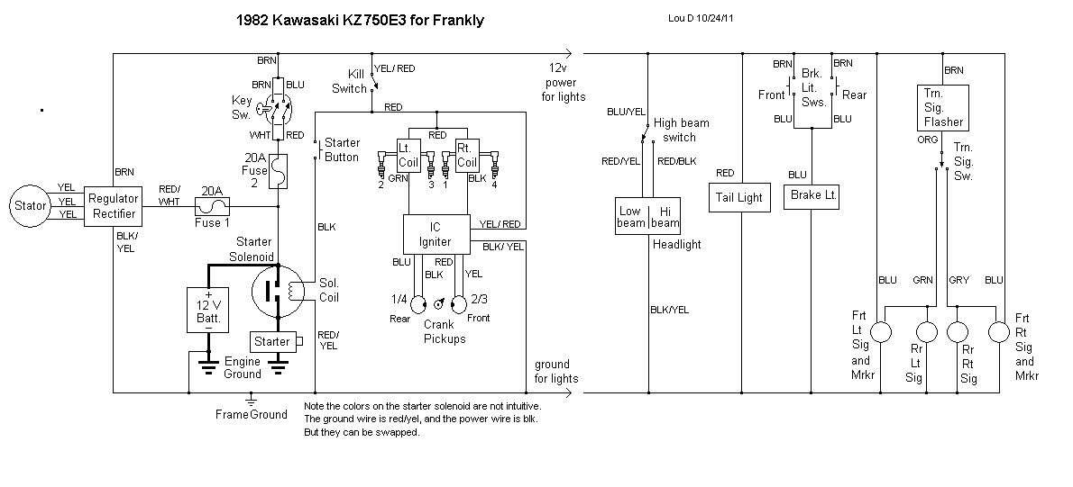

1982 KZ 750 E3, KZ750E3, for frankly.
EDIT 1/10/2019:
1982 Kawasaki Kz750E3 for frankly
Kz750E Kz750 E3 Kz 750 E 750E3 750E
Last edit: 10 Jan 2019 16:08 by loudhvx.
