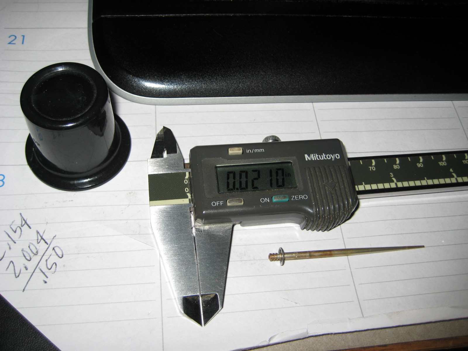

The space between each clip groove on a Mikuni needle is .021" (0.53 mm) if you can find a shim washer half that thickness those will be ideal for your purpose. ID needs to be .100" (2.5 mm) and OD .240" (6.1 mm) based on needle and clip OD'S.

I don't know who your getting your info from but I just double checked my info and I got .021" between the clips (0.53 mm) on Mikuni round slide needle.
A 0.50 mm washer would be useless as that is a one full clip up adjustment. According to my "measurement" a 0.30 mm washer would be OK to put you at 1/2 a clip up.
I think if you can get some 0.10 x 2.5 x 6 mm ( TxIDxOD) metal washers you could adjust as much as you want. Ebay will probably be the cheaper option.

If you move up or down to the next groove its a 0.53 mm jump. If you stack some of those thin washers under the clip you can achieve about a 1/4 or 1/2 of a clip adjustment.
1978 KZ650B2 modified project
1981 Z50R Honda tow bike
Replied by Injected on topic Needle shims vs Clip
The Mikuni needle show in my pic is out of a VM26 carb. The clip/grooves are .016" thick and the space between them is .021" so nothing on those needles is anywhere close to 1 mm.Thank you I will check it now on ebay!! So the mikuni ratio of 3 to 6% at low throttle is good for 0.5mm clip?! Does mikuni have 1mm needle clip?!
I appreciate

No, the needles are stationary and the actuator swivel for the slides cover the clip so it does not move. 3 x 0.1 mm washers = .012" so that should not be a issue. Any more than that and you should move the clip up/down.Is it dangerous to put 2-3 washers underneath the clip?!
