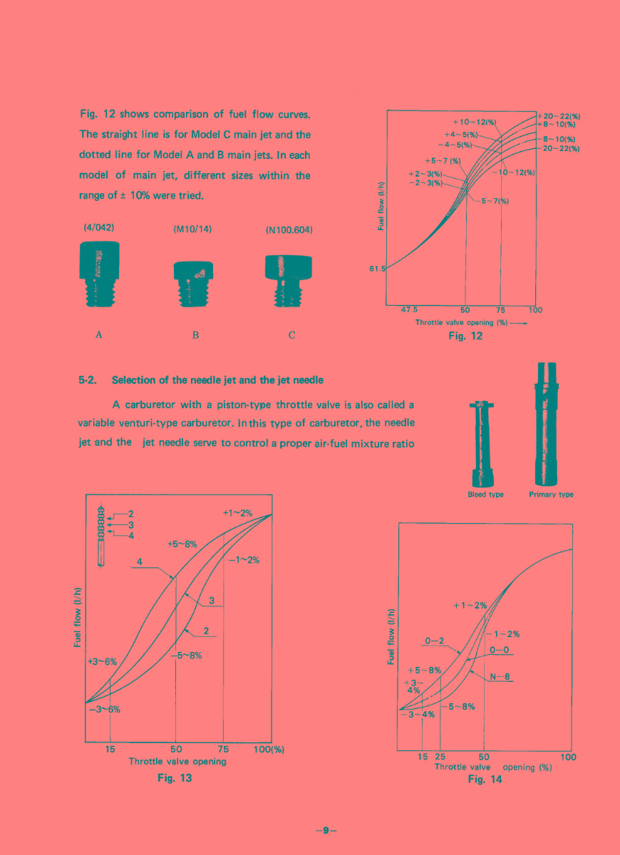

In general, one notch up or down on the needle will affect fuel flow as follows:
At 15% throttle valve opening you will get +/- 3% to 6% more/less fuel for each step
At 50% throttle valve opening +/-5% to 8% more/less
At 75% throttle valve opening +/-1% to 2% more/less
The above info comes from a Mikuni manual

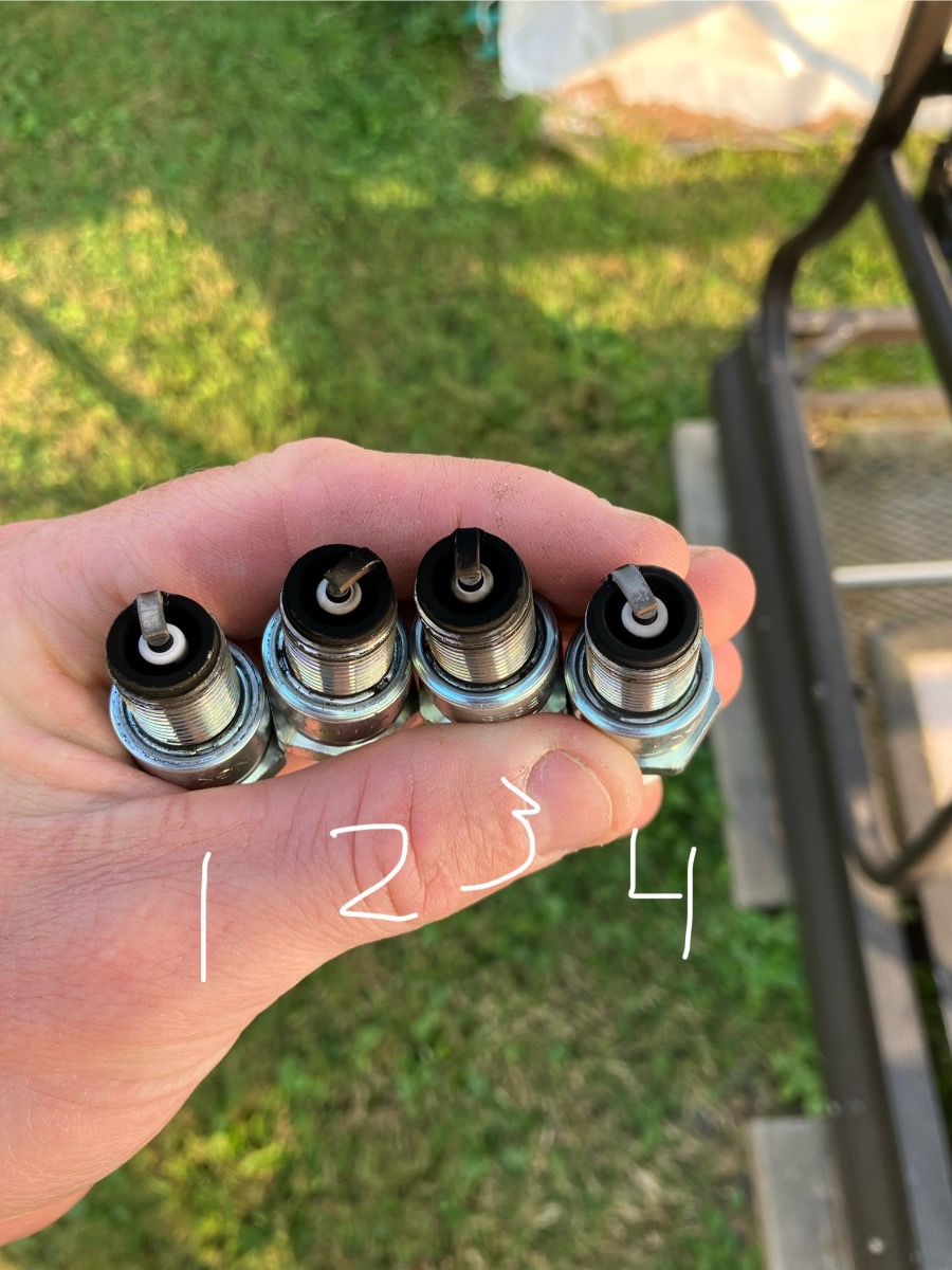

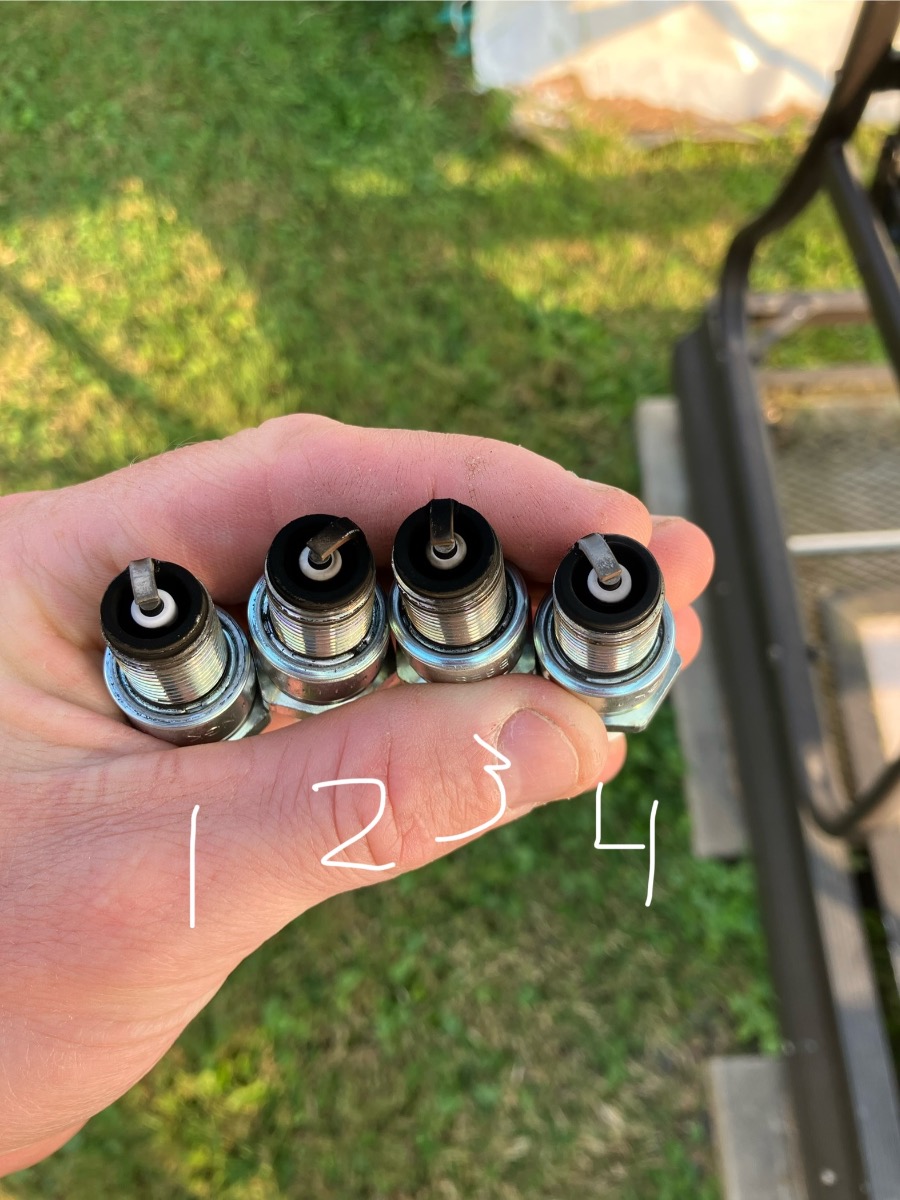

Hum, next summer I switch to real K&n pods. My afr at 4000rpm is approximately 16 .. so I thinking about shimming my needles and put all the same main jet size!! Now I have 102.5 1-4 and 105 2-3. I will put 105 everywhere.. 1-4 are lean a bit if you remember the colors on my last post!!?
