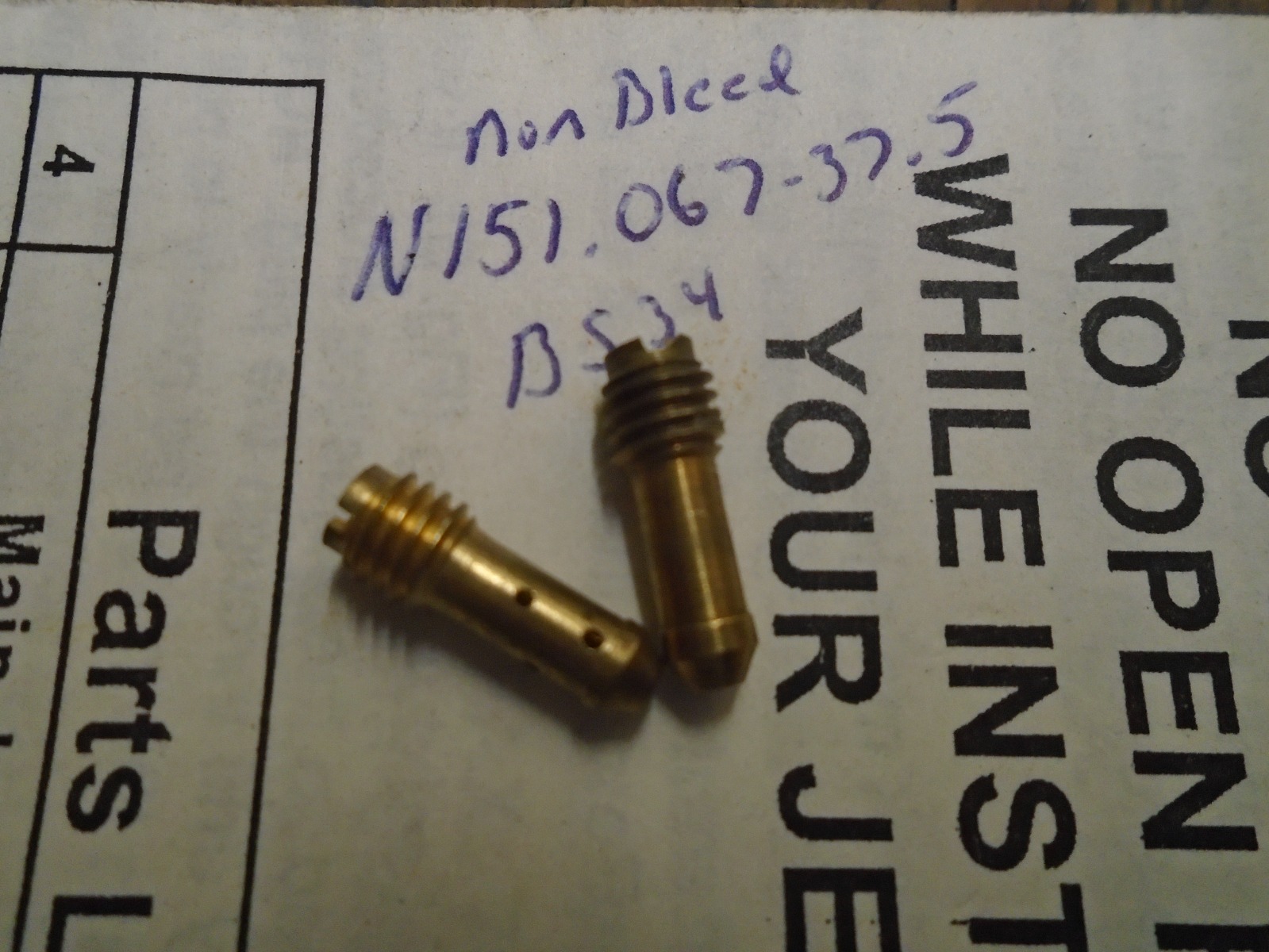

Something to verify. When You are considering changing out those Pilot jets, check them puppies when you pull them out. I've Never had to change the 37.5's even when running a sidewinder pipe and pods on a 1075 set-up. All pilot jets are NOT built the same. They had BLEED and NON-BLEED types as shown. Make sure you have the correct ones in there and not some Chinese knock-offs. And..NO, those fuel adjust screws shouldn't be 3.5 turns out, something is a-miss. The reason i mentioned the possible loss of vacuum initially.

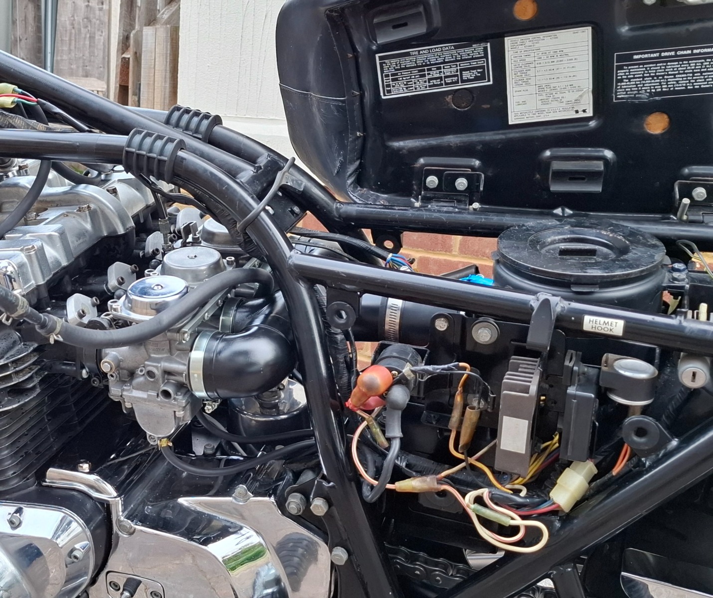

i'm running the original filter in its original housing. But because i have removed everthing associated with the FI system i had to create a air intake manifold and connect it to the filter box. The only thing that could be a problem, is where the manifold connects to the carbs is not making a good seal. May need some very thin rubber as they are actually quite a tight fit. The picture isnt great but may show you what i have done.

I wouldn't expect a small amount of leakage on the filter side to effect it greatly, nice job on the manifold. Are all the vac take offs on the carbs capped (except the one for the petcock)

Thanks, i cant take full credit on the manifold design, saw one of alan milyard videos where he did it on one of his kz's, so if it works for him, it should work for me. Yep all the vacuum caps are plugged of, dont need a vacuum pipe for the tap as its gravity fed. Just wondering if the filter has had it, as it is old and may have lost its integrity. Maybe clutching at straws with that theory. If its a dry weekend i'll have a good look at everthing and make sure everything is tight.
