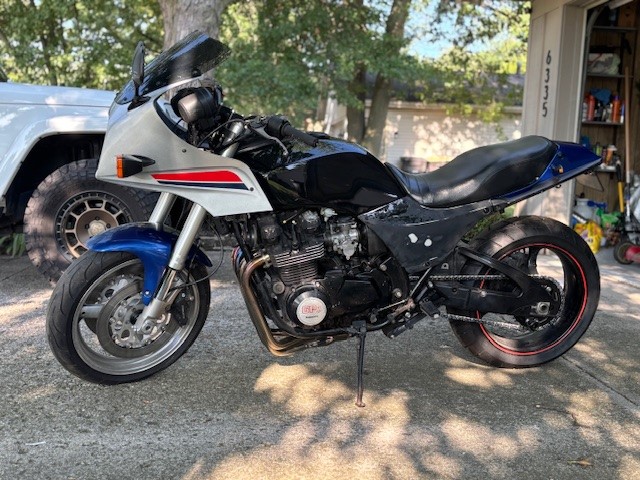

27 Aug 2025 12:49 #916455 by 84_GPz750
Replied by 84_GPz750 on topic 84 GPz750 bogs and dies once hot
Quick check in. When I pulled the carbs off last week I pulled the fuel bowls off and noticed the float needle valve sprung ends had varying levels of motion and that the floats had wildly different heights. I had recorded the levels I has set them at last spring so I am not sure if parts wore out or I did something incorrectly. Anyways, I purchased all new float needle valve assembly's and set float heights to 22.4mm. Some were 5-6mm low resting on the new float needle valves so had to bent the tang quite a bit to get them there.
Wondering if I never had the bogging issues while the bike was up on the rear wheel stand due to the change in the fuel angle within the bowls artificially shutting the valves before the level rose too high. Once down on the ground on both wheels, the level would be higher and maybe that's why pulling the intake rubbers off caused it to run better?
Able to take it for a quick trip down the road and back, less than half a mile but the only issue I'm having now is just off idle there is a slight hiccup still but with slightly more throttle it clears up and runs great. Just did that this morning before heading into work so I'll need to look into it further as I have a chance.
Here she is in all of her current lack of beauty.
