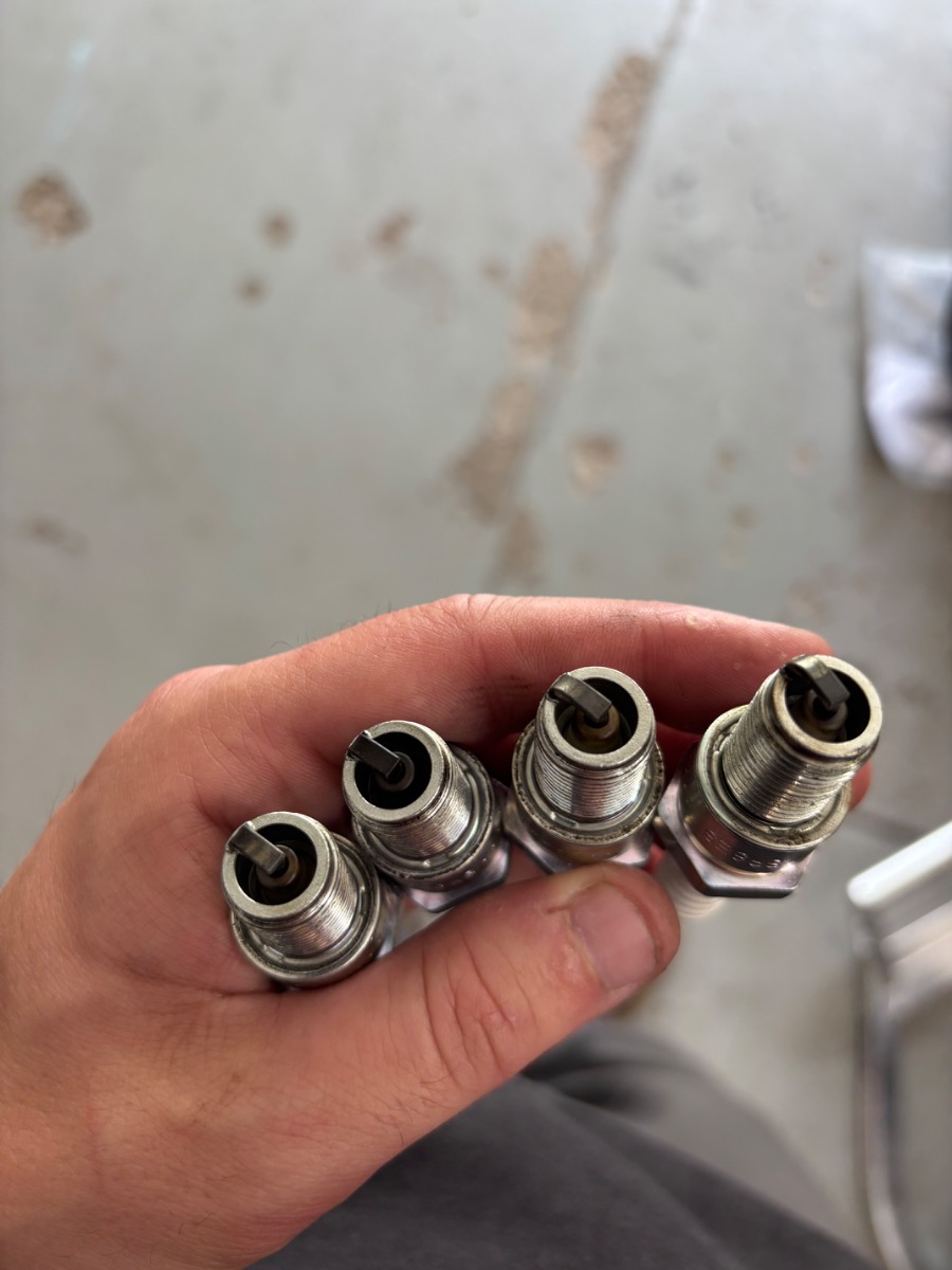

Here is a picture of the brand new spark plugs I put in right before idling for 5 minutes, a few throttle whacks, and attempting to ride down the street before it stumbled and died. 1 —> 4 from L to R.
#2 cylinder has consistently been an issue but none of the times that I’ve opened up the carbs have I seen an issue. Think I’ll be renting a compression tool to check that again.
Seems my valve clearances are within spec and the cam chain and crank turning is not alarming. I’m still stumped on the poor running.

The pic of the plugs and how it was running were prior to checking the valve clearance and the reason I went ahead and checked them.
