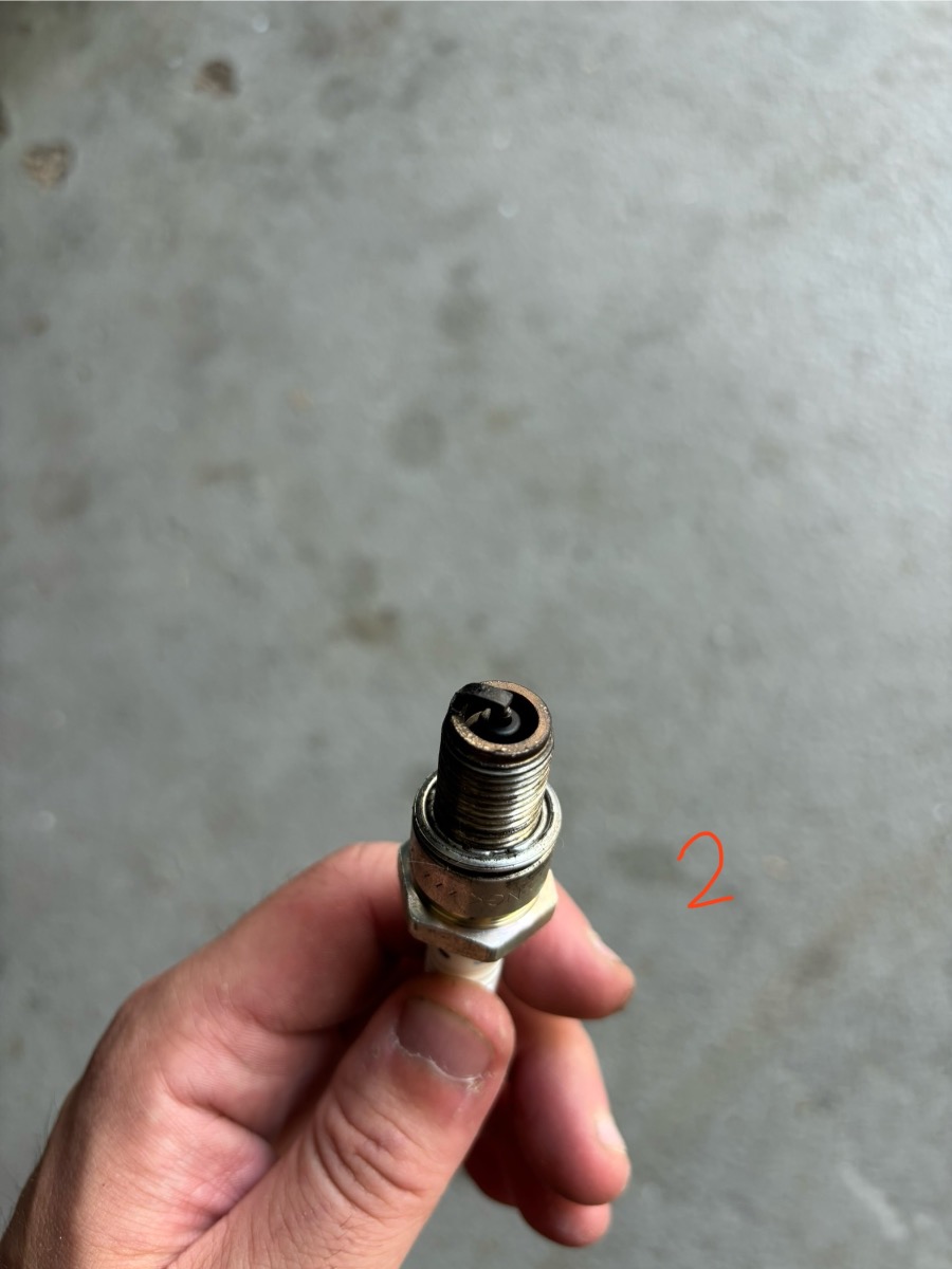

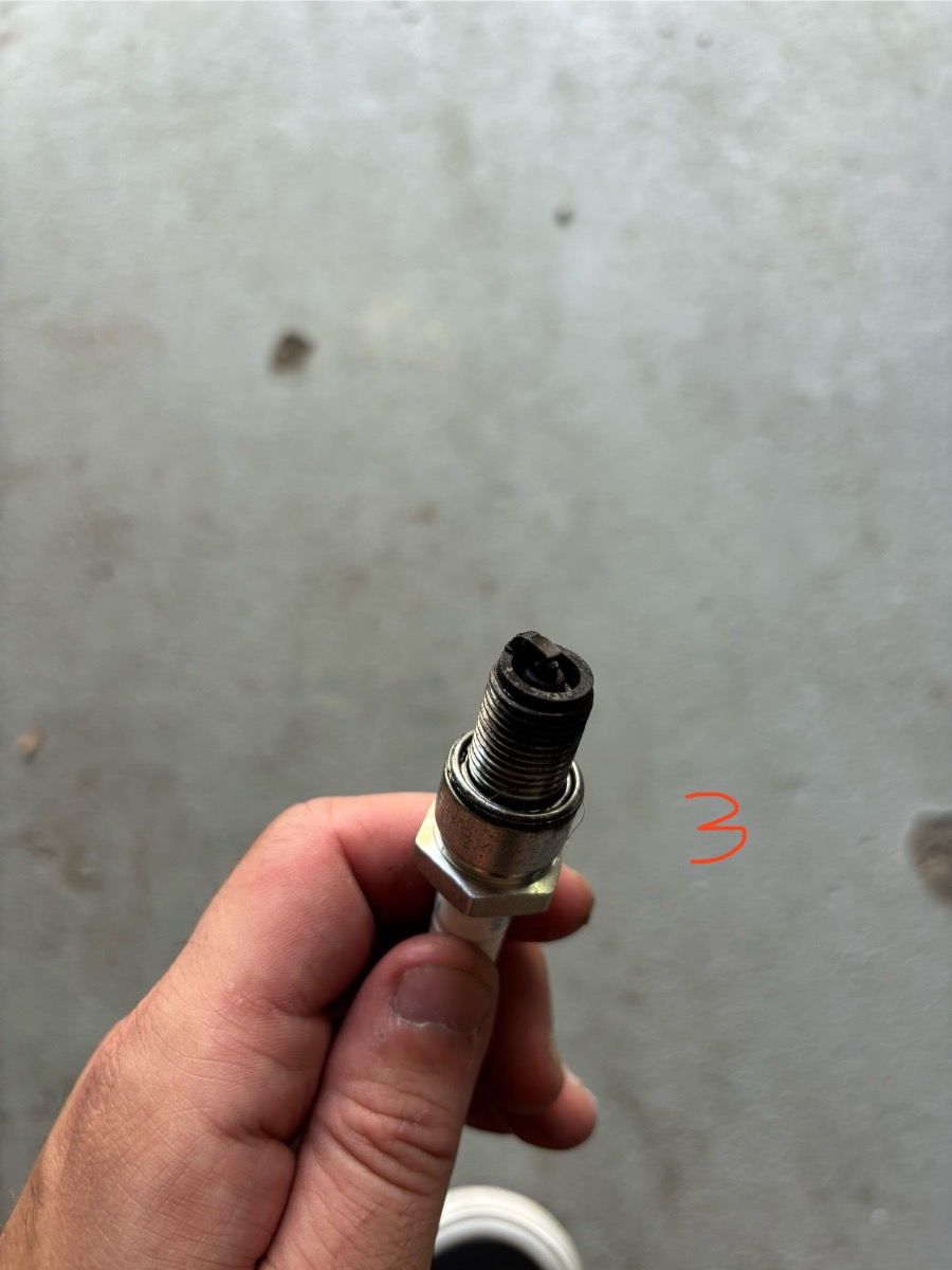

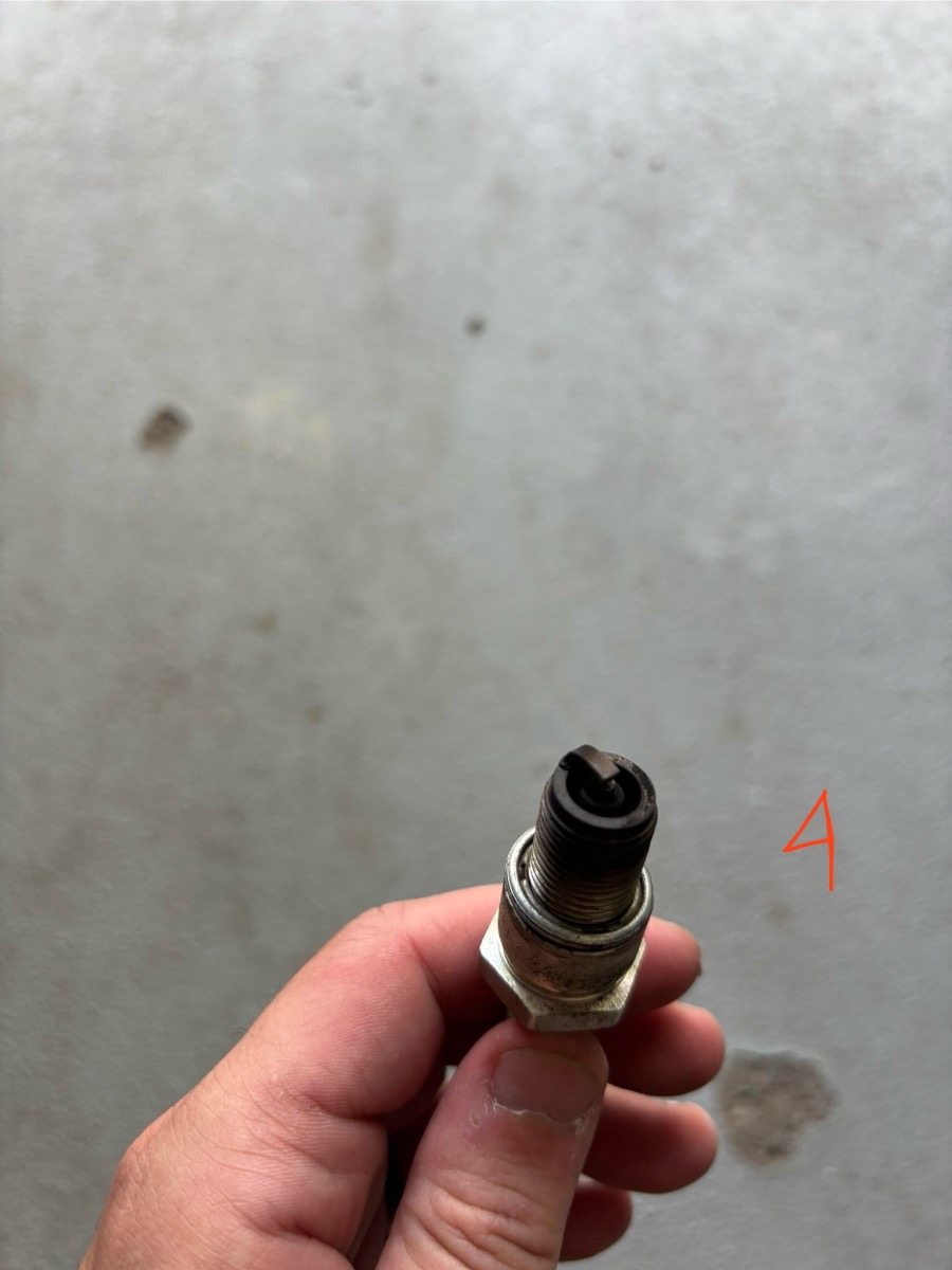

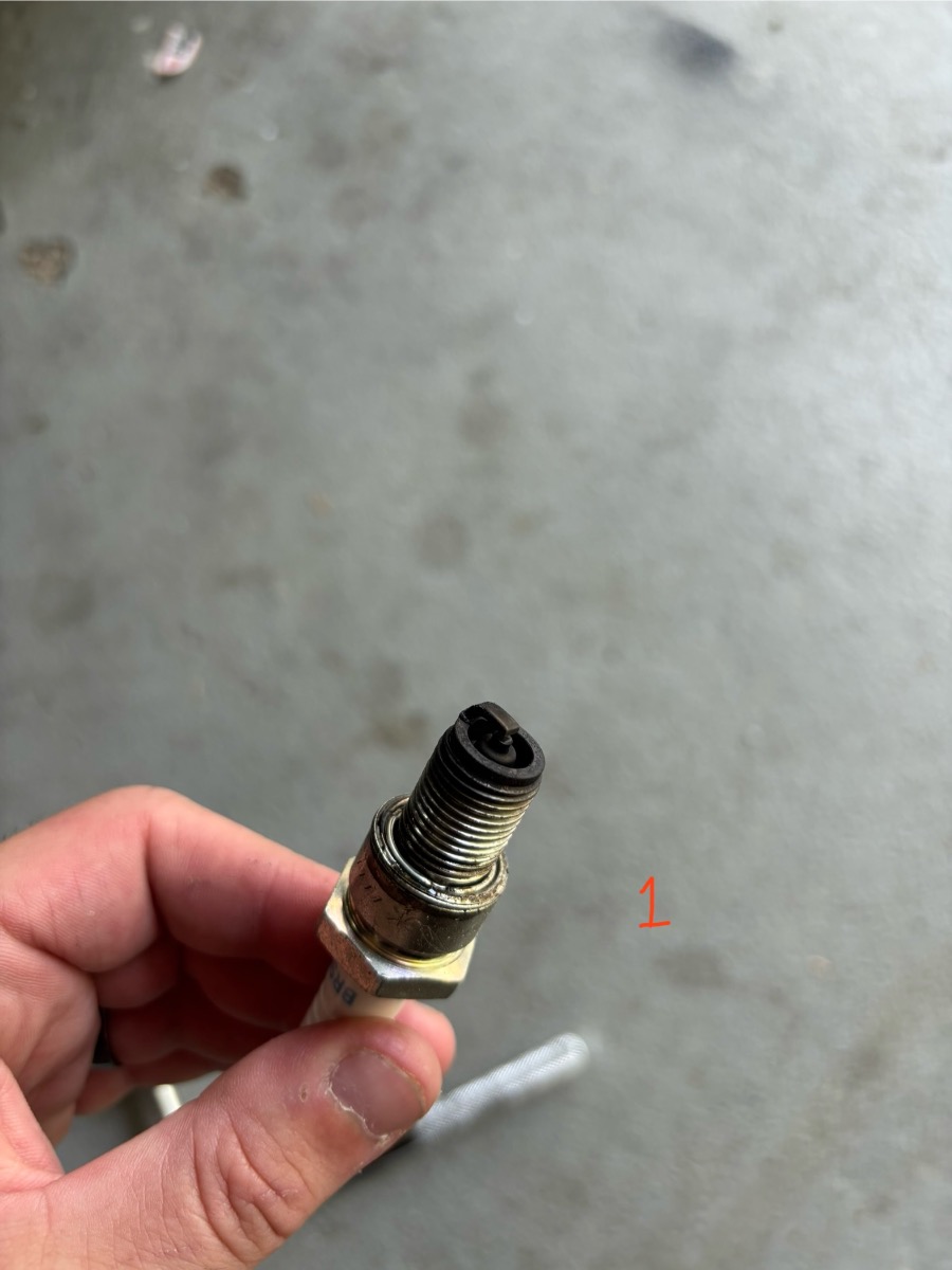

Attached pics of each plug. Running NGK BR9ES’s.

First off your running the wrong heat range plug, run a B8 heat range plug (NGK or ND equivalent) Try to get a non resistor (no "R" pn) plug.
Stock jetting for that engine/carb combo assuming stock CV carbs is #37.5 pilot and #110 main jet, a #117.5 main is way too rich.

Thanks for the info @Injected. You say the wrong heat range plugs. The manual I have shows BR9ES for standard riding and BR8ES for low speed riding? I picked up a set of NGK B8HS non resistor type that I’ll try.

Yes, the factory manual calls for NGK BR9ES or ND W27 ESR-U, so the ones you have are correct. One way to check the choke plunger is to pull one out and look at the seal in the tip. If it has a deep indentation or is really hard, they need to be replaced.

Its a stock 750cc air cooled engine, every one I have ever seen runs B8 plugs.
B9's would be fine on a race bike that runs much hotter, I run B8's on my 90HP 831cc street bike. I run B9's on my 831cc alcohol injected drag bike and my 1327cc gas drag bike.
