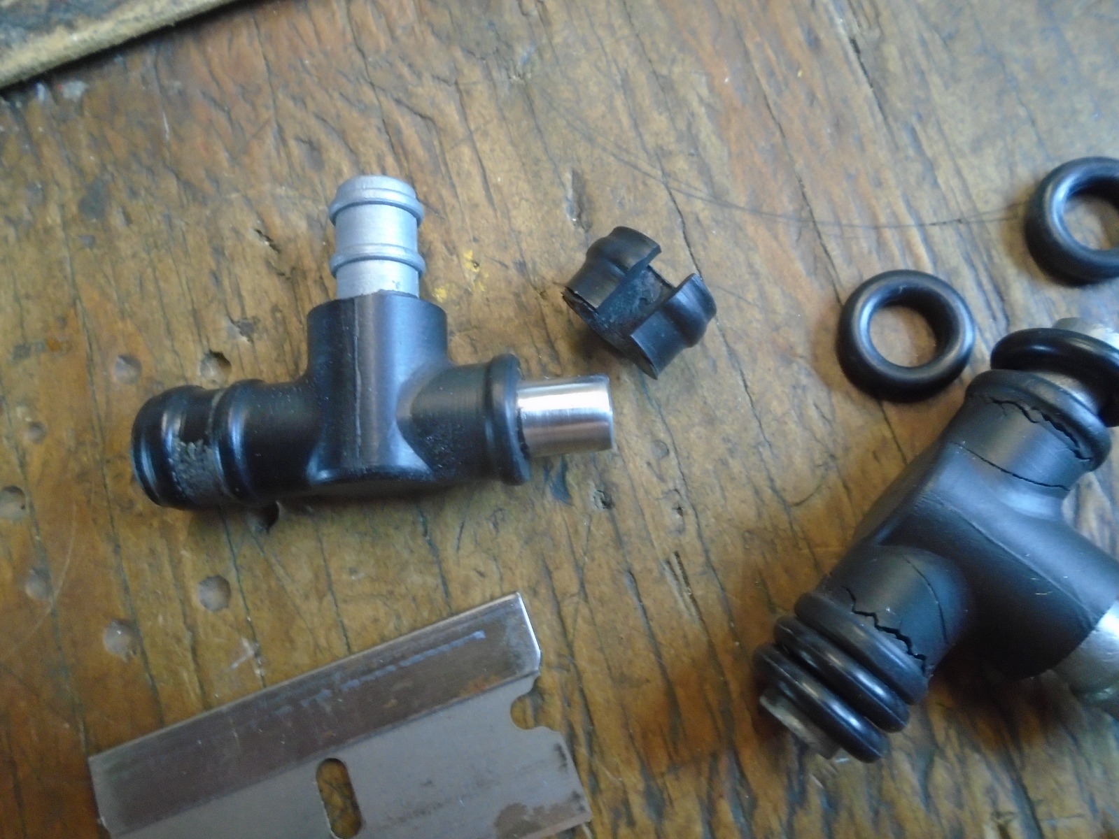

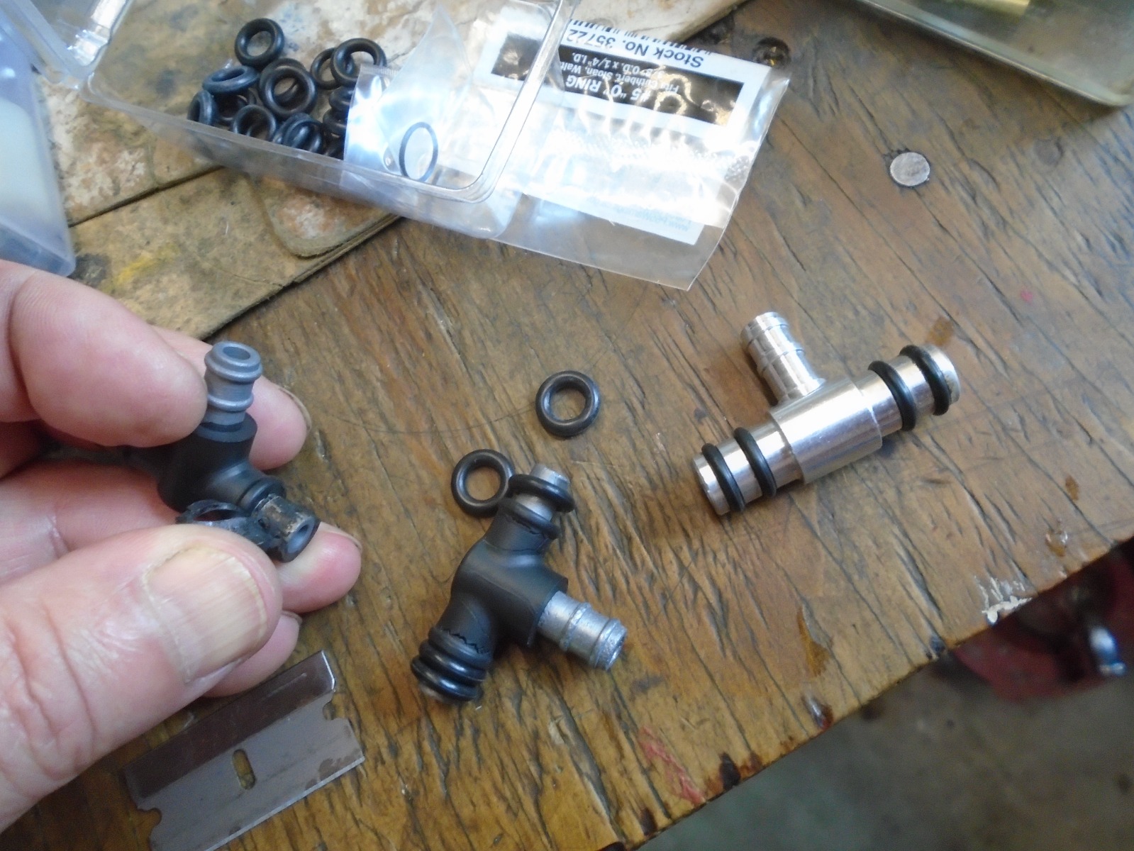

Sorry Tex those are not the correct dimensions, wish they were! The ones ive used for years are the #78 orings. They have a AS565 standard im sure but couldn't find it
? But the SAE is 3/32"CS X 7/16"OD X 1/4"ID. Metric..wait for it..complicated 2.6CS X11.25OD X 6.25ID. But believe me, the #78's are a perfect fit for the 72-80 VM carbs, been using them for years without Any complications or call backs. A few pics to define.

Clay are they the same size if sitting in a groove on the brass fittings ?

Wookie, absolutely not. But..These are the perfect size for using on "existing" T's. Joe..I would Love nothing more then to supply you with a handful of these but don't want you to have to spend a crapload on posting. Reference the number on the packet in picture! Then purchase more local, save you a ton of rumples/deutsche marks/euros/bitcoins. Let me know what you find Joe.

I stand corrected on the proper O-ring size for the TWO feed, small fuel Tee's. My reference of -011 size is correct for the center feed (single large) Fuel Tee.
My bad. I assumed both would be the same, but NO. The small fuel Tees have a much smaller inner core, compared to the center feed, long, Tees.

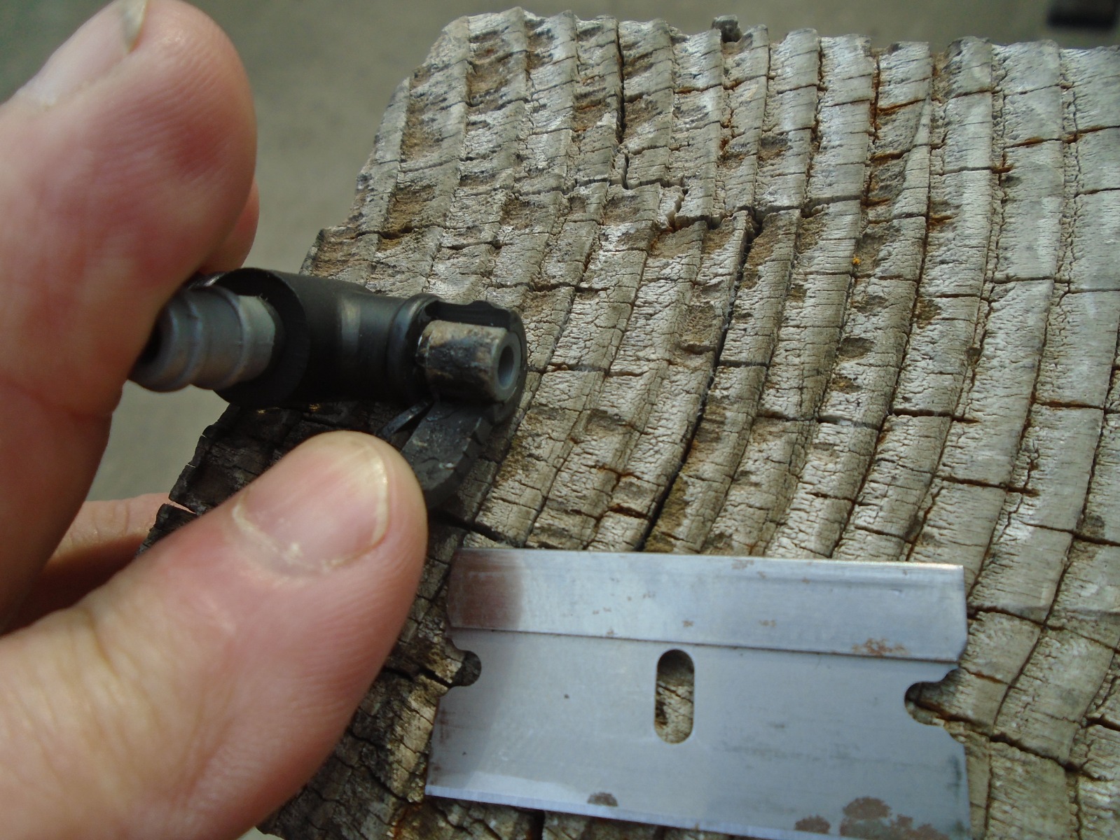

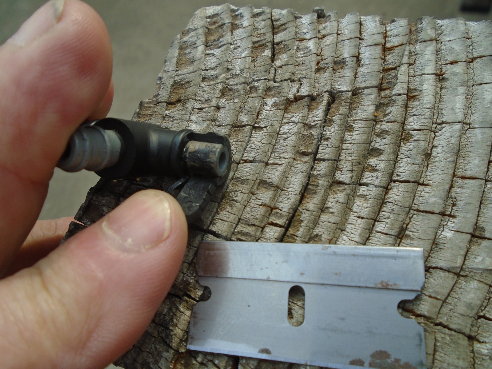

28 Jul 2025 09:27 - 28 Jul 2025 09:48Sorry Tex those are not the correct dimensions, wish they were! The ones ive used for years are the #78 orings. They have a AS565 standard im sure but couldn't find it ? But the SAE is 3/32"CS X 7/16"OD X 1/4"ID. Metric..wait for it..complicated 2.6CS X11.25OD X 6.25ID. But believe me, the #78's are a perfect fit for the 72-80 VM carbs, been using them for years without Any complications or call backs. A few pics to define.
Look at my good friend Clay here, doing delicate carb work on top of his firewood pile! Can't argue with results, though!!!
