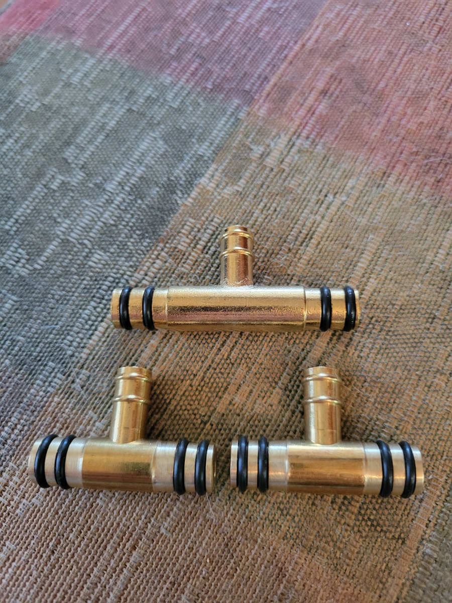

Clay is beating around the bush. What he wants to say is to take your old Tee, chop off some of the rubber, and slip on individual O-rings. The photo is his.
What I do is buy cheap china brass Tees, then shorten them and add new O-ring grooves using a lathe. These are about half the price or less compared to buying new Tees.

would you please tell me the dimensions for the O-rings ? ( If possible, in metric dimensions?.....I meant the O-rings for the original "both-sides-rubber-stripped"-tees, thanx a lot!)
I use SAE dash -011 size. Nitrile works well, it swells with gasoline contact, which leads to a good tight seal.
Edit: -011 is the proper size for the long, center feed fuel Tee O-rings. For the smaller, duel feed fuel Tee's, a different size O-ring is need (see below).

Thanx, but i can´t translate this size to use it, ...nned dimensions like" 9x1,9 mm "

Conversion chart
Scroll down to AS568 O-Ring Size Reference Chart
www.globaloring.com/as568-size-chart/
Looks like 1.78 X 7.65mm
