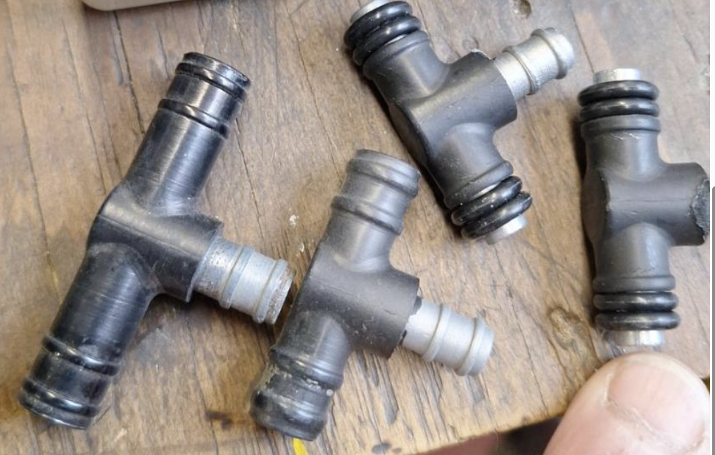

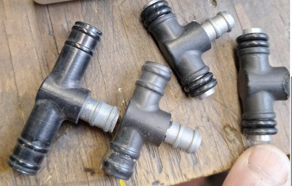

Clay is beating around the bush. What he wants to say is to take your old Tee, chop off some of the rubber, and slip on individual O-rings. The photo is his.

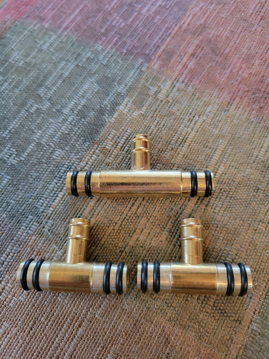

What I do is buy cheap china brass Tees, then shorten them and add new O-ring grooves using a lathe. These are about half the price or less compared to buying new Tees.

I use SAE dash -011 size. Nitrile works well, it swells with gasoline contact, which leads to a good tight seal.
Edit: -011 is the proper size for the long, center feed fuel Tee O-rings. For the smaller, duel feed fuel Tee's, a different size O-ring is need (see below).
