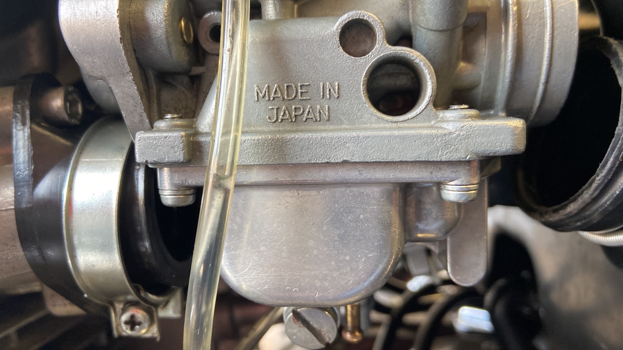

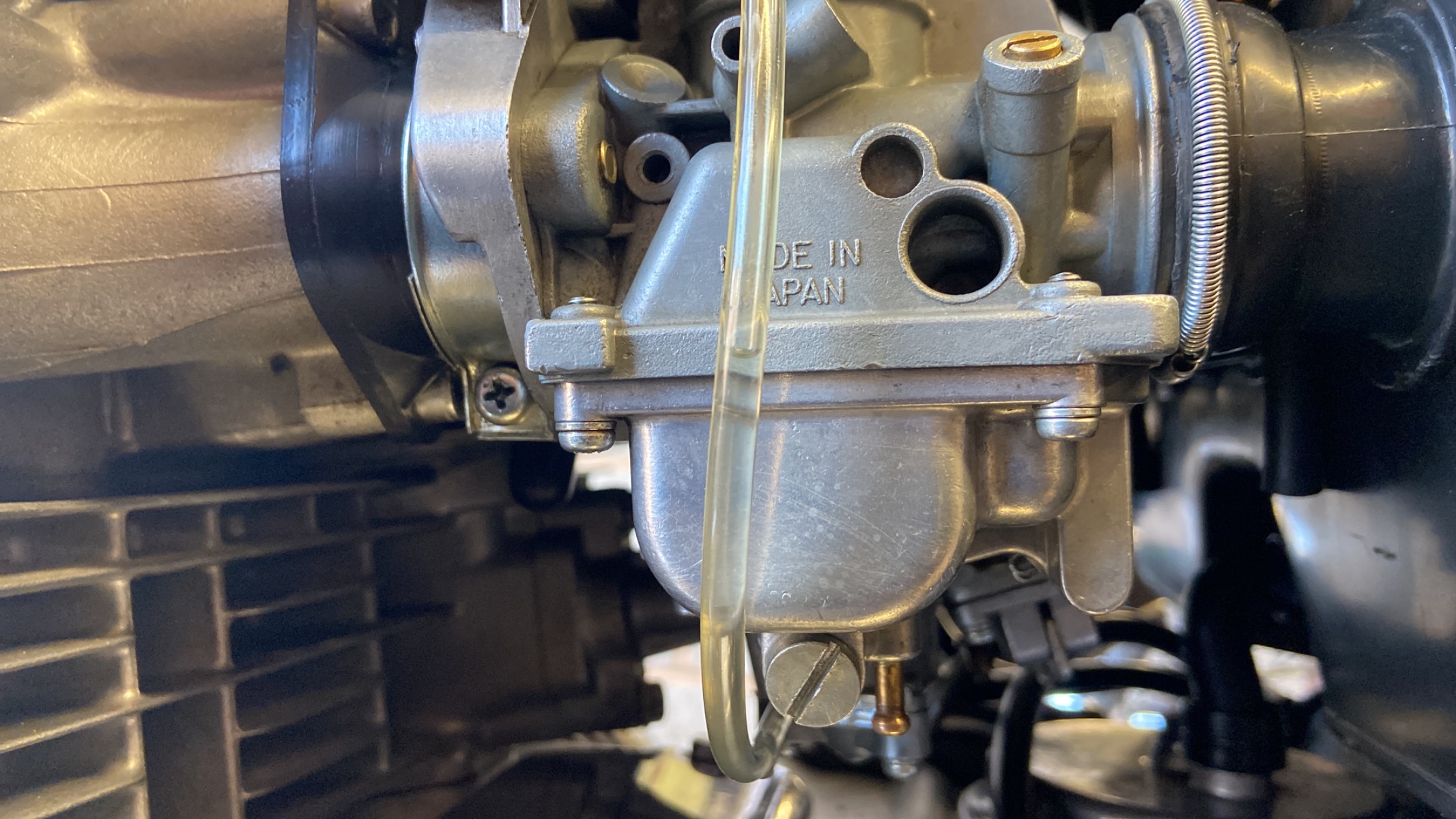

Yes 17.5 pilots I’ve tried these as someone suggested. They are all genuine Mikuni parts I’m back on the supplied 15’s now ? Rightly or wrongly.
Number fuel height was high…I’m just checking now

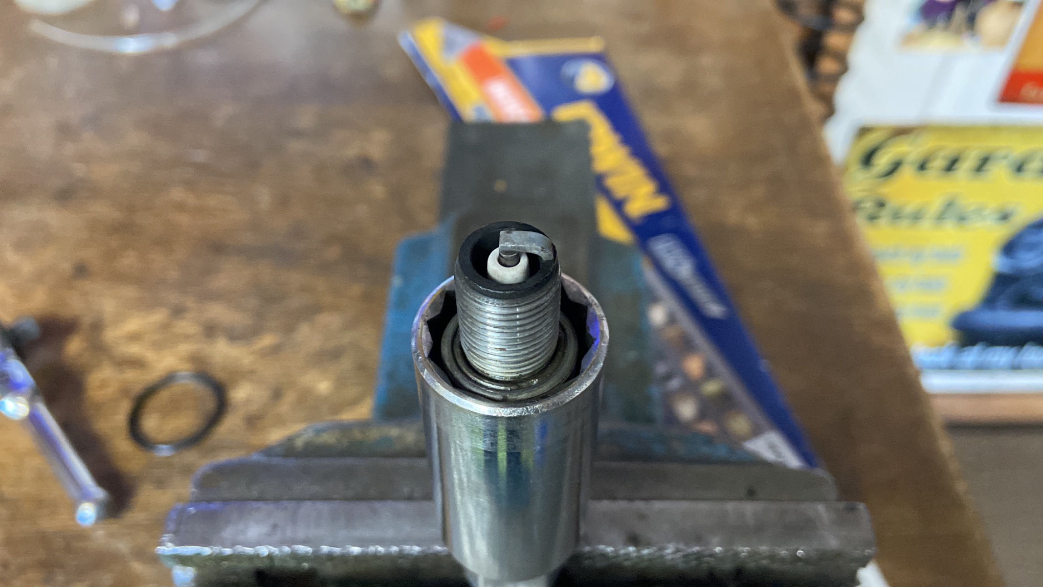

Thats better lol

Re: 1 Sooty Plug
19 Mar 2025 06:11
#910238
Looks as clean as the Health Department, ha.

Well what can I say; just lowering fuel in bowl has gone from mega sooty to this, I’m sure I can make any small adjustments through the air screw now.
Shes still a bugger warming up from cold and needs choke to ride her which as mentioned isn’t ideal as she goes berserk on revs ?

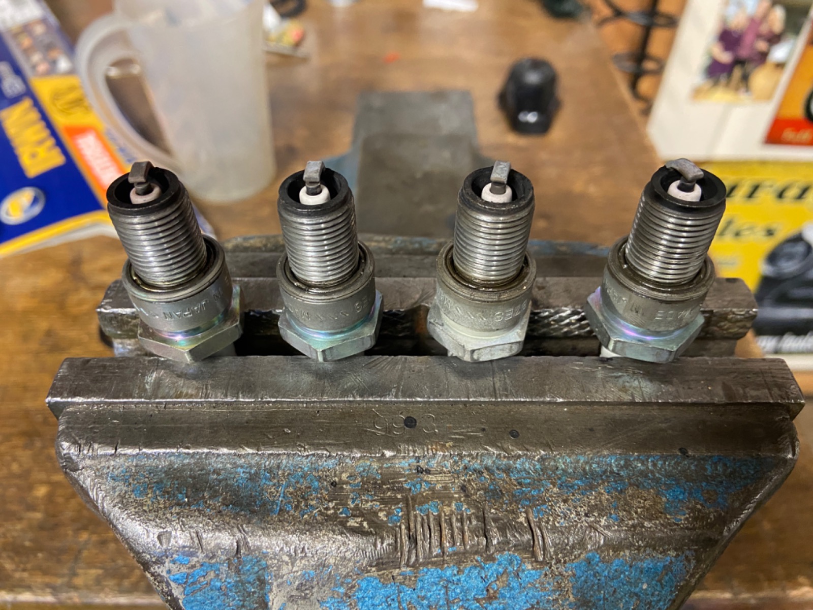

If it was an air leak I’d be experiencing a lean mixture not rich.
Anyway below is tonight’s plugs after a 60-70 run home from my local bike meet, airscrews 1-1/2 turns out.
If I could resolve the startup issues I would be happy….inlet manifolds are perfect same as air box rubbers.
