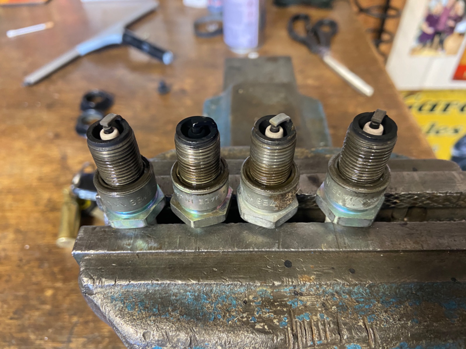

I’ve pulled the carbs 5 times now and checked every orifice of number 2 carb without finding any problems. I swapped the choke plunger over just to rule that out. She runs fantastic once past 1/4 throttle and off the pilot circuit but misses and cuts out at times going from throttle down to low speed, struggles to pull away without giving her loads of gas which isn’t ideal.
just running out of ideas and things to check as mentioned she’s pulls like a train on throttle.
Offending plug shown below.

No1 lean.
No2 weak spark/rich
No3 lean.
No4 OK.
First you need to determine if it's electrical or carburation.
Swop ht caps/leads 2 & 3 over with each other and see if the symptoms moves with the lead.
If it does check you only have max 5 ohms resistance in the line. Cut the ht lead back until you get clean core for ht cap to screw onto. Ensure your not using resistor plugs and caps. Only one or the other max or neither.

Could it be a bad spark plug?

Sorry should have said…,
New coils, leads, caps plugs
I’ve swapped HT leads between 2 & 3
Later model electronic ignition fitted
Stock airbox & exhaust
Looking online they suggest too high float level can cause rich running and too low lean, I’ll check number 2 today and see where it falls 👍

Low bowl fuel height will cause a weak mixture and high level will cause a rich mixture, however as you'd said you've had the carbs off numerous times, naively, I'd assumed that you had previously set the bowl fuel heights and bench synced the vacuums as per the factory service manual.
Don't assume that components that are new are good quality, operationally perfect and are all are performing within spec. Especially spark plugs that are ordered from the Internet. There are so many fakes, especially ngk plugs, that only sourcing from reputable dealer would give me any confidence.

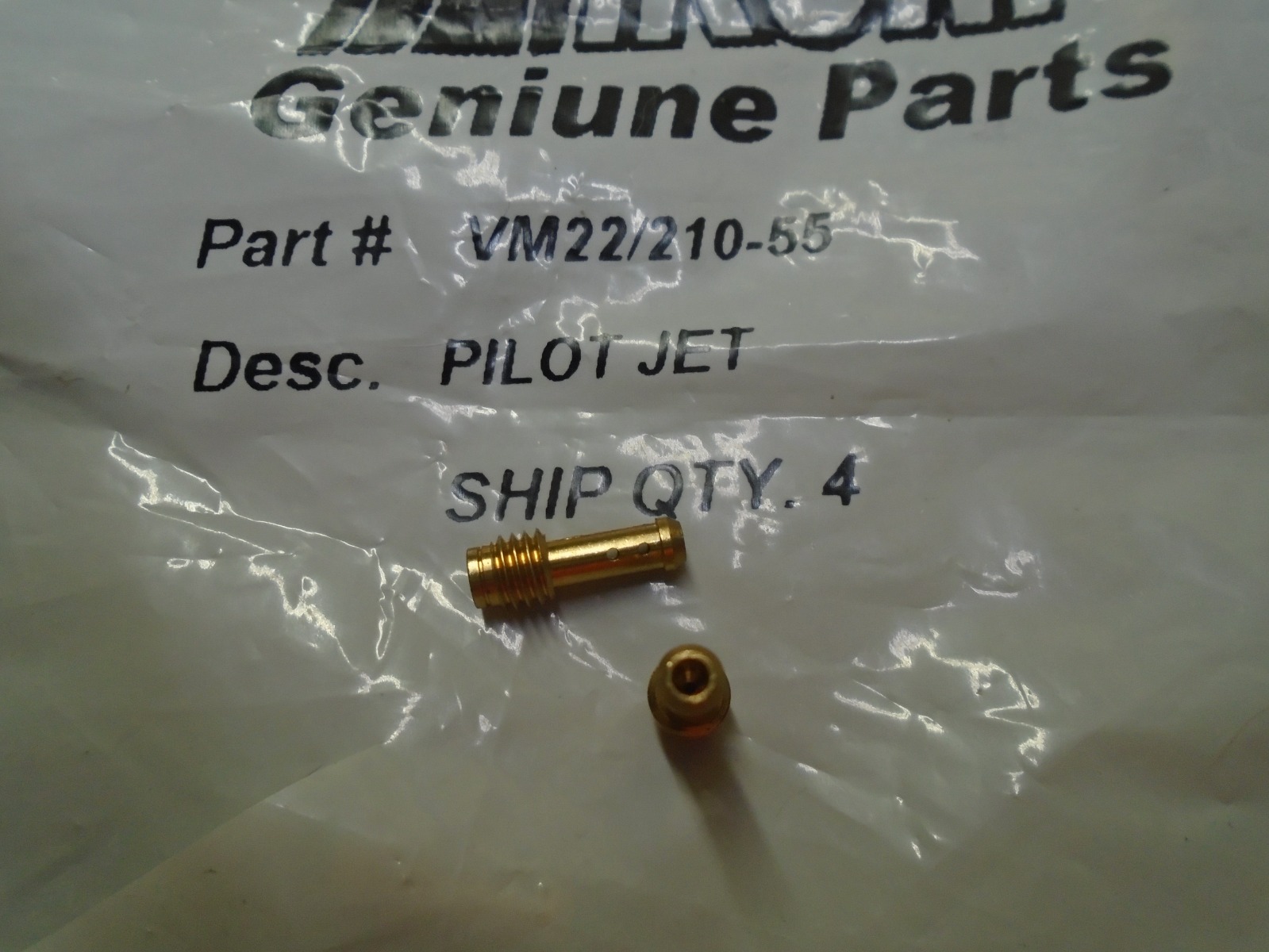

OK, thanks for the info. Just FYI, those carbs are set-up for a functional "pumper/accel" system, lacking it, you'll never have proper off throttle response. Remember somewhere you'd mentioned a "#17" pilot jet? Mikuni didn't make a 17, only a 17.5. And they differ from the pedestrian 17.5's used on other VM carbs. They are 92064-1018 Kawasaki part number but..really a VM22/210-15 Mikuni bit. These are the "bleed" type, meaning holes in collar portion. The other KZ pilots are N151.067 Non bleed and BS30/96 Bleed. Have to remember Kawasaki NEVER made carbs, Mikuni did for these models.
Where did You purchase Your parts from?
