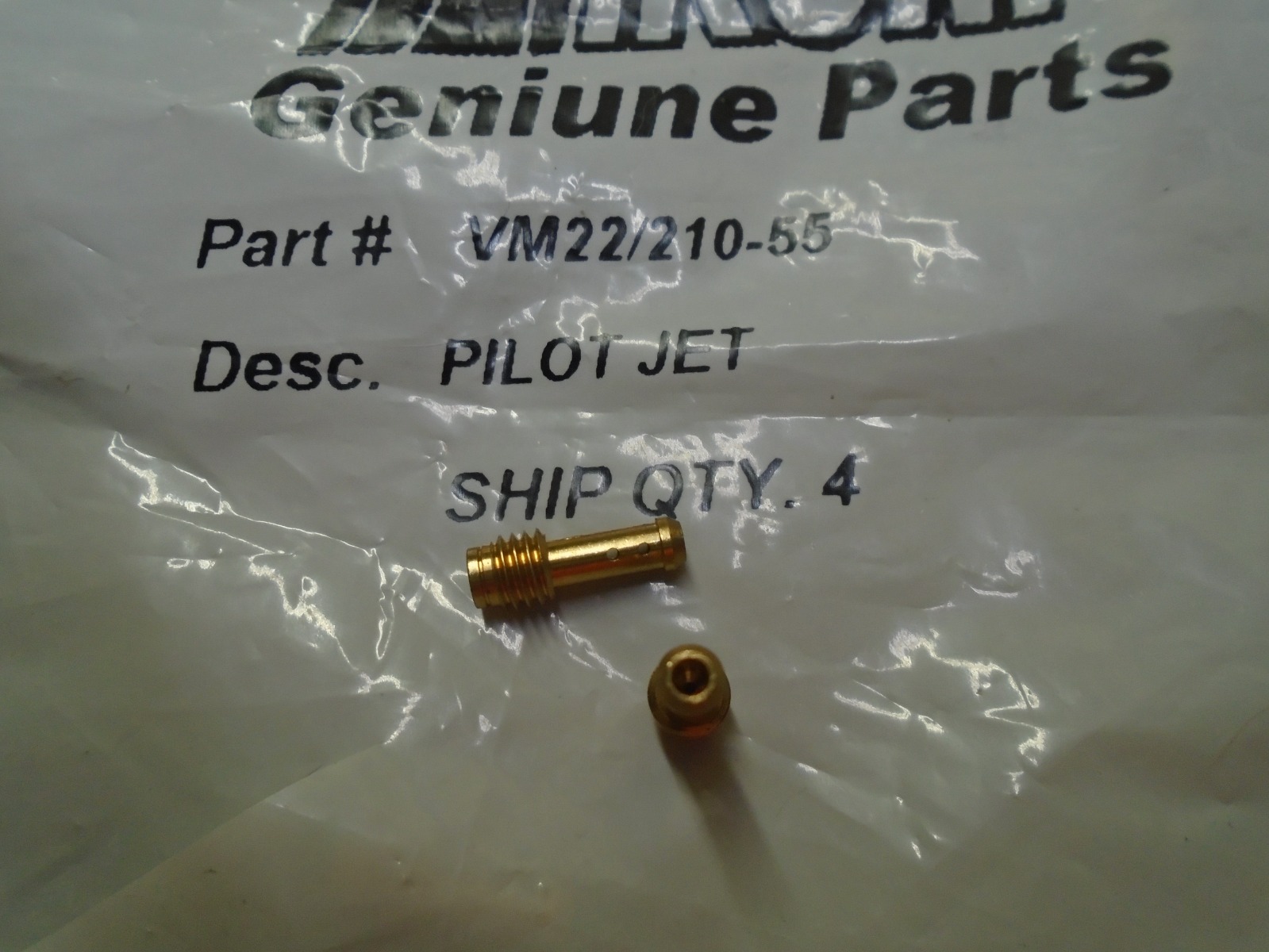

I did post this on my other topic but nobody followed up on it so I thought I’d try a new post.
I’ve pulled the carbs 5 times now and checked every orifice of number 2 carb without finding any problems. I swapped the choke plunger over just to rule that out. She runs fantastic once past 1/4 throttle and off the pilot circuit but misses and cuts out at times going from throttle down to low speed, struggles to pull away without giving her loads of gas which isn’t ideal.
just running out of ideas and things to check as mentioned she’s pulls like a train on throttle.
Offending plug shown below.

Without looking back, which version of these carbs do You have? Air screw, fuel screw or the pumper version? You'd from memory, something about a missing oring? Which one, emulsion/jet holder or air screw/fuel screw ones?

OK, thanks for the info. Just FYI, those carbs are set-up for a functional "pumper/accel" system, lacking it, you'll never have proper off throttle response. Remember somewhere you'd mentioned a "#17" pilot jet? Mikuni didn't make a 17, only a 17.5. And they differ from the pedestrian 17.5's used on other VM carbs. They are 92064-1018 Kawasaki part number but..really a VM22/210-15 Mikuni bit. These are the "bleed" type, meaning holes in collar portion. The other KZ pilots are N151.067 Non bleed and BS30/96 Bleed. Have to remember Kawasaki NEVER made carbs, Mikuni did for these models.
Where did You purchase Your parts from?
