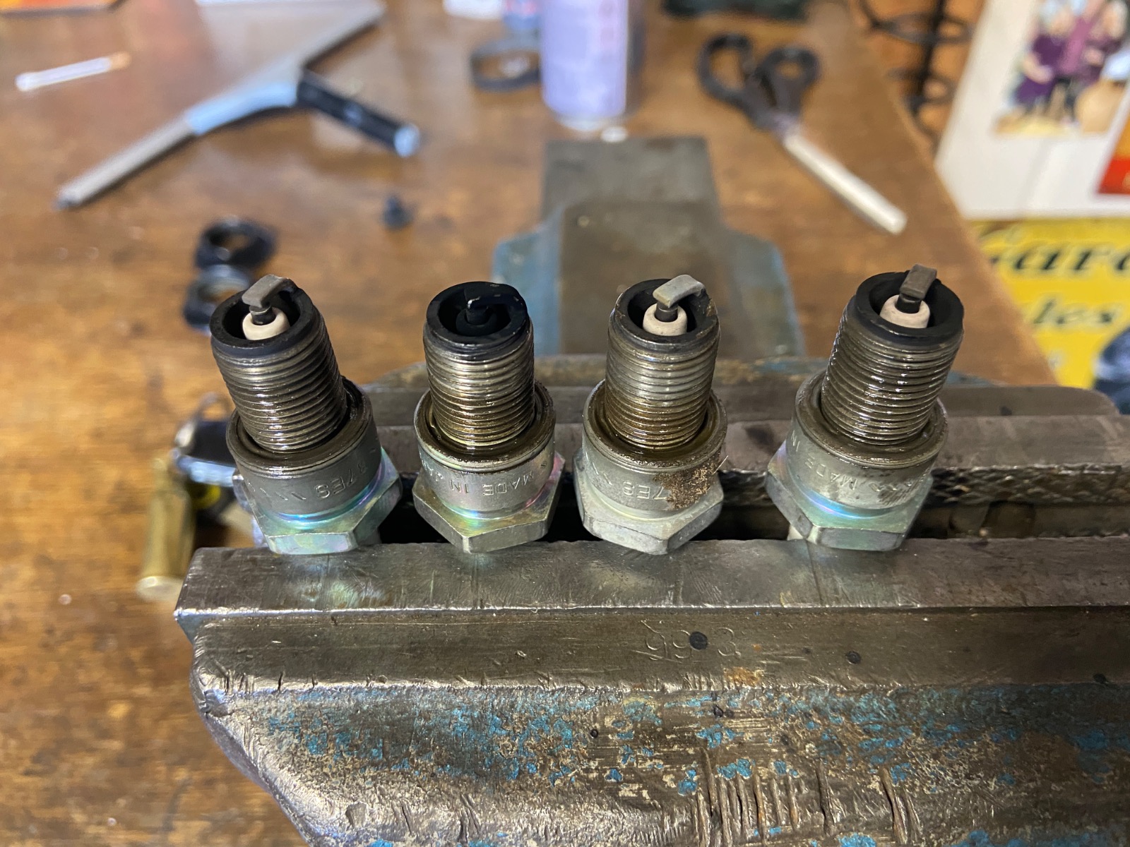

In the midlands 👍 picture was taken whilst pulling the carbs so all testing is stock setup apart the the slightly larger pilot jets 👍 wasn’t running her.
I’ll try tomorrow morning with the advised settings and report back, it’s no biggie to pull the carbs and swap the pilots back to the 15’s 👍

Don't forget to fit new plugs before trying. NGK plugs hate to be flooded and often cleaning them isn't enough.

Plugs are perfect Warren 👍

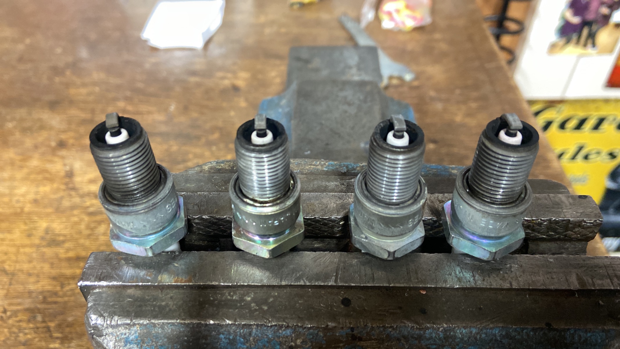

Update popped out and she is still missing at low rpm so pulled the carbs and fitted the stock pilot jets, refitted the carbs then realised 1 O ring had dropped out…. Doh
Pulled again and replaced but now she’s running crap on number 2 !!!
Swapped HT leads with number 3 and new plug and still the same. Cannot think of what else to do ?
