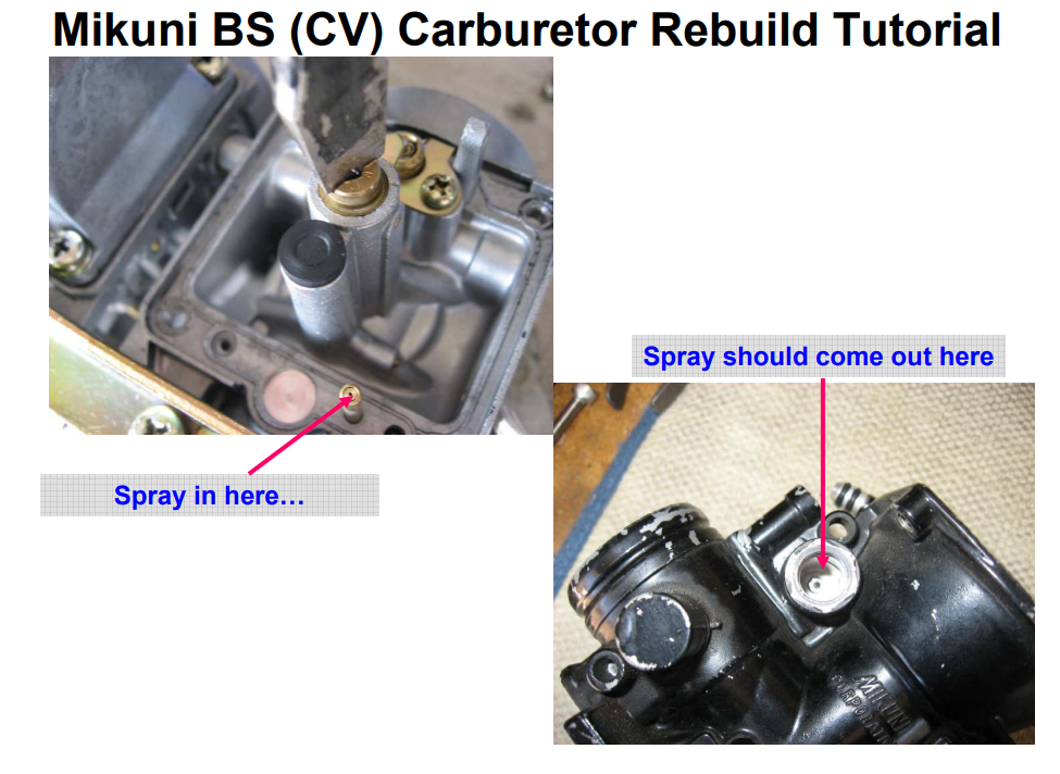

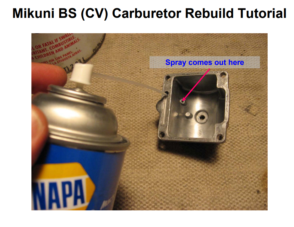

Choke pickup tube, which draws fuel from the float valve and transports it to choke plunger cavity could be plugged up.
And/or, the passage in the float bowl, into which the choke pickup tube resides, could be plugged.
Both of these passage blocks are quite common.

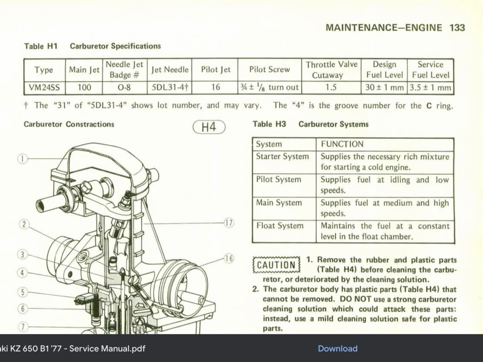

3/4 out is correct for Fuel screws, under the bowl cylinder side of the slide. Part 6 in your diagram.
1 3/8 out is correct for Airscrews on the carb side airbox inlet side of the slide.
No16 on your pic is an airscrew or a plug not a fuel screw.
VM carbs came with either fuel screws, air screws or both. Which do you have?

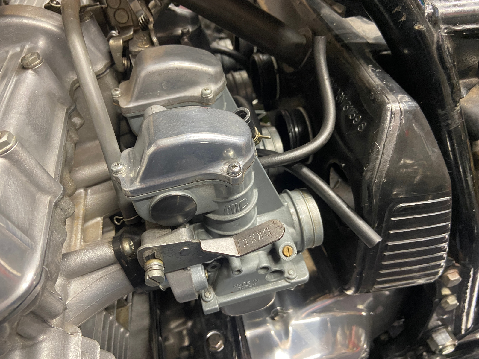

You have pilot airscrew carbs. Those should be set at 1 & 3/8 out from lightly seated. Then once the engine is warm colour tuned for best mixture.
"IF" you have those set at 3/8 out then you have a rich pilot mixture. Add choke to that and it's probably too rich to fire giving the impression you choke isn't working.
Additionally you have the vac tap pipe open. This must be plugged unless it's connected to the fuel tap or it'll just draw air into carb 2 and no fuel will be drawn through the pilot circuit as there will be no vacuum in the carb throat.
Set them to 1 3/8 out.
With a cold engine use full choke, absolutely NO throttle input, hit the start button and it should fire and rev high at about 3.5k. Feather the choke closed until it's running at about 1.8 - 2k rpm. After about 30 seconds you should be able to shut the choke completely.

Vacuum pipe was only open as tank was off, I know what you mean about running with it open; number 2 just doesn’t work lol.
