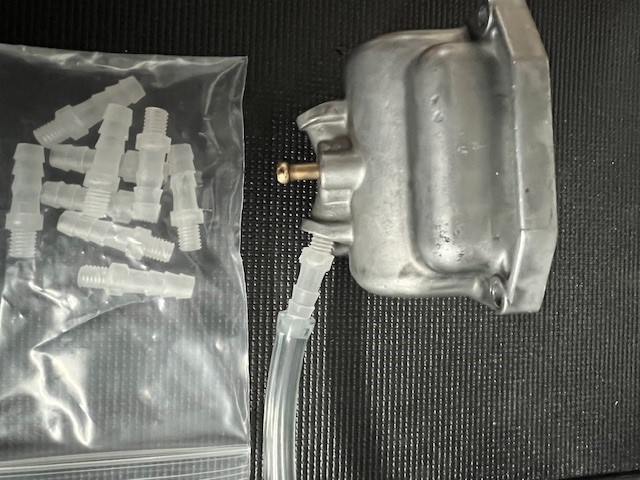

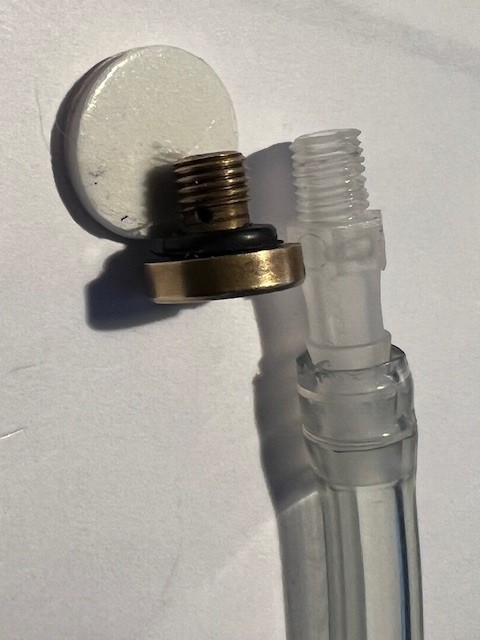

I received from Amazon 10 x plastic 6mm Hose Barb M6 External Threadfor 15$ CDN.
They are not .75 mm tread but I was able to fit them without damaging the bowl treads.
Please dont give me sxxt for the bowl damage....blame the previous owner or his mechanic
By the way, I would like to replace them but could'nt find them anywhere.

Plastic is not supposed to damage the thread I guess!! I will try with rubber plug screw in it

A follow up with the plastic bart hose, after inserting them once they become with the same thread as the drainage screw and easy to reuse them...@ $1.50 each
