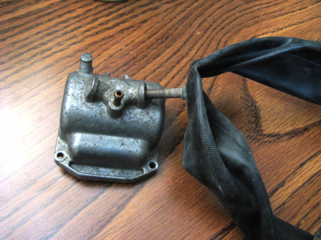

I found that the thread is the same size as used in Presta bicycle tube valves.
Show is a mountain bike inner tube valve screwed into a VM24 float bowl. Cut and grind the rubber off, then you can easily unscrew the sealing guts and discard them, then shove a clear hose over the thread.
They throw old tubes out at bicycle shops, they don't patch them. You can usually find them in the trash outside bicycle shops or just go in and ask them if you can take one from the garbage
You have to specify "Presta" valve tube.

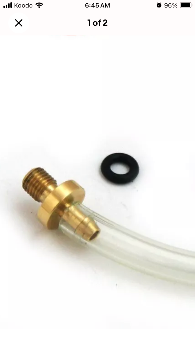

Yup ! They are M6 .75 mm ( hard to find) Amazon has M6 but are coarse tread or non metric and wont fit my Mikuni 26 !
I was lucky to find a pencil tip that work, but I want to check all 4 carbs at ounce.
So...I'm waiting for Amazon to get a set of plastic M6 ?? At least, I wont damage the treads.

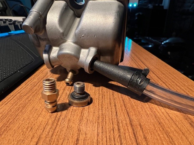

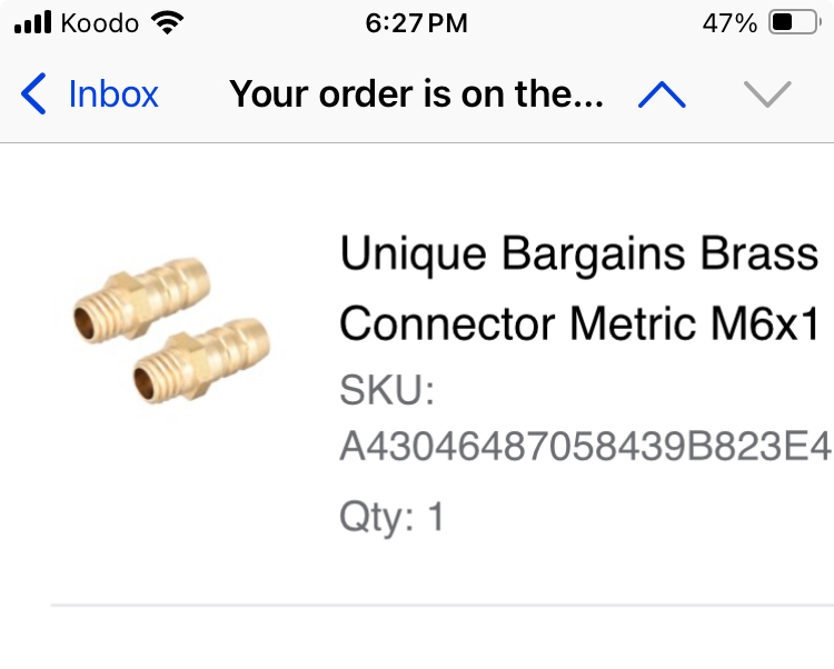

29 Nov 2024 03:22The thread for the drain screw is 6mm x 0.75mm fine thread.
Those in the pic ( 6 x 1 ) are 1mm pitch so are too coarse and won't fit.
