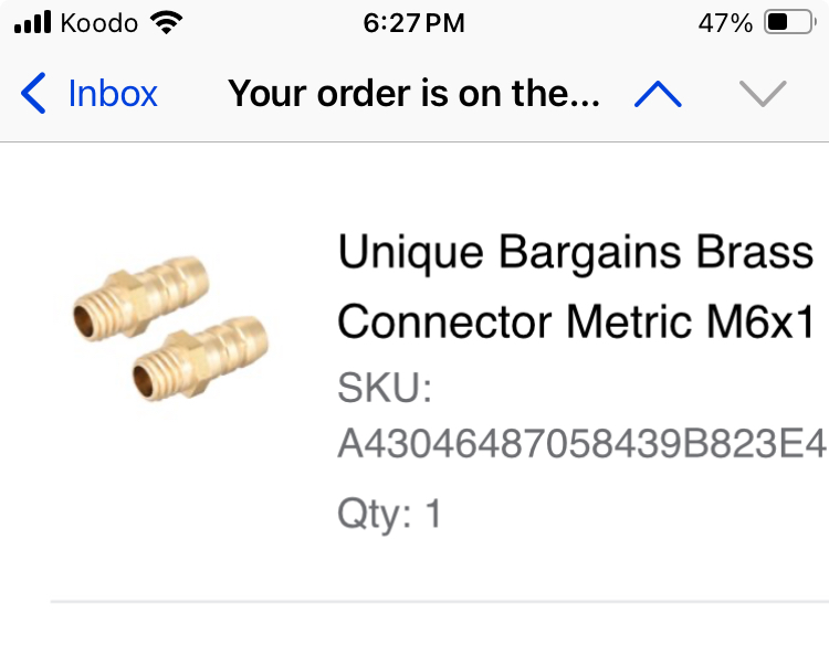

Yup ! They are M6 .75 mm ( hard to find) Amazon has M6 but are coarse tread or non metric and wont fit my Mikuni 26 !
I was lucky to find a pencil tip that work, but I want to check all 4 carbs at ounce.
So...I'm waiting for Amazon to get a set of plastic M6 ?? At least, I wont damage the treads.

Sorry to hear that your amazon m6 haven’t fit. I don’t have receive it yet!! I hope they will fit !!

29 Nov 2024 03:22The thread for the drain screw is 6mm x 0.75mm fine thread.
Those in the pic ( 6 x 1 ) are 1mm pitch so are too coarse and won't fit.
