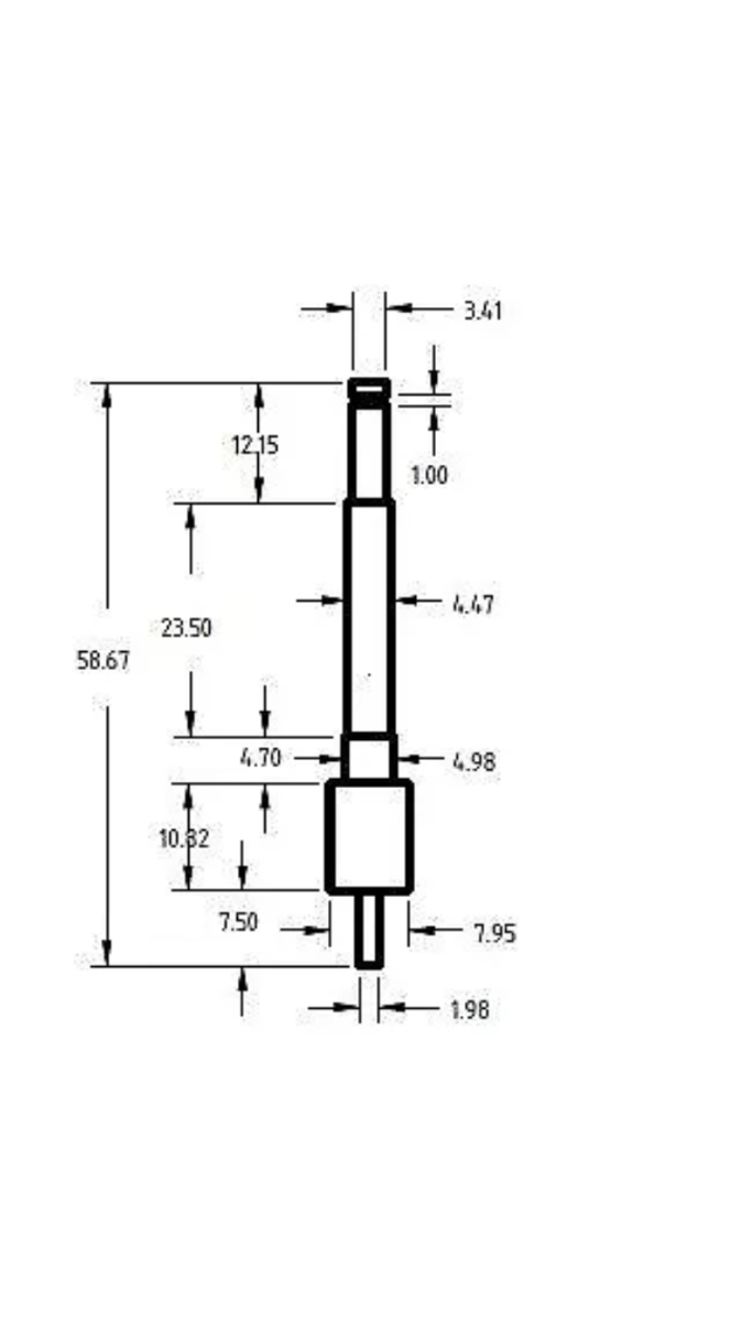

26 Oct 2024 07:03 - 26 Oct 2024 07:05That drawing used to be on the Niche website but has been removed fairly recently. We've never bought from Niche via fleaBay. We've always bought direct from the Niche site.
www.nichecycle.com/mikuni/parts-by-categ...unger-by-mikuni.html
We used info from that drawing (same as above) to confirm, within the accuracy of a quality digital caliper, that they are the same dimensions as the OEM Z1 plungers. Only discernible difference we see is, the shafts are raw brass as opposed to the grey (plated?) OEM plungers of 50 yrs. ago.
After testing a set of four in an a rack of early Z1-A carbs (17mm drain plugs), we bought a set of 24 of those plungers from Niche to update all our Z1's . The plungers depicted in the drawing from Niche do fit & work perfectly in the VM28SS Mikuni Z1 (including ribless), early Z1-A (17mm drain) and late Z1-A carbs (w/ drain screws) we've installed them in.
We've not installed them yet in our Z1-B carbs, but we have no reason to believe they won't work, as they're essentially identical to the late Z1-A carbs in that respect. We'll be installing the Niche plungers in our Z1-B's this winter during prep for Ridin' in 2025, for their 50th birthdays.
The ~50 yr. old seals in our OEM Z1 plungers we've taken out of service so far were compressed a little where they contact the seat, but no radial cracks were observed under high magnification in any of them. We're keeping the old sets of OEM plungers on the shelf just 'cause.
We've never researched the seal material on those from Niche. We'd have to defer to ZED1015 on that.
We've begun to use the choke lever to raise the plungers off the seats a little when parking the bikes, to help avoid seal compression from long-term pressure on the plunger seals from the springs.
All that being said, we've run the plungers from Niche for a few years now on four of our Z1's with no problems. Too, we're of an age that if the seal material degrades in say, 10 ~ 20 yrs., we're very unlikely to care any more.
