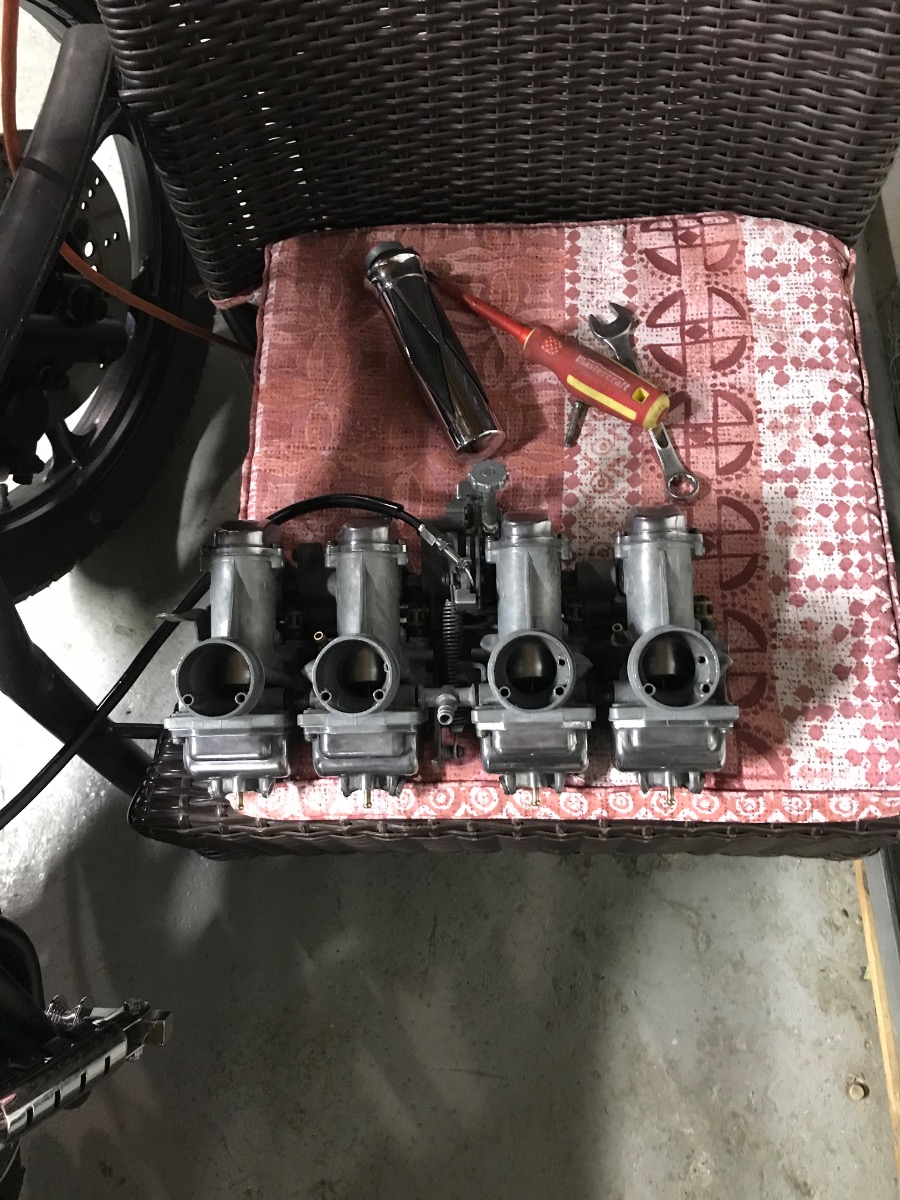

Theres an old picture..I have the air corrector from Zed now!

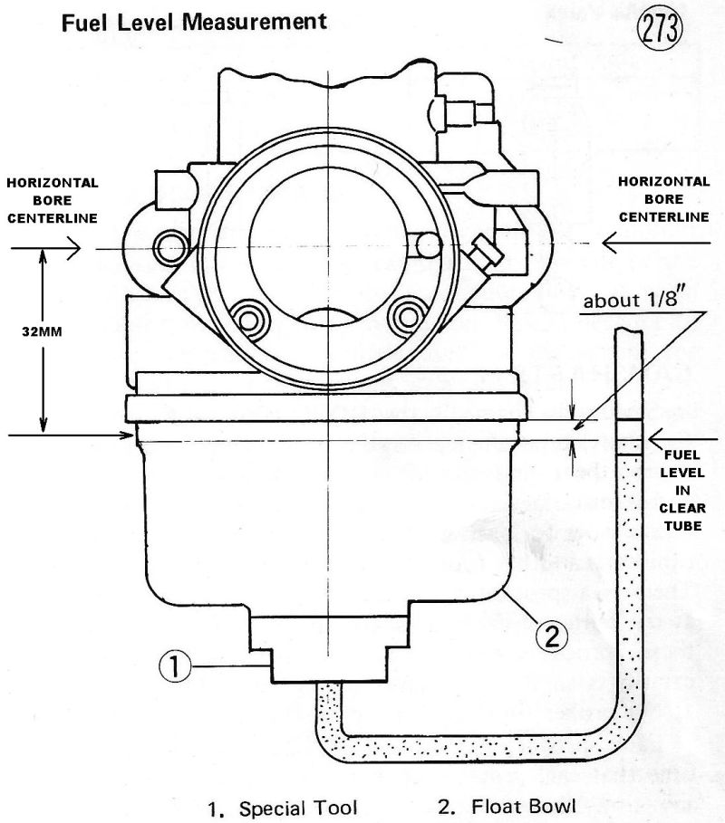

Thats sounds good to me hehe !! But the clear tube method give me some trouble, do I need to put the tube to the front(engine) or the back of the carb and when I unscrew the drain plug, the fuel comes out by the screw instead the bowl drain!!??

The image in many manuals is misleading and the brass tube at the bottom of the float bowl on the SS carbs is just an overflow .
For the vm/ss carbs you need a tube that screws in place of the drain screw .
You need the fuel tap turned off then drain the fuel from the bowl you want to measure before fitting the tube and turning the fuel back on.
The level should be read on the side of the bowl midway between front and back.
This will give an accurate average even with the carb body at a slight angle.
The attached pic shows the screw in tool you can buy but they are easy enough to make if you have the tools and materials.
