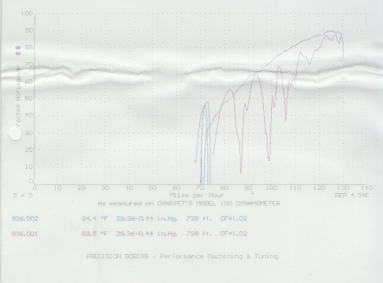

Yes the dyno is not the cheapest place to go to do tuning. I do all my tuning on farm country roads with next to zero traffic. I have been on the dyno several times to check HP, here is my 831cc 650 engine 10 years ago before guy had AFR/RPM showing, just shy of 90 HP.
I plan to check my 1200cc engine on a dyno this summer once its broken in. I also have a portable AFR gauge setup now that I can also use to get closer on jetting.
